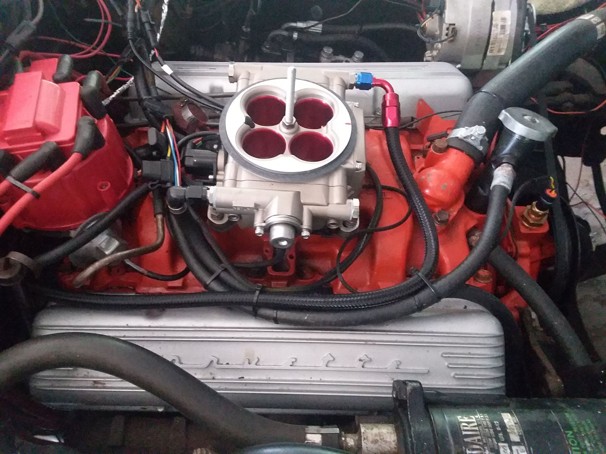

I'm running small cap HEI tack drive distributor on '66 W/383. MSD Blaster coil & MSD 8.5 MM wires -- Sniper efi.
Thousands of miles & no problems. Also tight but will fit under stock shielding

I agree with Black Magic. I have a small cap tach drive distributor (off Ebay) to fit under the shielding. Their electronics have a bad reputation for failure so I just use the magnetic pickup and wire it to a standard GM ignition module mounted remotely with a big *** heat sink on it.

In my case I needed the separate 'box' for the "trigger" (IIRC) for the electronic fuel injection conversion.
