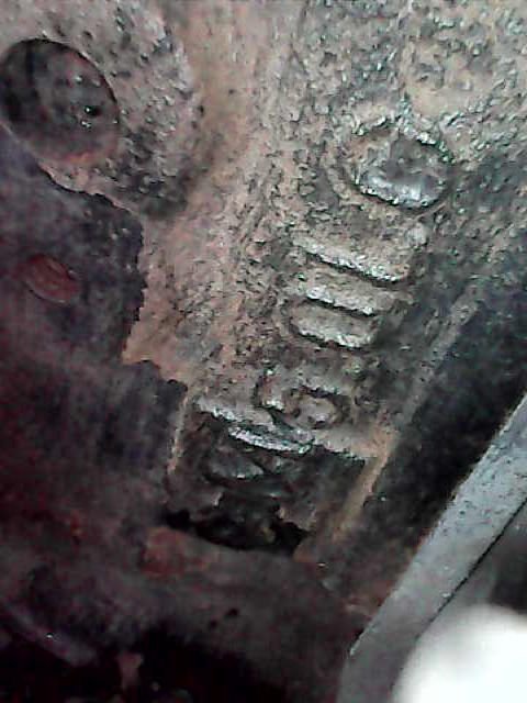

I would like to track down the provenance of the engine that sits in my 1958 CI (VIN J58S107052). I believe it is a 305 LB9 TPI.
The block is stamped GM 5.0L G (this could be a C not G and what does this letter refer to?)
The cast date is A055, which I think is Jan 5 1985
The cast number is 14010201 but the reference material I have lists this number as being a 350 CID, and last built in 1984. This conflicts with the cast date and the engine stamping.
To complicate this a bit further the engine number is V0917CKD (taken from the rego papers and not actually verified on the pad). Based on the suffix, the engine is a 350, and this conflicts with the block engine stamp (which is 5.0 L not 5.7 L)
Help?

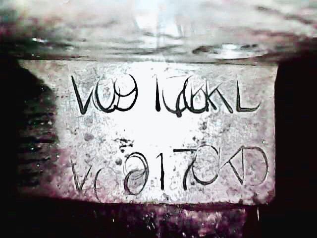

The casting number of 14010201 makes this a 1982-1985 305 small block.
The pad stamp of V0917CKD translates as follows:
V = Flint engine plant
09 = September engine assembly month
17 = 17th day for engine assembly
CKD = Unknown at this point
What is stamped on the engine pad?

Thanks emccomas, I’ll have to lift the alternator to get the engine number. Stay posted.

appears the worker responsible for stamping the engine pads had a few beers at lunch…., but the number on the rego is correct V0917CKD

What is a "rego".
This engine pad stamp is homemade. This is not a factory stamp.
I have no idea why someone would do this.
Was this engine rebuild at some point?
CKD engine code was used as follows:
1972-1974 Chevelle, Monte Carlo, Nova, El Camino 4bbl, automatic trans
1977 Corvette 4bbl, auto trans, high altitude (like Denver, etc.)
The CKD code was never used, to the best of my knowledge, with the engine casting number you have indicated.

Motor vehicle registration (rego) and insurance includes the VIN and the engine number in Aust. The rego certificate includes the same number that is stamped onto the pad, which means nothing other than the car is known by this as well as the VIN number.
You have confirmed the problem that the casting number conflicts with the engine suffix. If someone went to the trouble of rebirthing the engine using a new number and in the correct factory format, then you would think they would at least get the suffix in the correct date range to tie back to the the casting number (and date).
The engine was bought separately from the car in the US by the previous owner 15 years ago, who shipped it to Aust for a full restoration and RHD conversion. I had the engine rebuilt locally by a reputable mechanic, and I believe it is designated as a small block LB9 (1985-1992), which at least ties back to the casting date number ending with “5”
Also, what is the letter “C” or perhaps “G” that appears on the casting after GM 5.0 L (“C”) ?

My casting on the bell housing is 5.0LG, but the serial number is V1001CLA (73-77 350 Vette). Not sure which one to believe.

Appears that your engine has been rebuilt at some time if these numbers don’t match. Same as mine.
Not unusual to see that the bell housing and the stamping plate on the top of the engine are from different engines.
No one on the forum answered my original question about the reference to “G” on the bell housing, so i would be interested to know further if you get the answer. Good luck.
