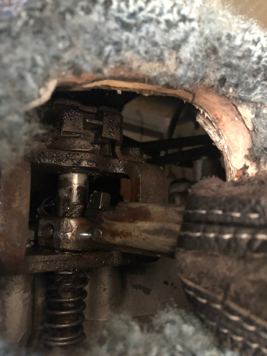

I don’t know what this is but the only pic that matches what I have is the top one. I can find no screws or set screw as shown in the second and third pic and the AIM rfo 385, sht. 2.00 is no help either. From what I see, that bottom pin (photo) must come out. Is that correct? Can it be knocked out from the top, provided I can get something in there?

The written instructions shown are C2.

I thought so, great. So my original question still is, can the spring be fixed or replaced from the top? If so, how?

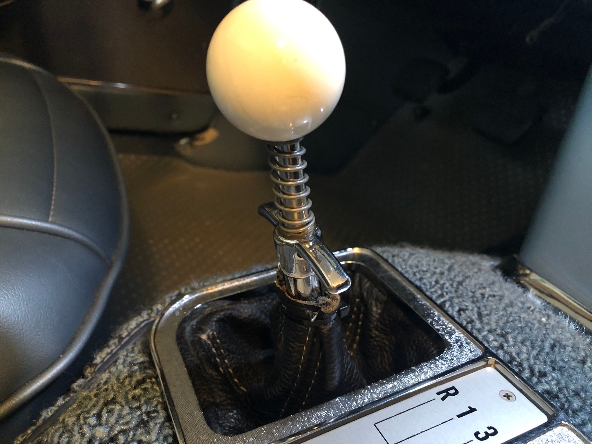

Back when these cars were new, the most popular "Bubba Fix" to this issue was to unscrew the shift ****, drop on a good-sized spring, and put the **** back on. Worked so well, many of us drove 'em that way for years.
Good idea, didn’t think of that. I’ll do that until which time I have to remove the shifter then I’ll fix it proper. I’m convinced that that bottom pin must be removed for disassembly and I don’t think that can be done from the top.
I drove a couple different C1's that were "fixed" this way for many, many years and never even came close to doing that, not even once.
Good to hear, then I’ll try to get a spring like your pic.

Got the spring and it works great. Didn’t experience any pinching, may depend on the type of spring, tension, number of coils, etc. Thanks for the tip!
