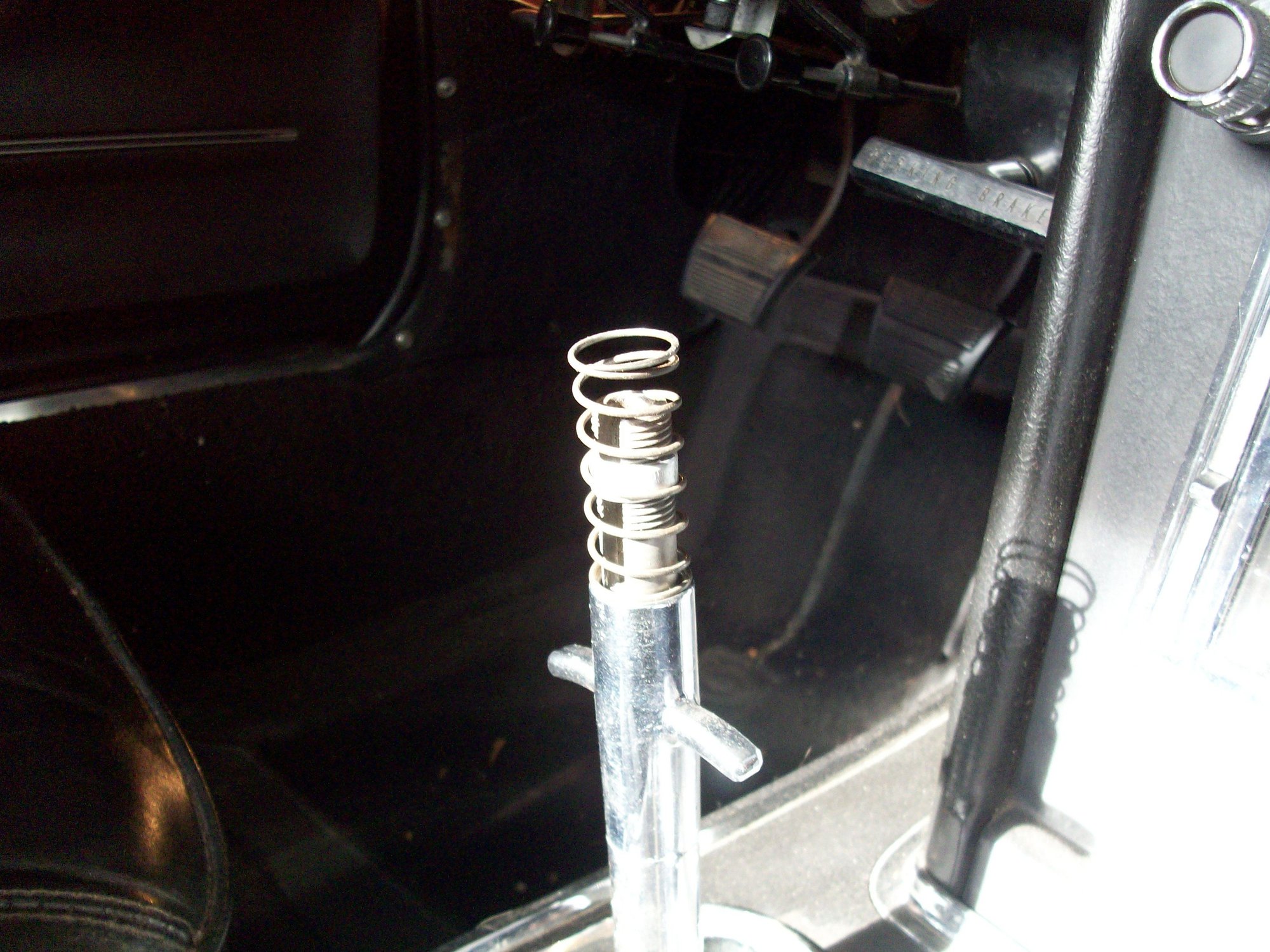

I borrowed the below picture from someone, Thanks to whoever took it.
Anyways, I'm having issues removing the reverse lockout handle (whatever the T handle is called). I got the **** off and the spring off, but the handle is stuck. Any ideas? I know my car won't shift from first to second, so I started to remove everything inside the car to see if I could get to the shifter that way, instead of under the car.
I removed everything but the reverse lockout handle and the rubber boot that covers the tunnel. I will start looking into what's causing the shifting issue later.
Just thought of something - Could the reverse lockout rod be jammed causing the car not shift correctly and causing the reverse lockout handle not to come off?

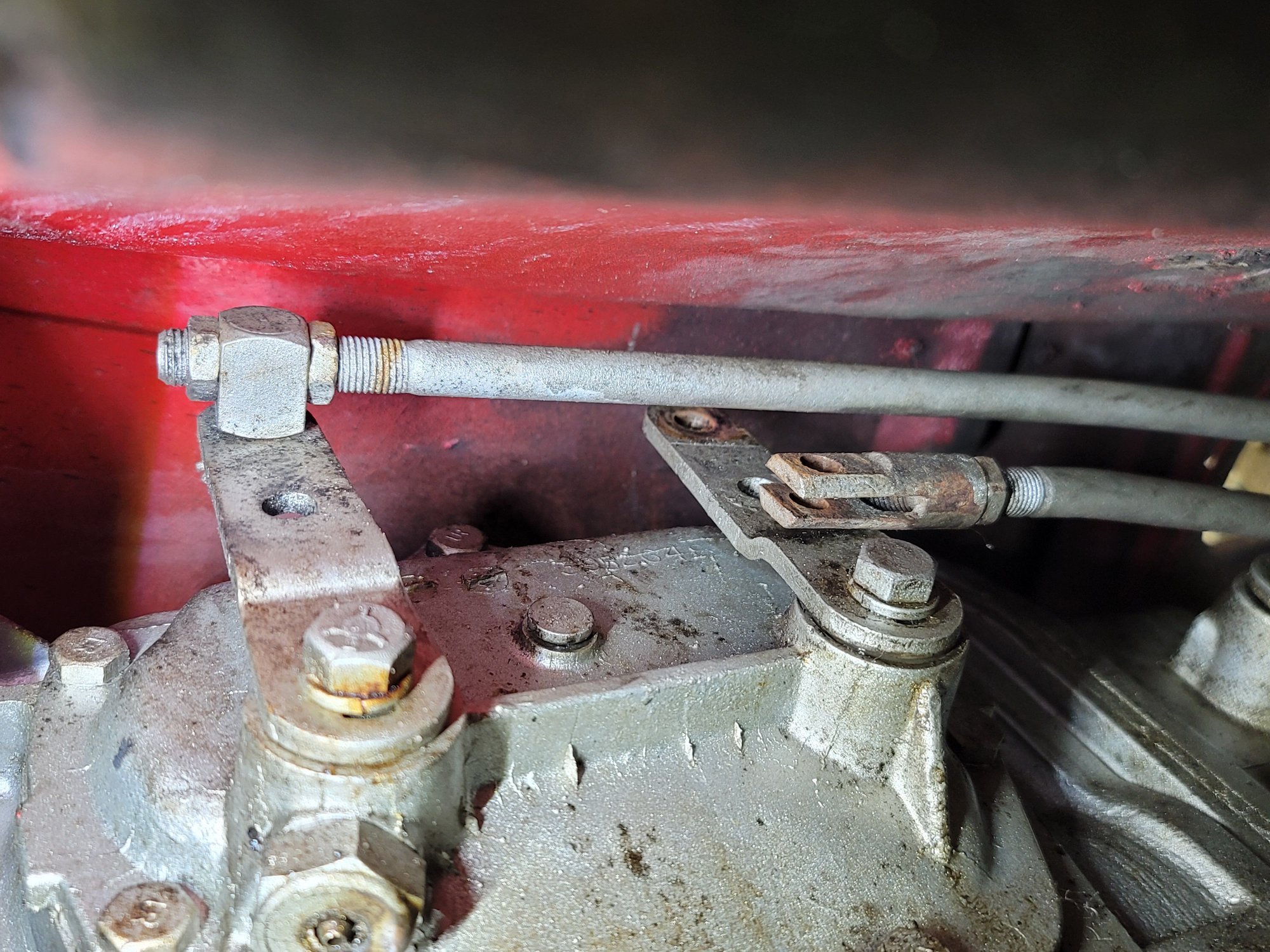

Well, I managed to get the reverse lockout handle off and the reverse lockout rod out. It was the bushing causing the issue. Still could not shift it, almost frozen feeling. I crawled under the car and inserted a drill bit into the lineup hole, don't have the flat opening, and that seemed fine. I was able to hand shift the 3rd and 4th lever with no issues, but I could not budge the 1st and 2nd lever. I removed the clip, pin, and rod but could not shift it by hand at all....pretty stuck feeling. At that point I came inside.
Shifter after removing the bushing
The rod removed from the 1st/2nd lever

Two things I see. The pin holding the combs onto the side plate seems out too far. It has a C clip on the other end holding it.
That side plate is for a later Muncie. Should work, but that switch mount on the base of 3/4 should not be there.
I’d rattle the 3/4 lever to be sure it’s in the detent position, then turn the internals while trying 1/2. Next step gives you a chance to get the correct side plate. Will need to come off to verify shift fork and comb operating correctly.

With both rear wheels off the ground, you can try the output shaft by turning a rear wheel. Input will require a helper with a band wrench on the front crankshaft.
You are also missing a spring clip on the handle pin in your second picture.
