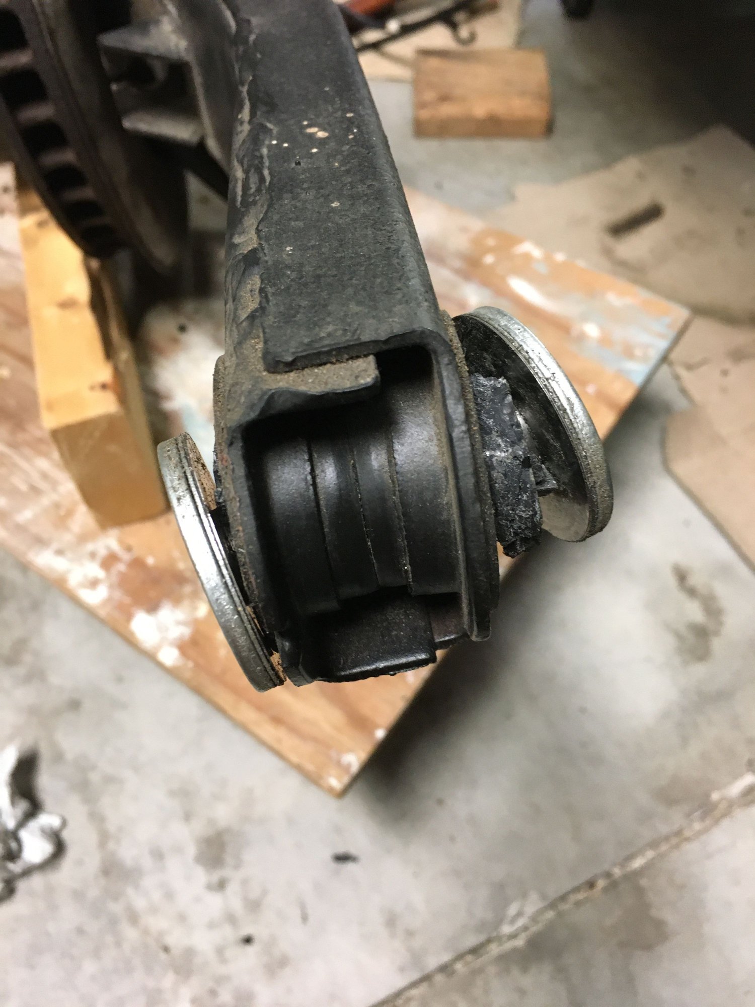

If you rebuild the suspension, many will agree NOT to use polyurethane bushings. Many of us have seen them crumble and turn to dust. Use the OEM style rubber components.

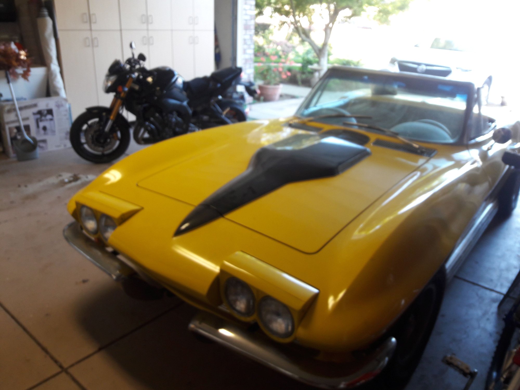

I did research the borgeson p/s unit and think that's the ticket. Also maybe go with disc in front and perfect the rear drums. Ideas about linings?
What m/cyl. to use with that combo? (Stock is single pot)
I've got the manuals and poured over them already. Great stuff!
Unfortunately the 327 is out of a Nova. Doesn't smoke or use oil but does leak a bit. I will pull the motor, and re-seal everything but reluctant to rebuild it. He requests NO cutting, drilling or welding.
Thanks for the suggestion about the poly bushings! That answers That!
I've got about 9 months to do it. You guys are awesome! I'll have to figure out how to attach the only pix of the car I've got.
Did I do it?
Old Sep 3, 2021 | 05:11 PM
Factoid's Avatar
Factoid
Joined: Jul 2018
Posts: 10,588
Likes: 8,409
Yes you did. I like the 65/66 big block hood better than the 67. That is a nice upgrade that gives you any hood clearance you may need.
