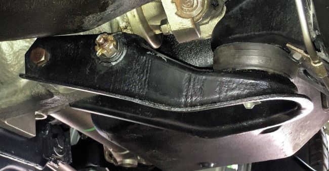

From: Bergen County, NJ
If these bolts are loose, you will hear a clunk when shifting.
It happened to me. After tightening the bolts, no more clunk.
