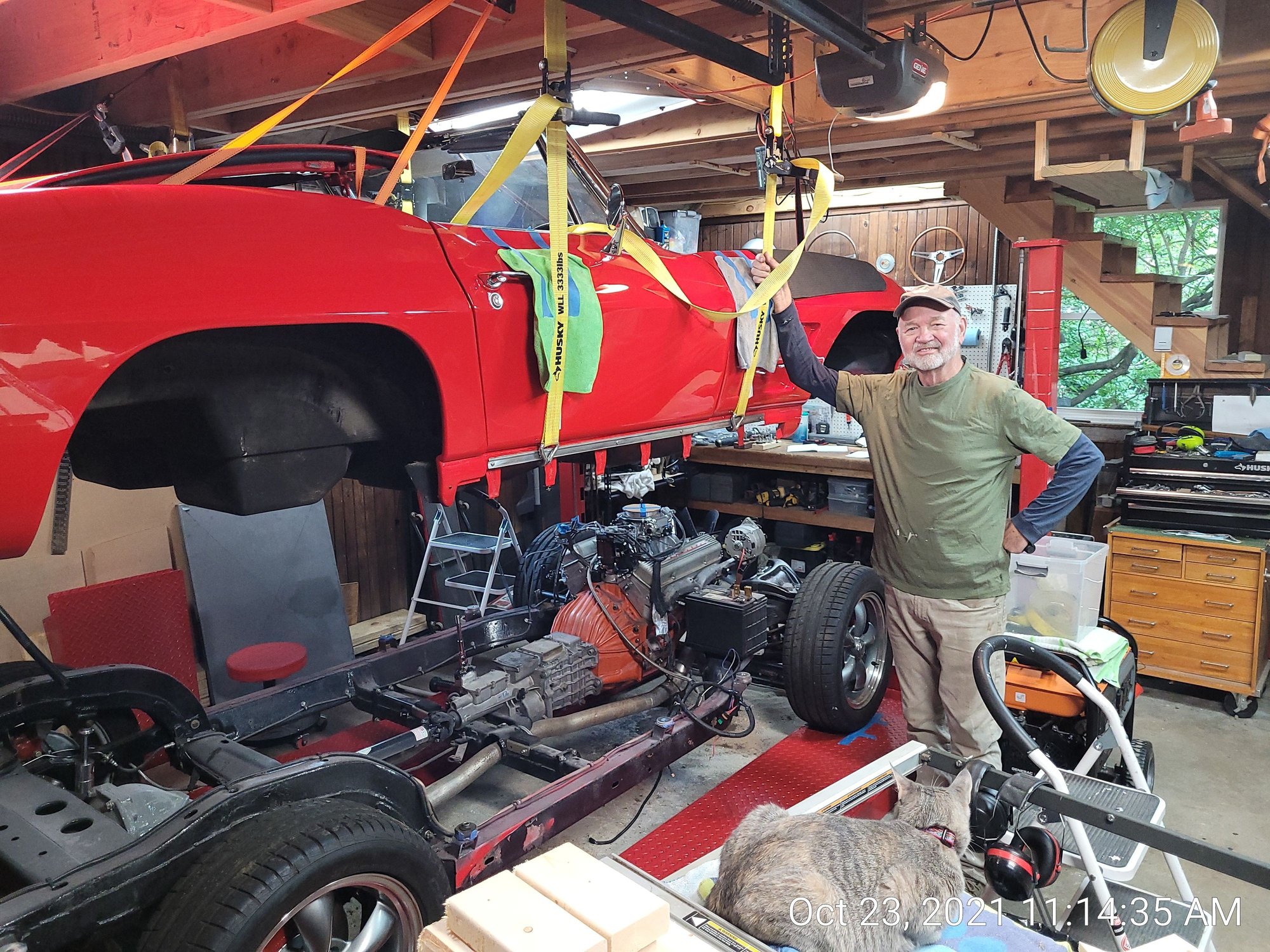

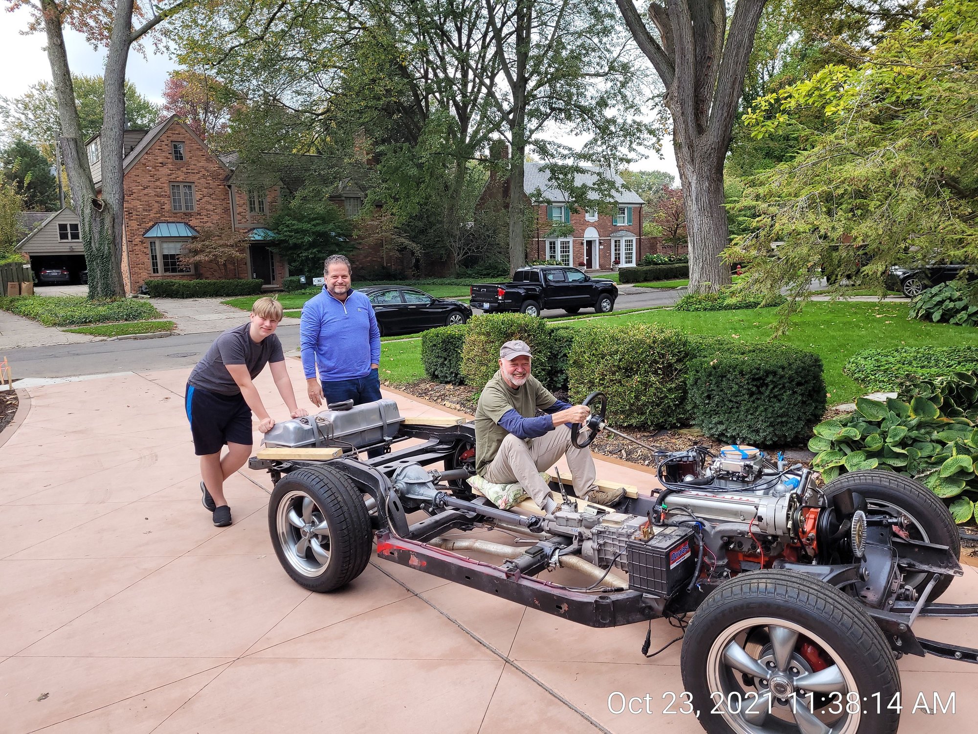

It's been awhile, but I've made some good progress. Have a 430hp LS3 on order, should get it next month. Decided to go DBW, stock intake and exhaust manifolds, mechanical clutch, DeWitt's LS radiator, and Holley mid-mount accessory drive. Ordered a GM engine controller and harness kit from PSI. Since I'm keeping the LS3 all stock, PSI assured me the tune that comes with the ECU will work just fine and not need further tuning. I sure hope so as my goal is to get this engine installed and drive this car hassle free.
My dad came up this weekend and we got the body pulled and old engine removed today. We strapped the body to the garage ceiling and then lowered the lift. Rolled the chassis out and then rolled it in next to the lift. Built a frame to support the body on the lift. Worked really well. The lift gave much better control than the electric winch I used last time to pull the body.
Tomorrow I'll pull the pan and do a cursory inspection. Already have a guy interested in the engine.
My dad just after pulling the body (or more accurately, just after dropping the chassis)
Dad, son, and neighbor helping to roll the chassis off the lift
Body dolly

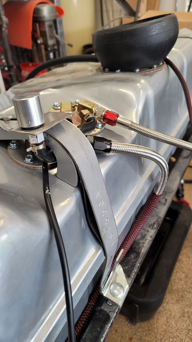

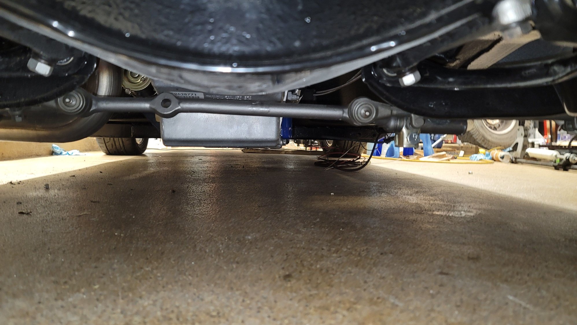

I just went through the same swap in a 64. I will try and highlight a couple items I went through...may take a couple post to remember:
  1. DBW is great but you may have some real estate issues on the fire wall with your emergency brake, where is penetrates the firewall. I went with an electric parking brake and removed the parking brake completely.
  2. Power steering pump / reservoir is very close to the upper control arm. I debated since I did HydroBoost for brakes. I ended up doing a remote reservoir.
  3. The harmonic balancer / pulley is fairly close to the cross member. You'll want to install before installing the engine to the frame. You can always lift the engine a little to get it in after the fact.
  4. Have you put thought into the fuel pump location / tank. Maybe consider this (Link) hydromat from Holley. I replaced my fuel tank for fuel injection baffles but also added this for it's filtration attributes. I did the regulator up in the engine compartment with two lines. HydroMat / Fuel Pump / 10micron filter / injector rail / regulator
  5. Does your 5 speed have the offset shifter?
  6. AC compressor cut out - the compressor are limited to a certain RPM and may need to cut the AC compressor clutch engagement. I used the GM ECU (I have the LS3 533HP) and I was surprised it didn't come with this feature (output signal). They do have a throttle position output signal so I've put a comparator relay circuit in to cut out at a certain throttle position (high throttle means you want more power and high RPMs).
  7. ...(still thinking)
I just put the an air filter on to keep dirt out. Working through all the systems before final paint.
You may want to put a steel oil pan on the engine. This aluminum oil pan may only take a couple speed bumps.
Fuel injection tank with vent mounted
