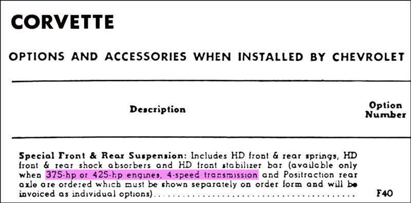

Could you order F40 suspension on a 65 365 HP Corvette?

According to the book "Standard Catalog of Corvette" by John Gunnell, yes.

I thought it was only available on the L84 fuelie cars and the L78 396 cars.

Noland Adams book says 326 F-40 with L-84 and 649 with L-78,

From the 1965 Corvette ordering info:
