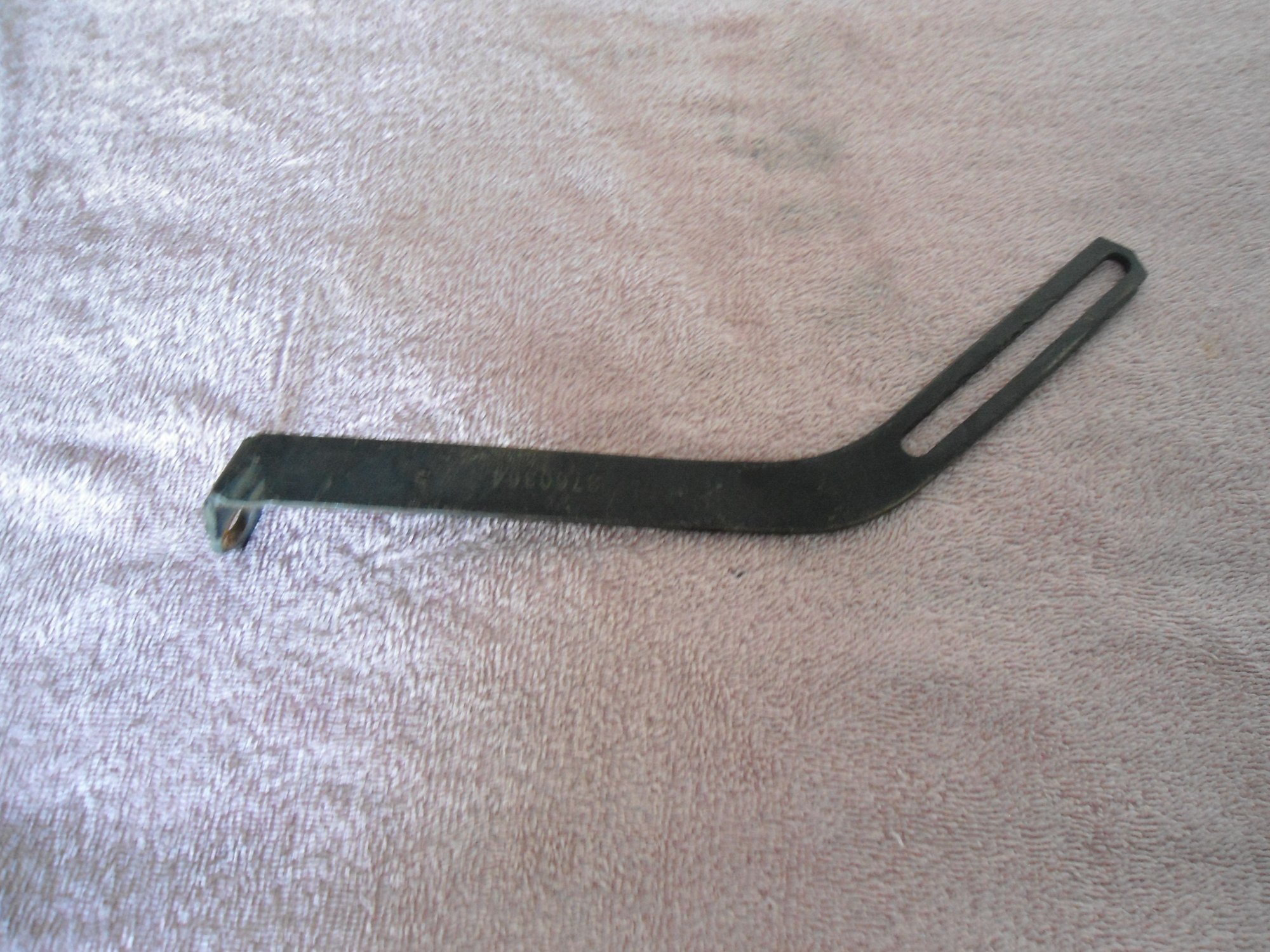

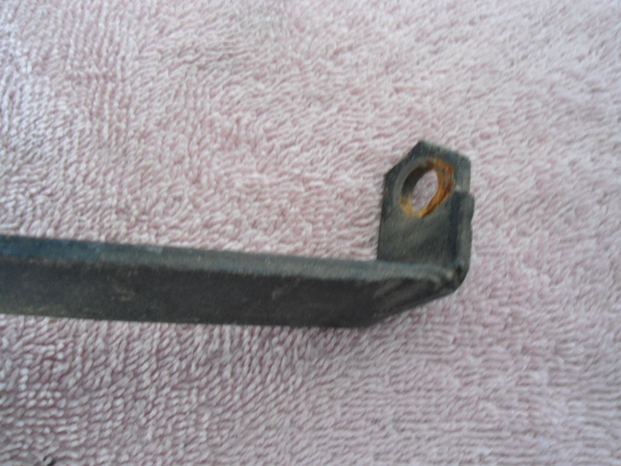

Hi All, I came across a generator brace part number 3760364 with a strange end mount. It is not straight? Can anyone identify it? Thank You!

Its been bent to bolt to the intake.

Shows in the parts book as applying to several cars and Corvettes, 55-62. 14" long, 4 1/2 slot, 5/8 offset.

Thank You for the responses. I will attempt to straighten it!

I am sure the bracket has been bent to be used in a non-stock application. Use heat to soften and rebend the end back to flat or it'll break, actually, it may break anyway, good luck with it.
I had a then new 65 Malibu with the L79 and I had to use double brackets to eliminate breaking the brackets
