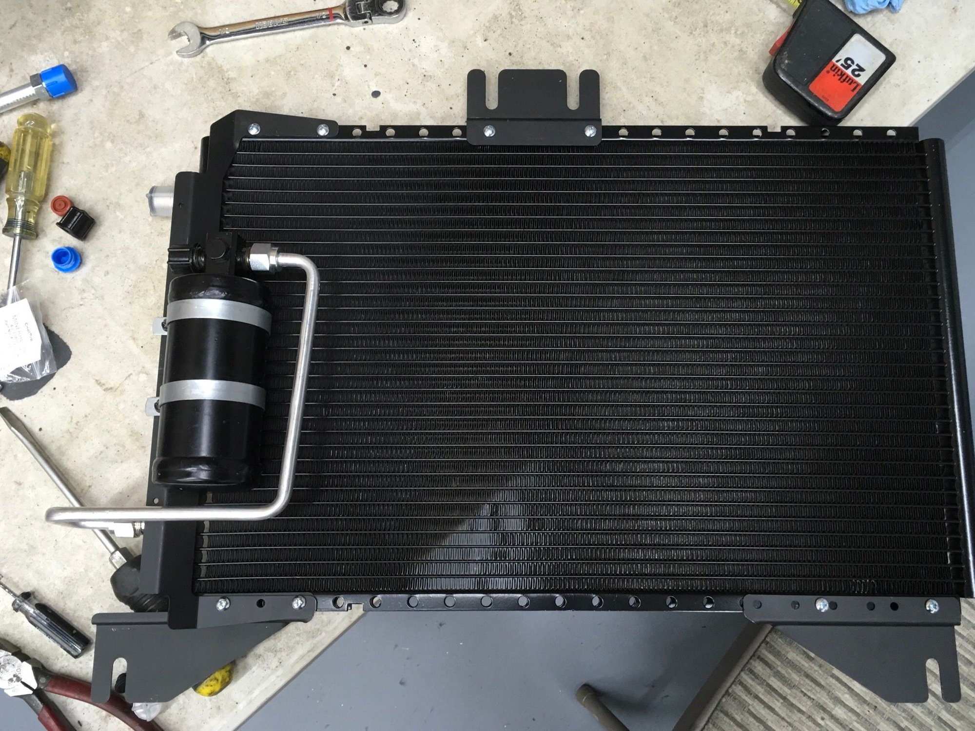

You will need to remove the hood, but installing the condenser was the easiest part of the whole project. My heater core also didn’t leak much.
This is the hard part!
I replaced my dash harness while I was in there.
I also cut and crimped my hoses. Tom figured out how to crimp them in the car, but he has mad skills! I needed the vice.

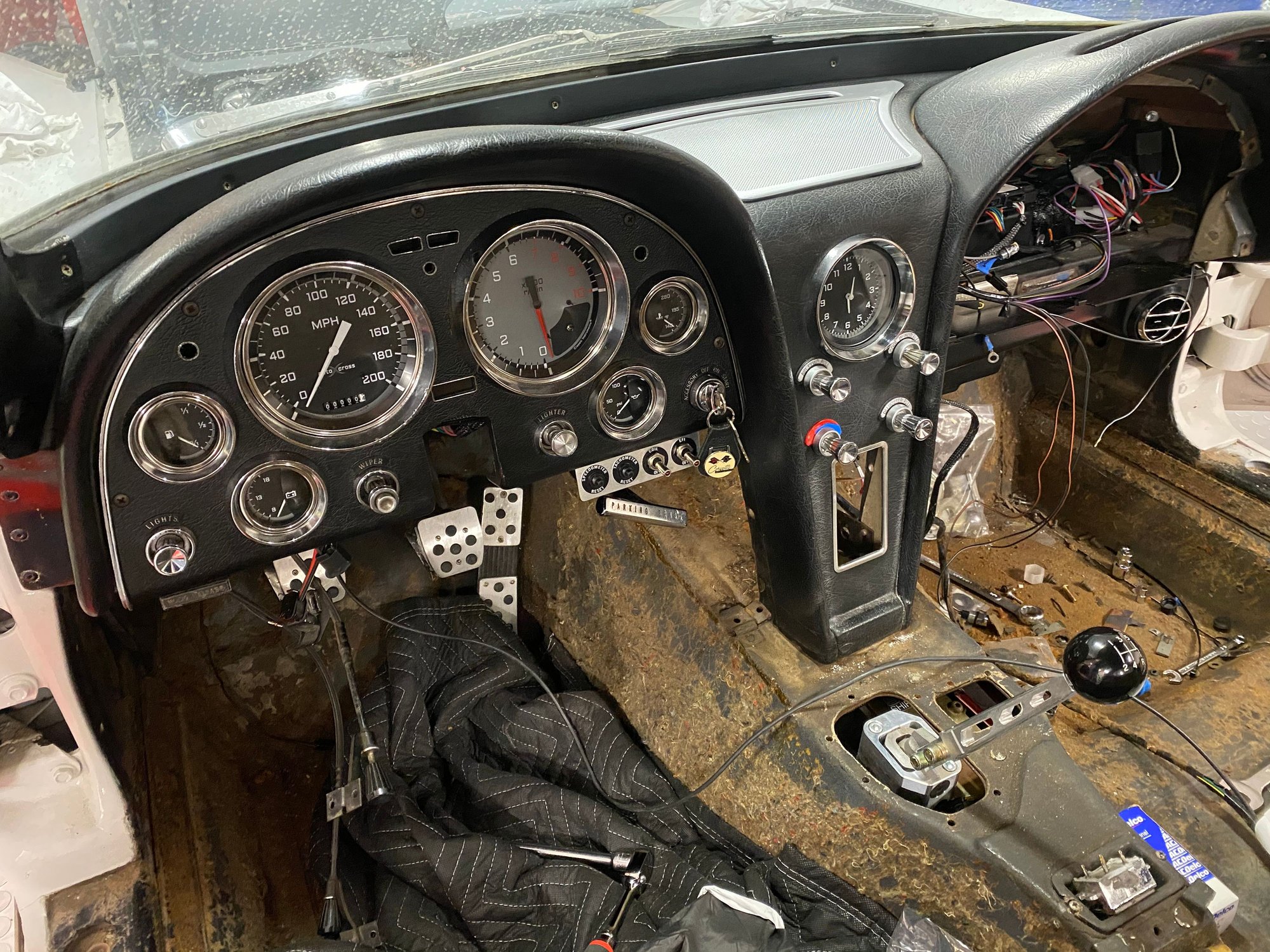

The day started out easy enough, pulled the heater hoses, exp tank, battery and fan motor. The fan motor shroud was loose enough to wiggle but with all the speed nuts off it remained caged by the core supply/return fittings on one side and what turned out to be some king of long riv-nut post that attaches the fender emblem. It extended just far enough inside the engine compartment to trap the flange of the assembly (not that you could see any of this without an inspection mirror). Screwed with it for about an hour and finally, using braille, got a long straight blade screw driver between the flange and the bonding strip and worried the thing out. Now for the inside core/air distribution assembly. I know you all say that installing the VA unit will be a test of ones patience but removing the OE unit ain't no walk in the park. Pull the "Y" fitting and don't forget the speed nut over on the drivers side. Don't be surprised if you back the assembly up against the Z-bar and it's still stuck. It's a nebulous combination of twists, tilts, pulling the carpet down and getting the heater core bracket around the fresh air vent assembly but suddenly it drops out and your done.
So the steering gear box, steering column, dash board, and heater are out. I'll send the gear box out next week to Gary. Tomorrow I'll dissemble and make up a parts list for the steering column, begin the R&R on that. Instrument panel comes apart for gauge repair and modification. The VA unit is not due to arrive until sometime in November.
