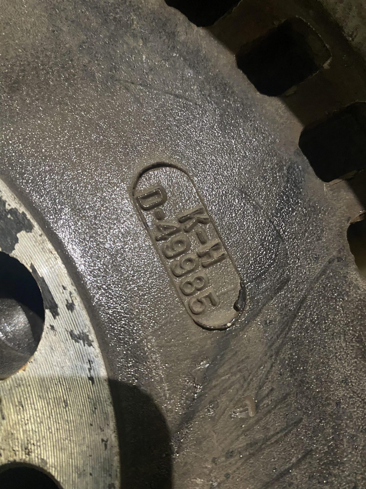

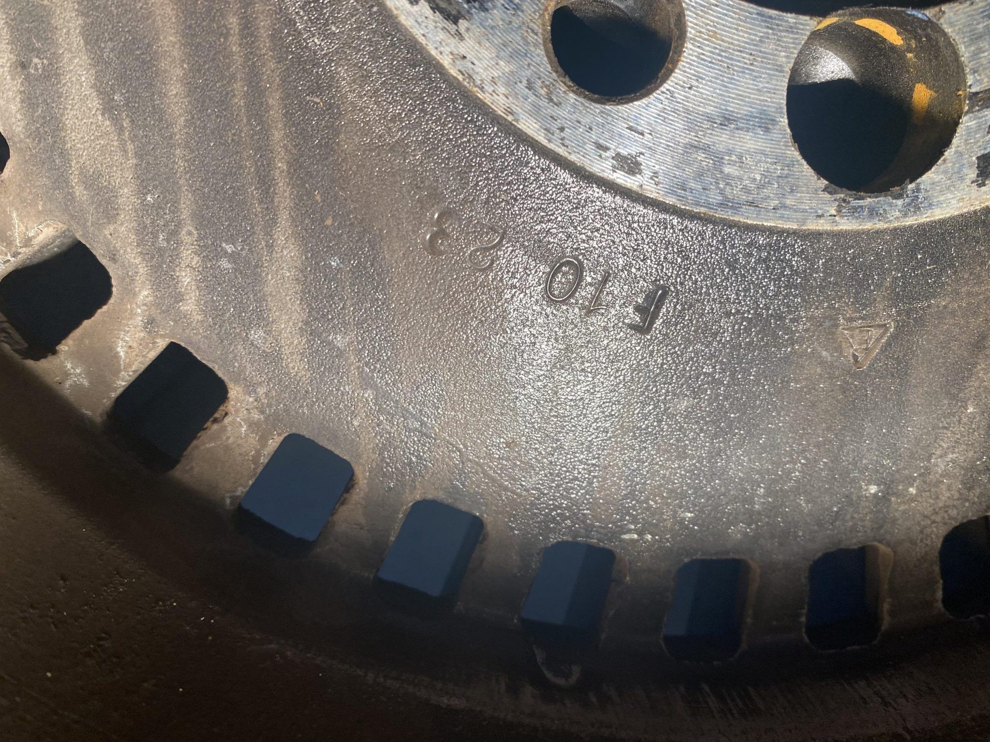

For anyone still interested, here are a few photo's of the inside markings on some original Kelsey-Hayes Knock-Off wheels...
These are all photo's posted by Forum members here over the years that I downloaded to my library. One of the things that I find most valuable about the Forum is the willingness of members here to share photos of their cars and accessories with the rest of us.
Forum members Powershift and SWCDuke, along with others have posted some very interesting stuff in this post, about a year ago that you may also find helpful. Including a Kelsey-Hayes history.
Good luck... GUSTO

Original 63 wheels were two bar spinner KH wheels
Dayton sued KH for patent infringement and all 2 Bar KH wheels were recalled before production car 50 was in the parking lot
So the story goes, all of the Corvette racing team refused to return the wheels and are the only ones out there
All other wheels were recalled and crushed/melted
KH then brought out the 3 bar spinner for 64 and shortly after had Western Wheel produce the wheel for them
So you have KH wheels for 64, then Western Wheel K-H on the contract award to Western
Then finally the Western Wheel without KH after Western Wheel got the rights from KH
So there are no K-H wheels for 63 other than the steel wheels
Then came "K-H" stamped into wheel for 64 with an Ink Date which wore off
Then came "Western Wheel K-H" stamped into wheel with a molded date
Then came "Western Wheel" stamped into wheel with a molded date
