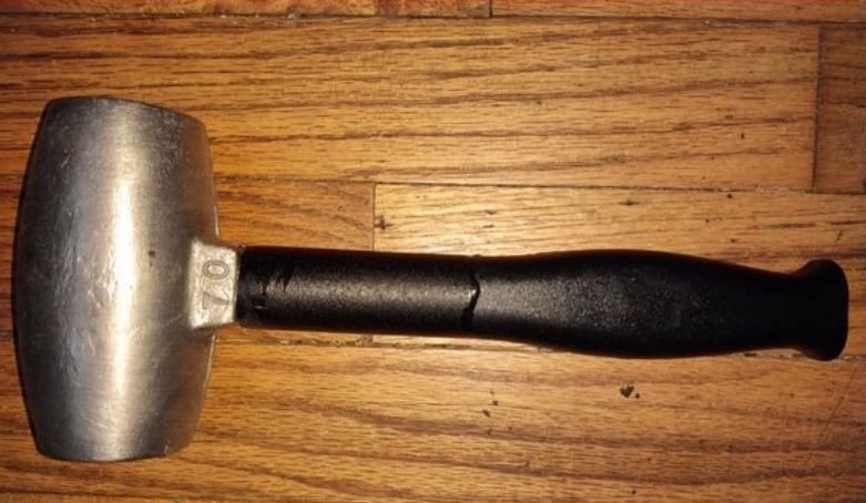

Some really hard hits should do the trick. Works for me.
