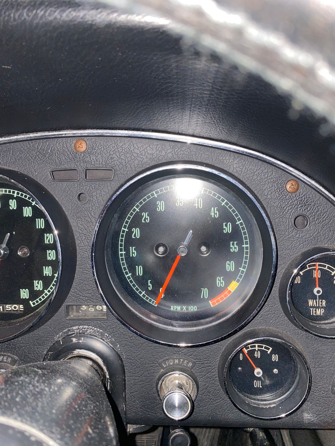

Dennis - Welcome to the Corvette Forum. Cool looking 65, congrats. I love the 65/66 Bigblock hood too. I bought my 65 300 horse coupe back in 1985 and it already had a 66 Bigblock hood on it. There are a few things you can look for to help try and figure out which engine it originally came with. And, keep in mind, all the 'tell-tale' signs could have been owner-changed along the way from when it rolled out of the showroom floor but the first thing to look at is the tachometer. Either post a pic of it or tell us the 'start' of the yellow/redlines.

Default Tach and oil pressure gauges

So far, so good. Looks like your column is falling down from the cluster. There is a bracket underneath held by two nuts. They might be loose.
Check it.

Dennis - If that is the original dash cluster and tach, your 65 either started out as a 365 Horse 327 or a 425 Horse 396. Quite a few ways to determine if it was a bigblock but one thing to look at is...where is the battery located?
They decided that when the 65 Bigblock arrived, around March of 1965, the battery would be placed on the drivers side and accessible via a removable panel on the back end of the drivers inner wheel well. The only other 65 Vette that got that battery relocation was the Air Conditioned cars. Then in 66 and in 67, for Bigblocks they figured out there 'was' enough room to put the battery where 'all' non A/C cars had them mounted, on the passenger side.
One other quick thing to look at is the underside of the hood. The Bigblock Hoods look identical on the outside for 65 and 66 Bigblocks but in 66, all hoods got a hood emblem on the drivers front corner and to access the speed nuts for that emblem, there are holes in the underside of the hood...for 66 models. No hood emblem on 65's so no need for those access holes.

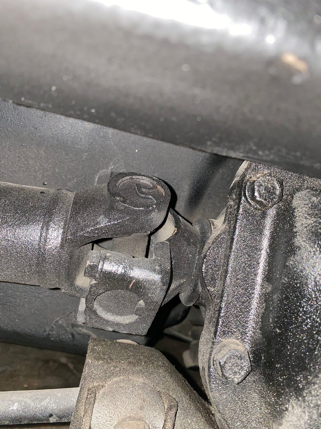

Oh, and on the rear end, right where the half shafts connect to the center pumpkin...tell us (or post a pic if you can) about the attachment, is the U-joint secured with a U-bolt or steel caps...steel caps were used on Bigblocks.

Mike is this what you are talking about
