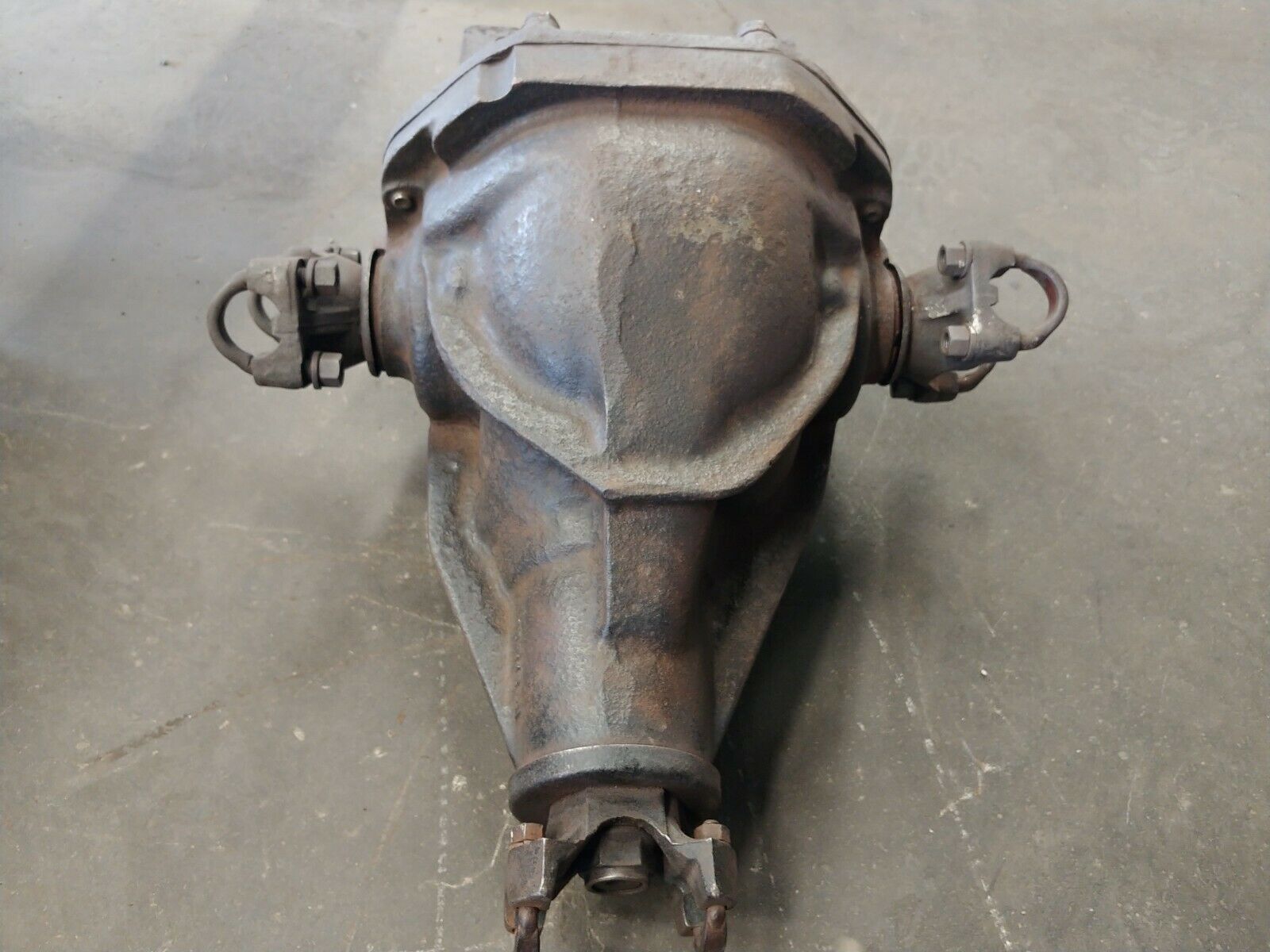

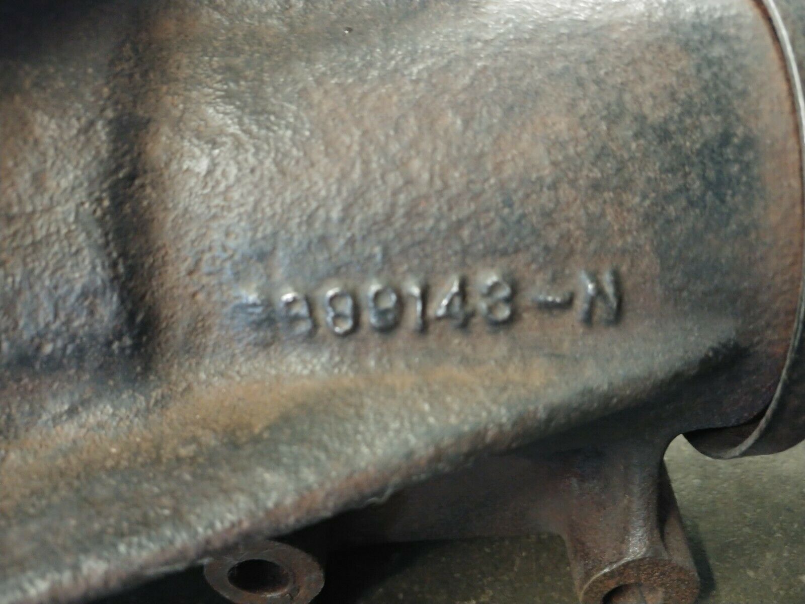

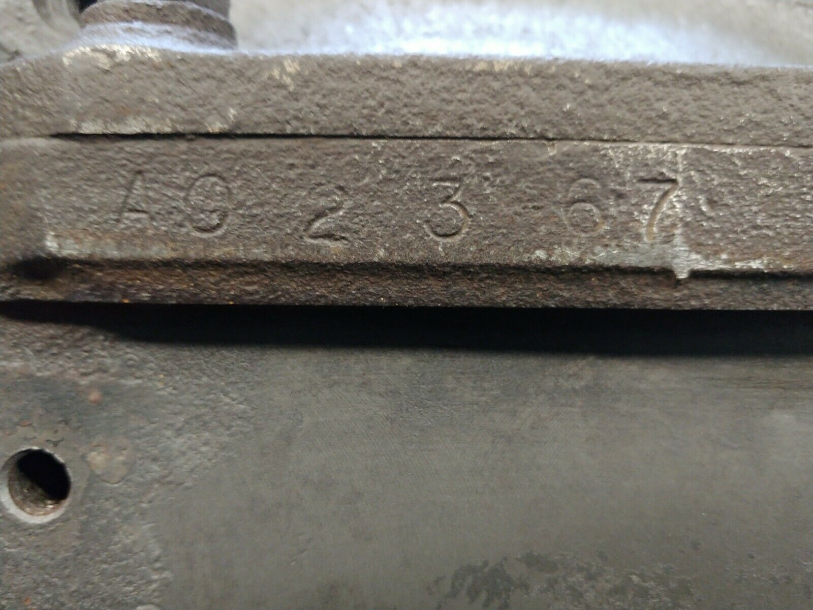

Can anybody help me in identifying this C2 diff please. Said to be a 1967, 3.73 ratio.Is there a way to identify from these photos whether its posi or not please, I am not currently where the diff is located.
Numbers on the casing are 8871375

AO is the code for a 65 to 67 3:70 Positraction differential, that one is dated 2 3 67. It's possible the inner gears may have been changed, but a quick turn of the driveshaft yoke and counting the revolutions of the half shaft yokes would confirm or otherwise establish the ratio now in the case . . . .

who knows , could be AQ or AO AQ is a 4.56:1 Posi looks more like a AO 3.70:1 by the stamp

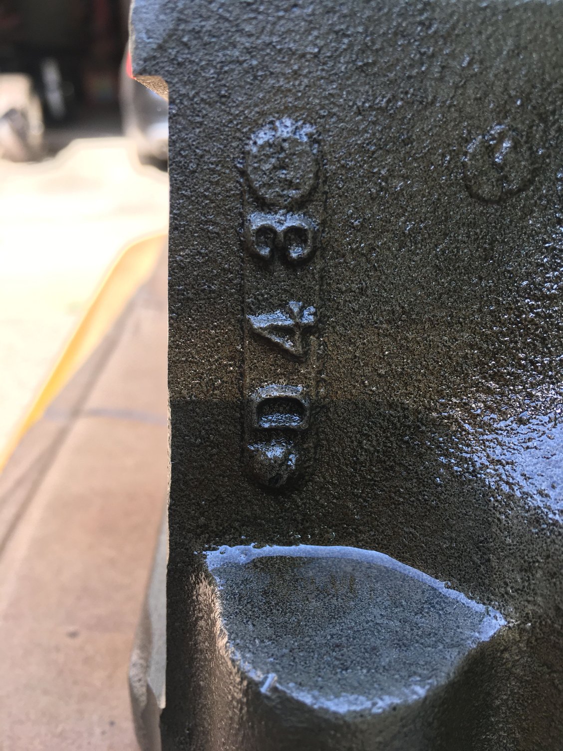

Look at the left side for a casting date for the main housing.
