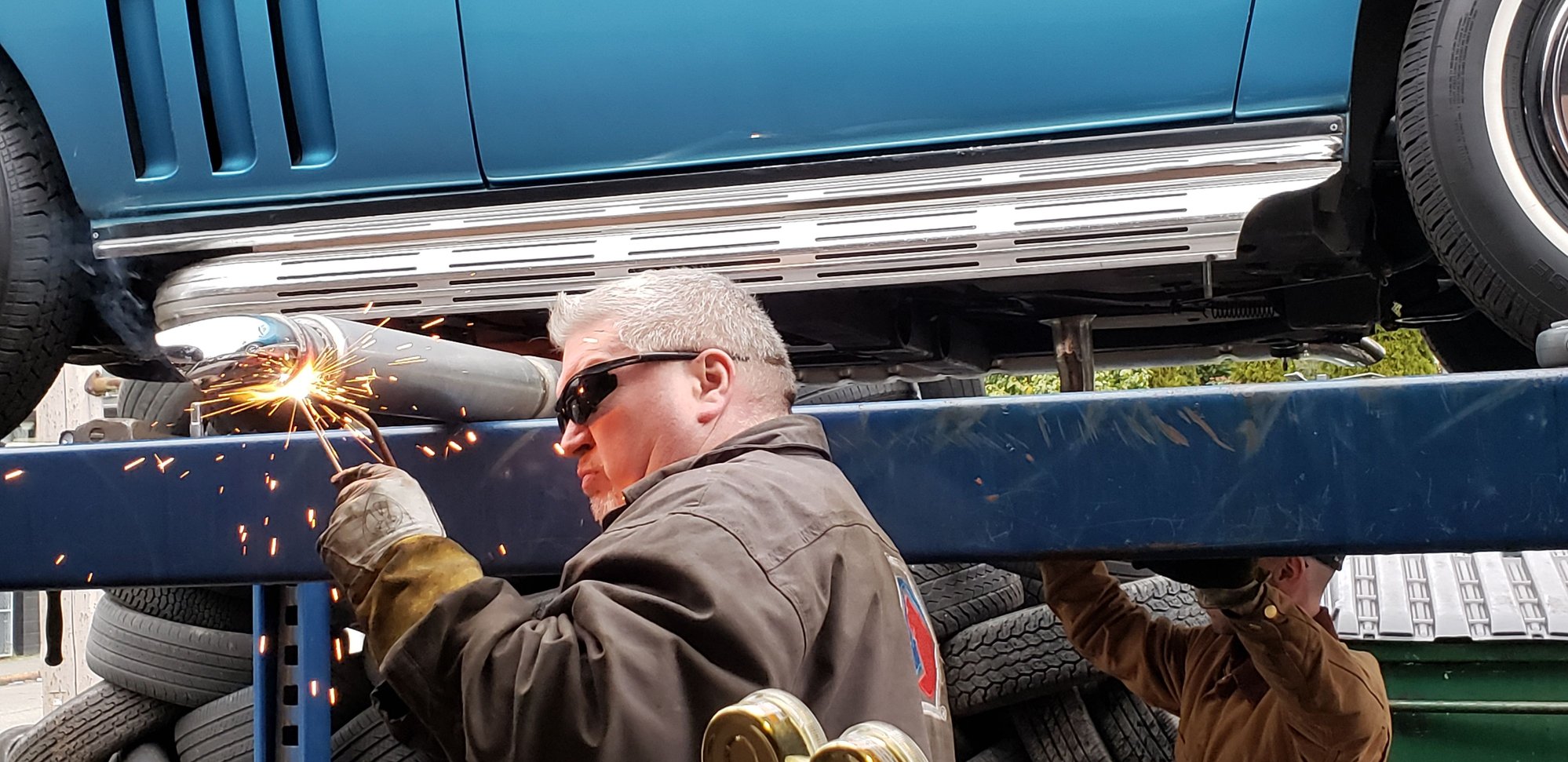

OK, to preface - Beauty is in the eye of the beerholder, or earholder in this case.
And no, I did not before and after dyno the car, nor did I take decibel readings. I'm not trying to advertise for a non supporting vendor, this is just my opinion.
I had the 2-1/2" - 3-1/2" Vettepacks installed just before Christmas. My installer has owned his shop since the 70's, still uses oxy/acetylene, and he's as good as I've seen over the last 50 years of hot rodding. He was (as usual) a bit of a skeptic at first - "Just two glasspacks welded together". And of course he didn't care for having to cut the brackets off of the old pipes and weld them to the new ones. But he did his usual great job - and made new 2-1/2" head pipes as well. These Vettepacks are a tight fit under the covers, but they do fit. When he finished and I started it up he was good with them, and actually acted a bit surprised that it sounds this good. That's about as good as it gets for this guy. I like the growl just off idle - a bit louder than I expected, but like I said I like it. I've always enjoyed driving the old muscle cars around slowly - as well as quickly of course. Once the engine is over about 1800 RPMs it gets quieter, and out on the highway, they are not as loud as I expected. To me they are not as loud as my old pipes on the highway. My seat of the pants tells me the 365hp 327 really likes these things. To me it's noticeably more responsive when you step on it. Although Lars rebuilt the carb and I've reworked the distributor vacuum and mechanical curves per his papers, I thought this SHP 327 should be quicker than it was. I put a hopped up 327 in a Vega in '73, and that thing ran quick. Yes it was bit lighter than this Vette, but this Vette just seemed like it should have had more power. To me the sound of these at wide open throttle is much improved over my old sidepipe mufflers, which were aftermarket reproductions. I actually disliked the sound of the old pipes other than idling around, but the Vettepacks have a nice sound when I jump on it, a deeper, throaty sound that gets better with RPMs. With our rain and snow here over the last couple of weeks I've only had it out a couple of times, but I already like this change and wonder why I waited so long.

Thanks, I know I'm lucky to have a real craftsman around who still enjoys working on these - even if he good naturedly tries to be a bit grumpy about it. Your installer will also need to cut the chrome tips off of the old ones and weld to the Vettepacks. My installer only charged $300 for the work, but he got a very nice tip.
My 65 had under car exhaust from the factory. At some point a previous owner converted it to sidepipes. They were mounted up well and appeared to be fairly new, I just did not like the sound under hard acceleration. I assume they were a reproduction sidepipe kit. Once they were off you could see the ID was pretty small, maybe 1-3/4" - maybe.
Classic Chambered Exhaust sells the Vettepacks. These are 40" long with the front 20" being chambered and the rear 20" a resonator. They make them to order, so you can divide the 40" up with more or less chambered or resonator per your liking. They took a couple of weeks to build them, but to me they were just what I was looking for.
