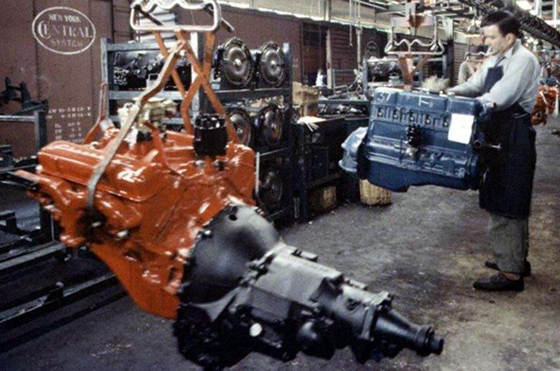

Here is a photo - engines look more blue

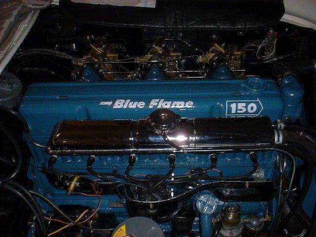

Here is an engine I shot recently

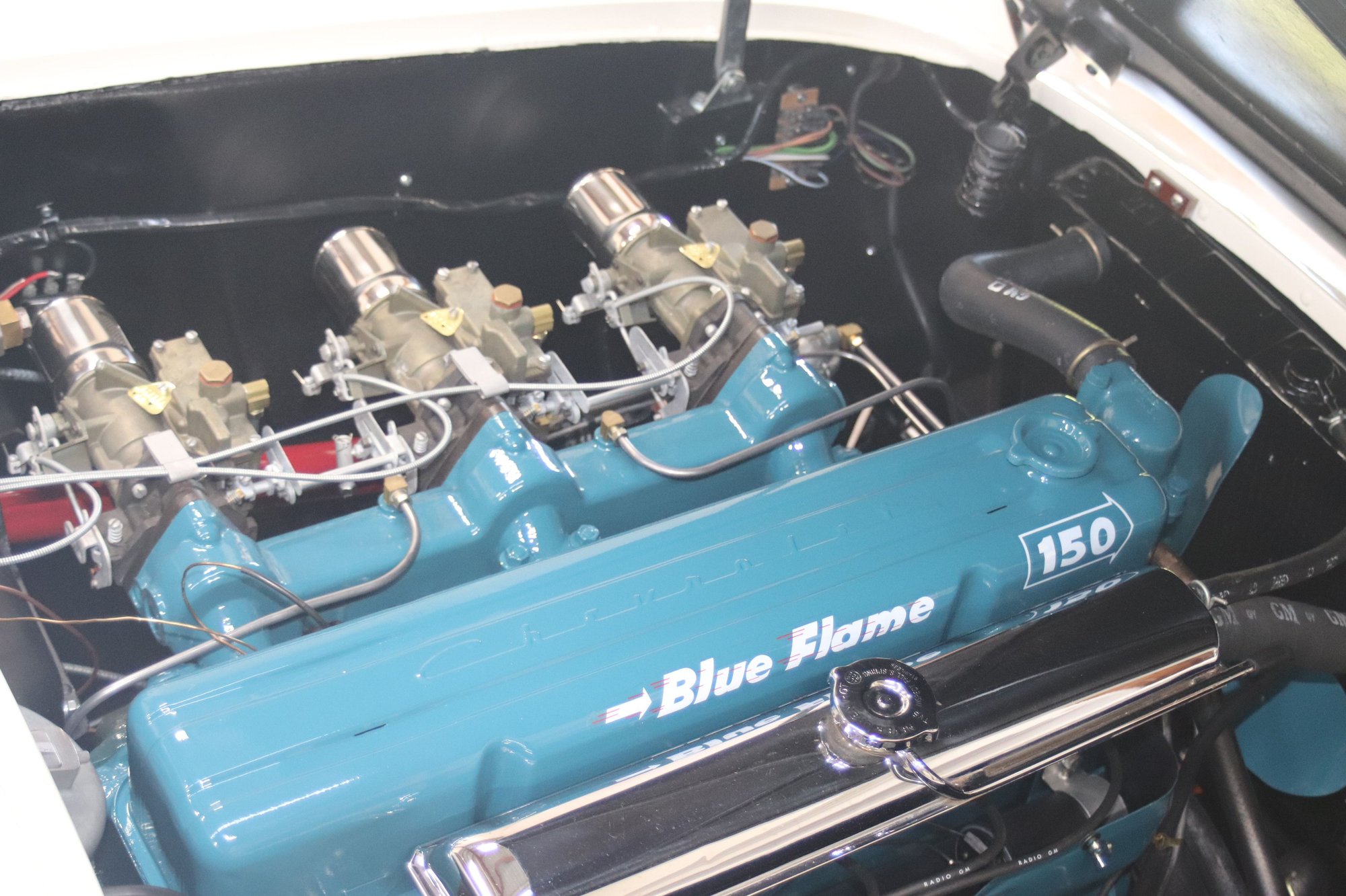

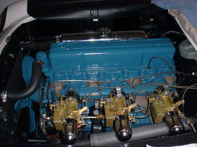

FWIW, here are some pictures of the motor in my old 54. These were taken in 1999.
