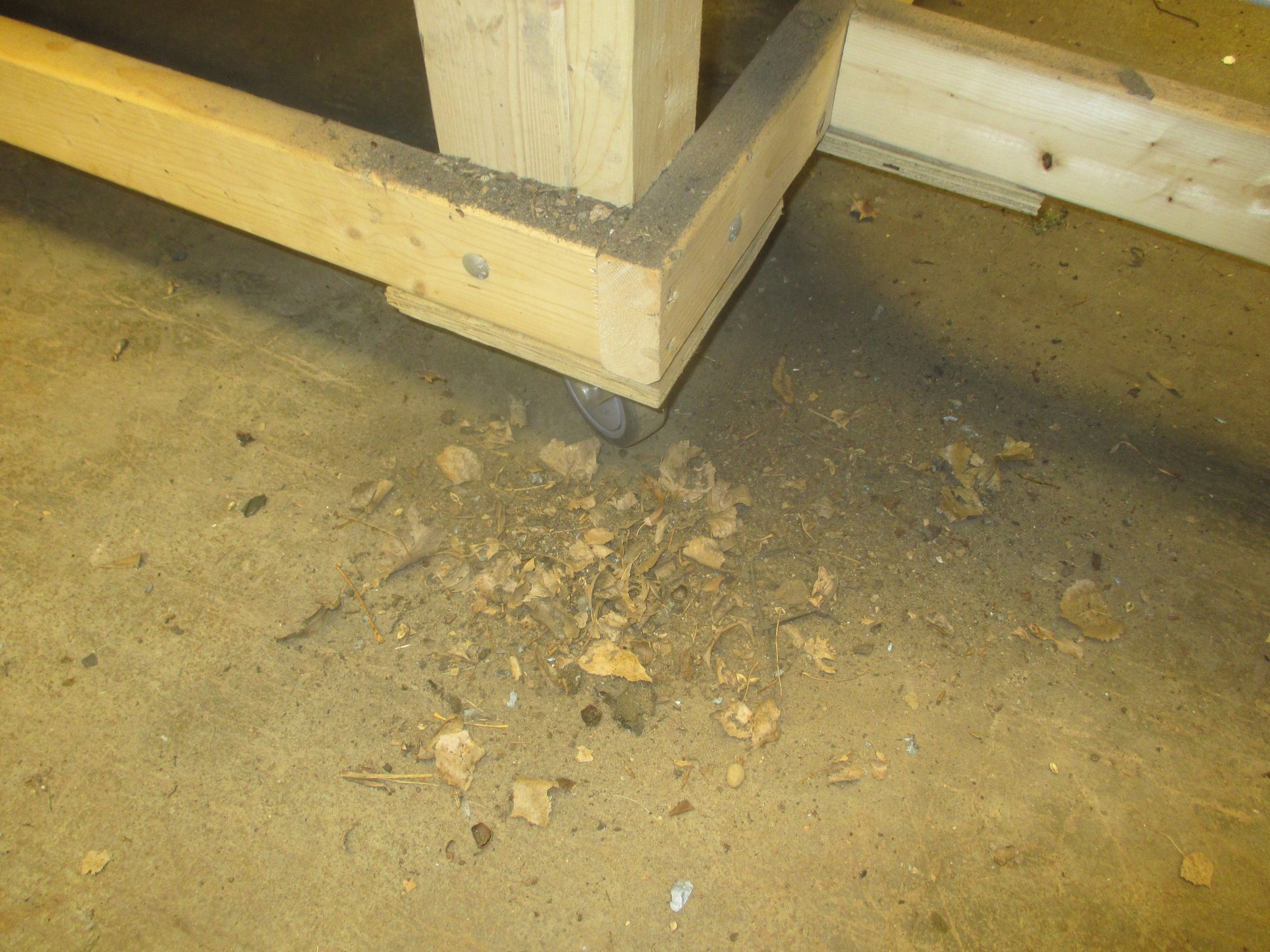

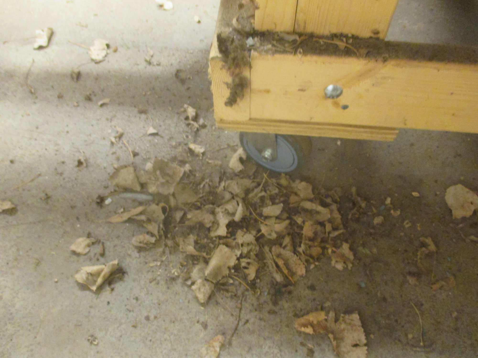

To elaborate in the vents 68heli mentioned, they tend to accumulate leaves, acorns, twigs etc over the years until plugged. Then the water will back up until it finds its way through the vent into the car. Here's a sample of what can be in there.
