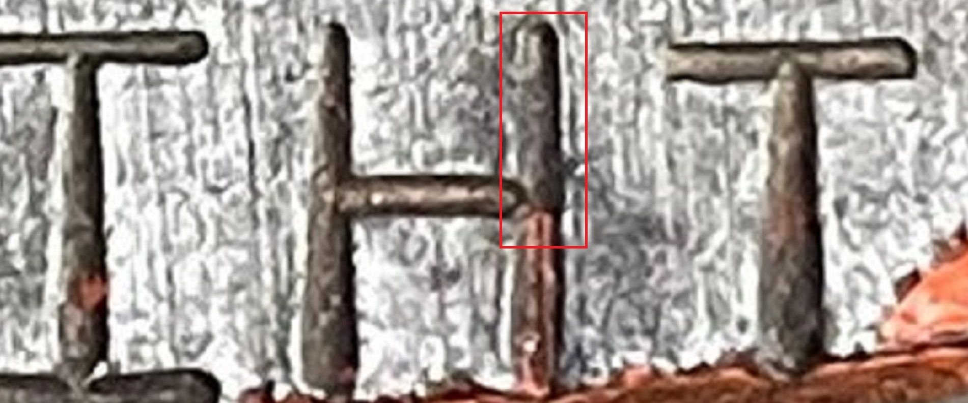

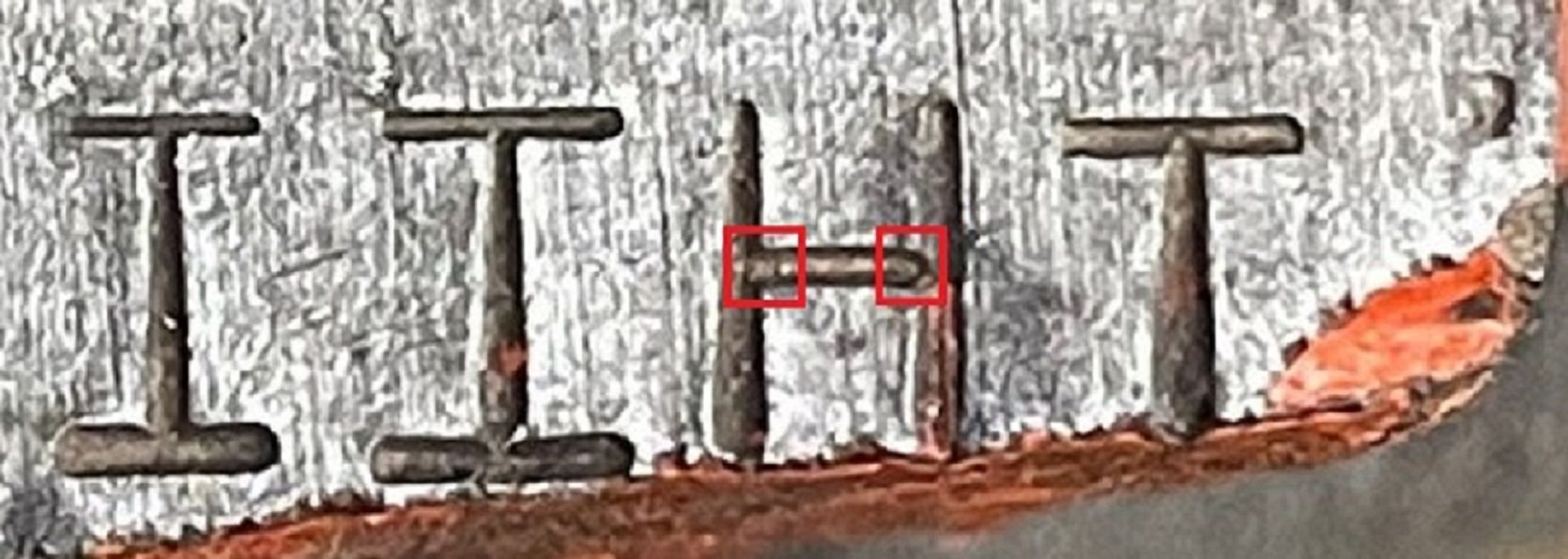

Is it a righteous stamp?
The force exerted across the stamping isn't uniform. Which was a common occurrence. This one tends to be lighter in the left upper area. But the force on the right vertical of the H isn't as consistent. Note the metal forced up around the upper right vertical that isn't as visible elsewhere in the stamp. The upper part doesn't seem as one with the horizontal and possibly the lower part of the right vertical.
Why does the right end of the horizontal look like it has an end? While the left end is open or integral to the left vertical.
Your thoughts?

This is well within the limits of normal factory variation on known-original pad stampings. There were lots of "H" inserts in a bin at Flint, and lots of gang holders. Some of these were old and worn, others less so. Many factory stampings have much more variation than this one.
