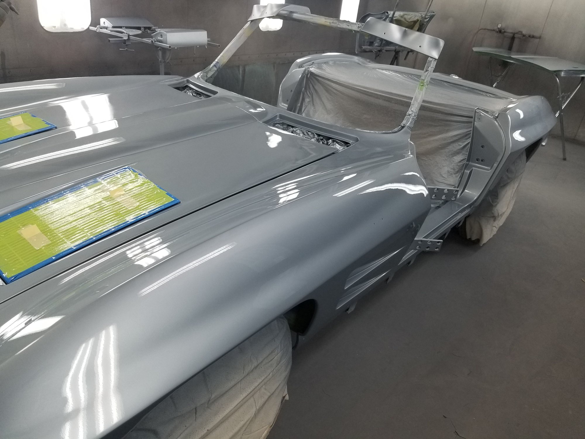

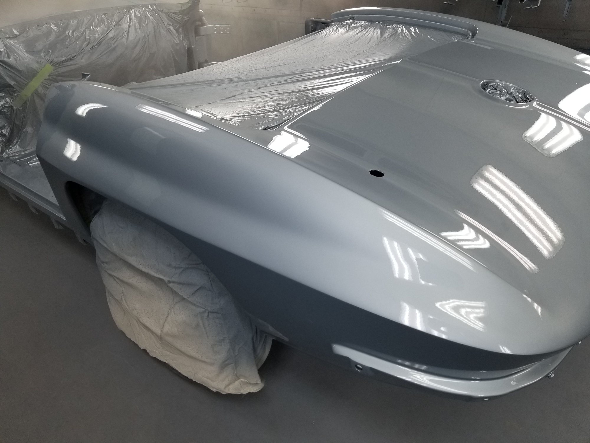

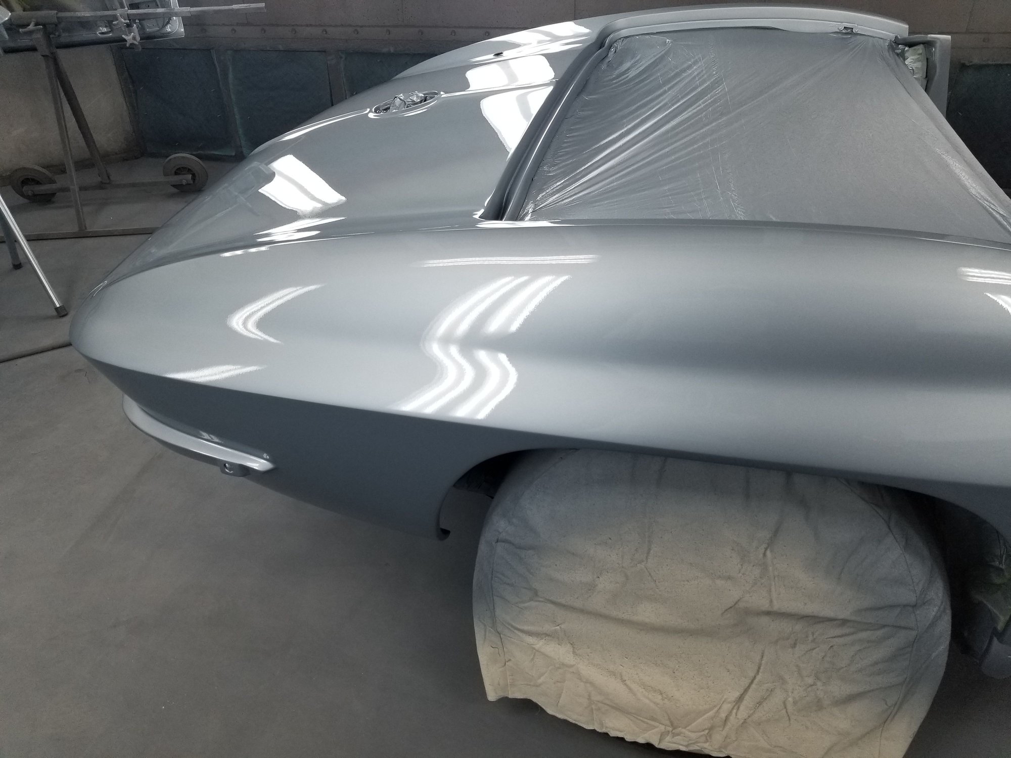

I spent months with hundreds of hours preparing our '63 for paint. I did all the preparation work, primed & blocked numerous times. Used guide coat each blocking session. I did this several times and went up to 500 grit paper.
When it came time to actually spray the color (silver blue), I knew I didn't have enough experience to spray the paint (two stage), correctly.
I was able to contract with an incredible painter who only agreed to paint after he viewed the work I put into the prep.
The guy had/has thousands of hours behind the paint gun. So glad I contracted him for a day, and even happier that he agreed to do the job. Gave me several compliments about my prep work. Again...several hundreds of hours in my prep work. Yet I'm sure a professional could have cut that down to at least half, but I'm not a professional.
Good paint is extremely expensive! Pay a professional to apply the paint, especially if it's a silver color.

Really like your silver blue paint color. I almost painted mine silver metallic, but my painter told me silver paint is almost impossible to color match. Very easy to keep clean and hides most minor scratches.
