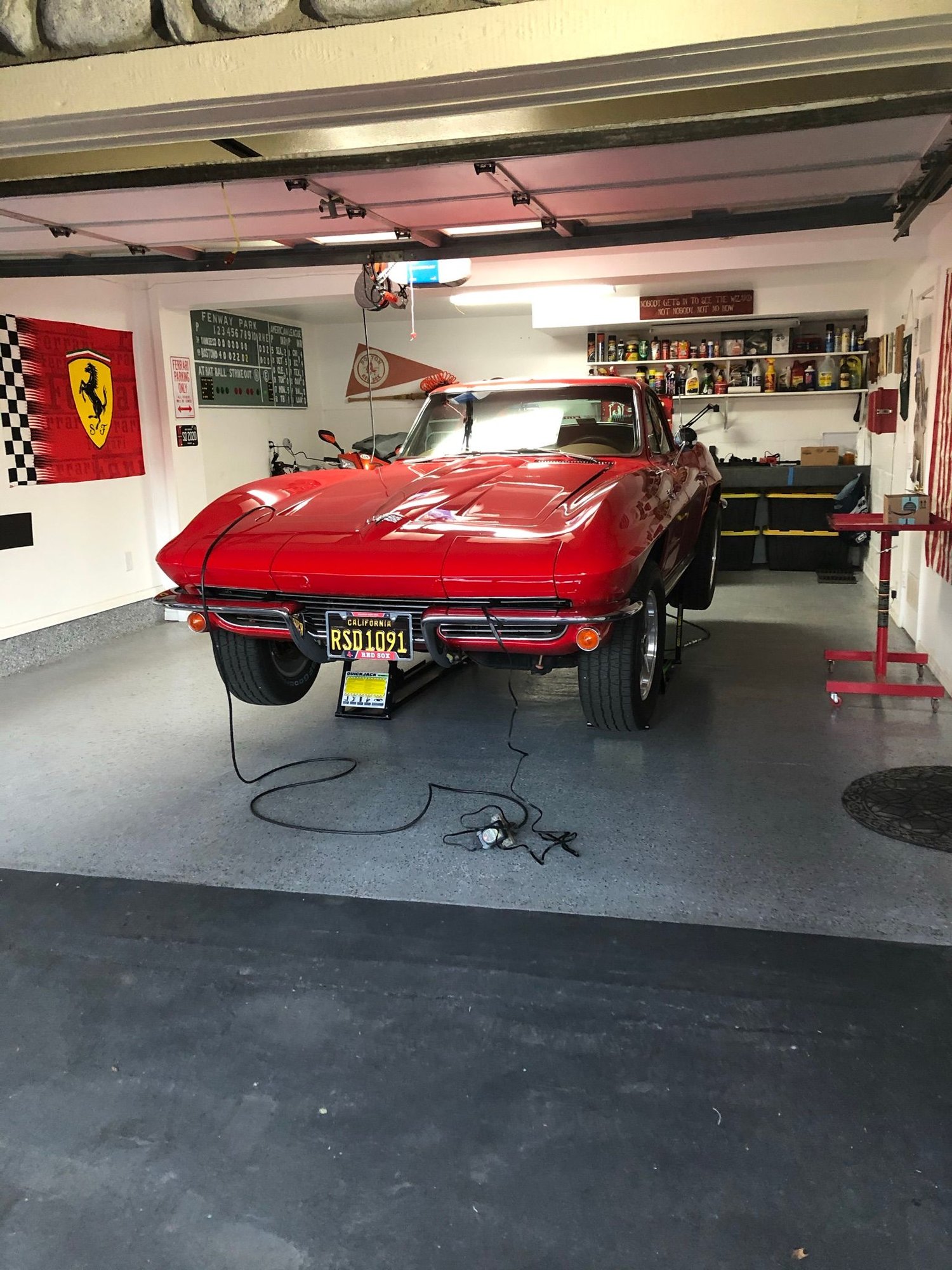

I’ve had my Quick Jack for a few years now and have never experienced a problem. Just a couple of points to consider however. First of all, these jacks are heavy. I store mine vertically against a wall in my garage. While there are casters one one side, it’s still a bit tedious getting them into position under the car. Secondly, the fluid reservoir is made of plastic which expands and contracts when the jack is operating. No issues with that either, but I’d prefer metal.
