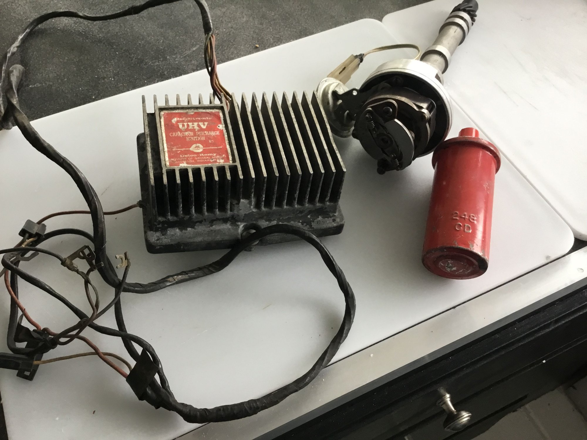

Basically the REAL question here is about the distributor length and what it will fit in but I am going to give you the background on all of this.
Ok, so a while back I bought a K66 UHV ignition system basically for the coil and intending to convert a tach drive points distributor with the parts out of non tach drive distributor that came with the system I bought. Turns out converting the distributor with the parts from the other distributor is not possible. So I am going to sell the complete system that I bought but am now trying to figure out what I actually have. I have been all over Chevelle, GTO, Z28 and Chevy Super Car sites trying to figure it out in addition to a site with a lot of info about UHV systems.
The distributor I have with this system rotates the same direct as Chevy but is 1/4” shorter than a Chevy distributor measuring from where it sits on the engine block to the bottom of the shaft. which is 7 3/4” verses the known Chevy distributor that measures 8”. Will this shorter distributor seat probably and work in a Chevy BB engine?
Regarding the system I am trying to identify it MAY be a put together system based on what it includes:
1. The distributor has absolutely no part numbers on it.
2. It has a vacuum advance unit on it that is a somewhat rare Z28 unit which is marked MS 400 15 not sure if this UHV system was available as a factory installed option or just an over the counter parts on a Z28?
3. The coil is a #248 CD which is supposed to be for both Pontiac and Olds but will also work with any vehicle with UHV system.
4. The UHV amp box has a very lightly stamped part number that LOOKS to me like 1116030 but I have not been able to find the application.
Here is a picture of the system.

This is just guessing, but could the distributor possibly be off of a BBC truck application? It is a curious item for sure.

Chevrolet distributors Bb and SBC are 7 3/4" from the bottom of the mounting base to the bottom of the gear. The bb truck block uses a different length.
That is a possibility as they apparently used these UHV systems on HD trucks, military vehicles, on Oldsmobiles, Pontiacs, Chevelles, Camaros and we’re sold over the counter as well as factory installed on SOME of these cars. I just don’t know if 1/4” difference would keep this distributor from fully engaging ad working properly? I would like to sell the complete system but need to know what it will fit and work properly in. I don’t want someone to just take a chance on it like I did that did not turn out well for me.
I believe some of the old truck engines were what they call high deck blocks.I would think they would need a LONGER distributor if I am understanding what that is correctly?
Well, that means the one I have been asking about is correct for what you listed above. So that makes me wonder what the distributor I compared it to is actually for? The strange thing is that we used THAT distributor in my 66 BB temporarily without a problem?
So, based on what I stated I have in the OP with the Z28 specific vacuum advance unit I should think that this system was likely used on one of those cars. I have not yet had an answer as to weather or not they were factory installed on those cars or if maybe this one was sold to someone that bought one over the counter for one of those cars.

it looks like you have a mix of parts to me.
Distributor looks like standard chevy. I think 7 3/4" is the correct length.
the UHV on the box and the red coil are what was used on Oldsmobile. think that was an option around the 1967 time frame on the W30 cars. i think these systems were also used on on the baldwin motion cars. so im guessing someone got their hands on an oldsmobile system, but needed it for a chevy so found a dizzy

Very possible but it is not JUST a standard Chevy distributor it is a magnetic pulse TI distributor in order to Mack the system work.
