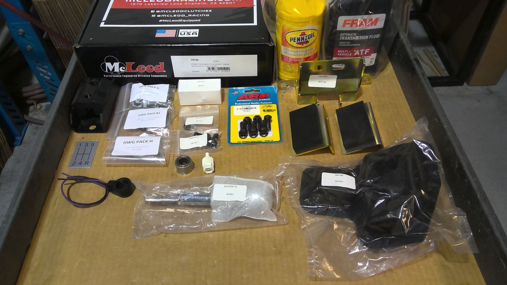

Received my hydraulic roller cam and lifters!
With supply issues, this was hard to find and the only one I could find in stock.

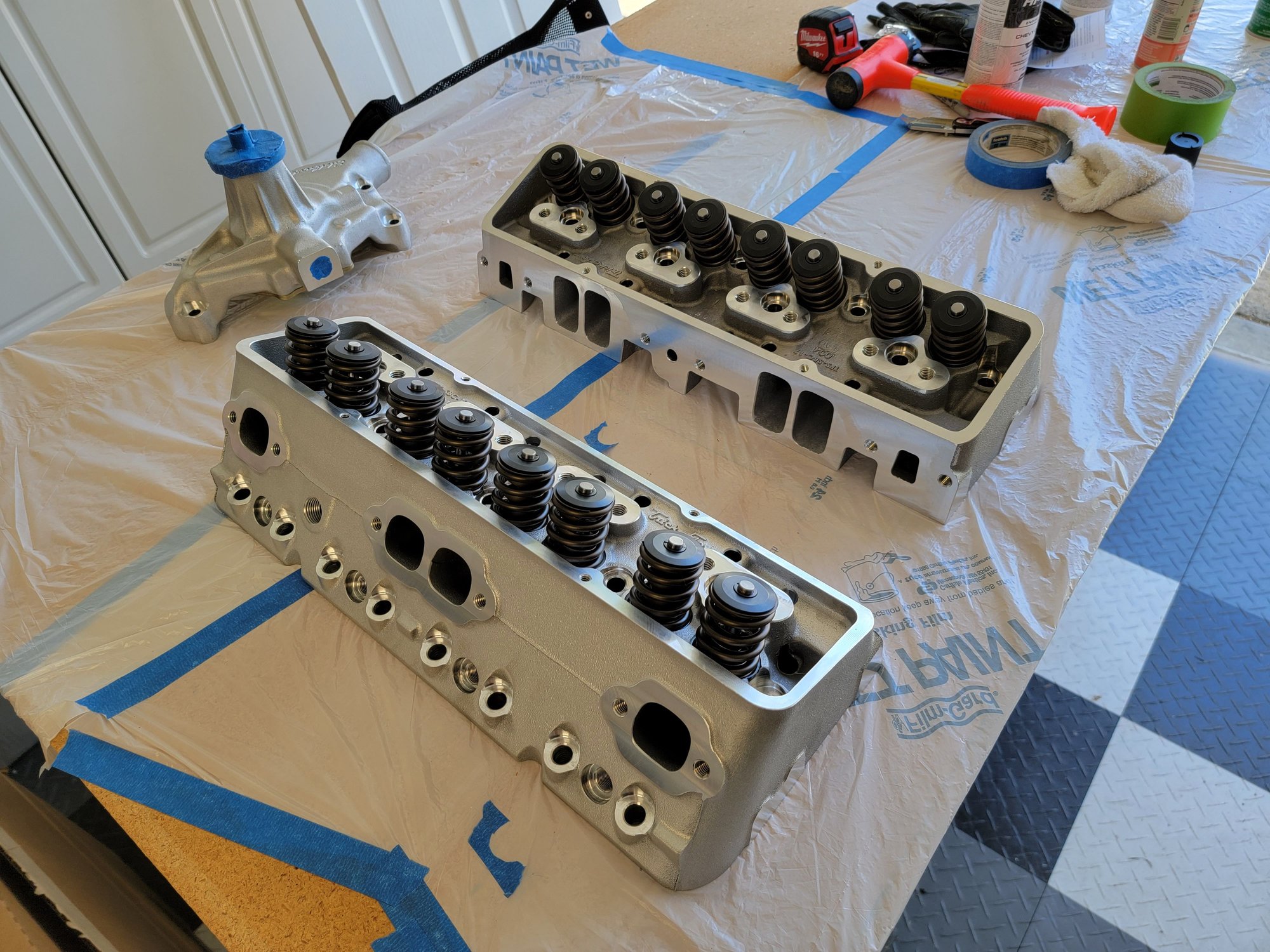

Love seeing this thread! Looks like we are doing similar updates at the same time. Same heads. Same trans. I went with a different hydraulic Cam, hydraulic lifters and roller rockers.
I'm following along with interest!

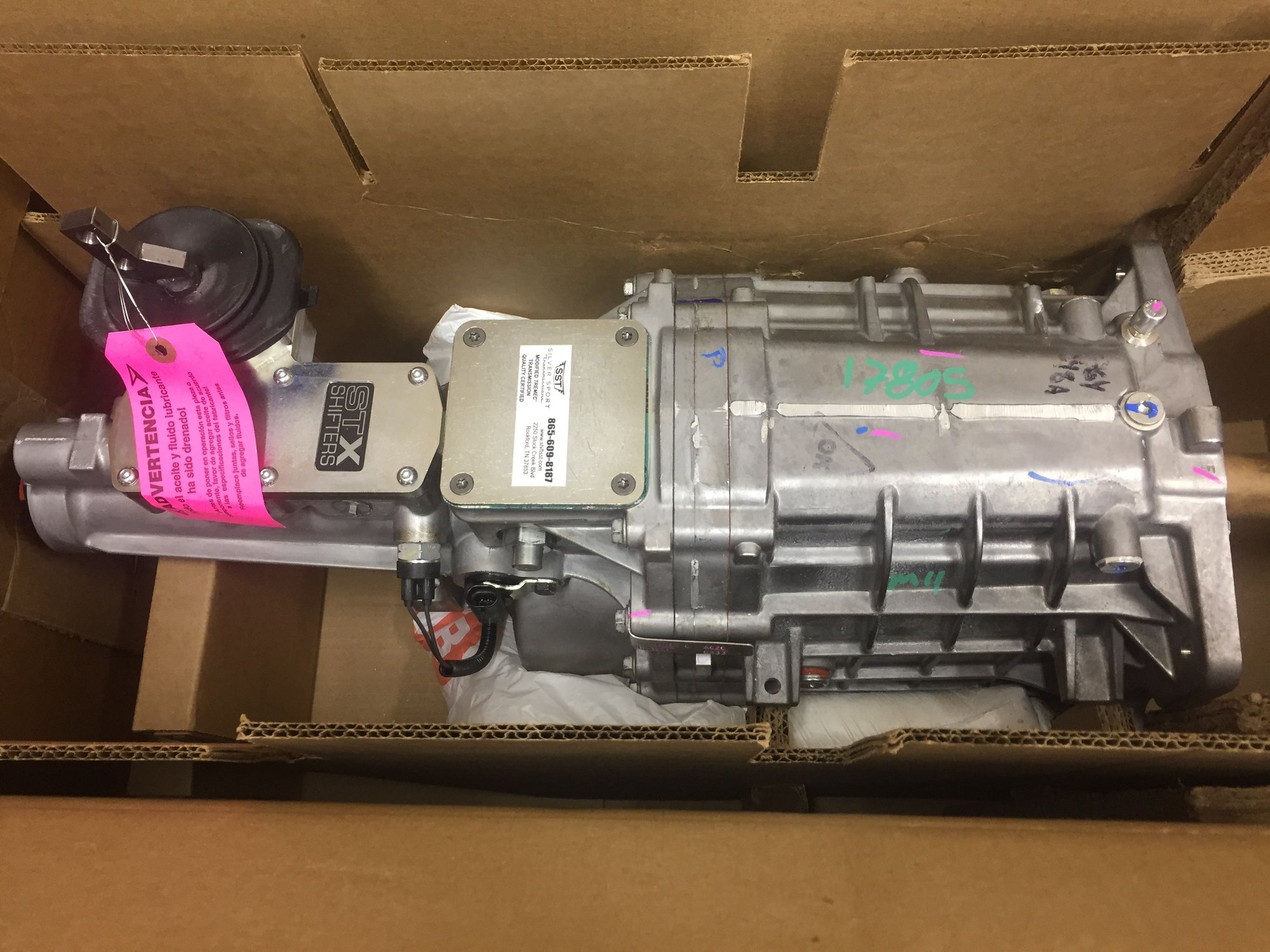

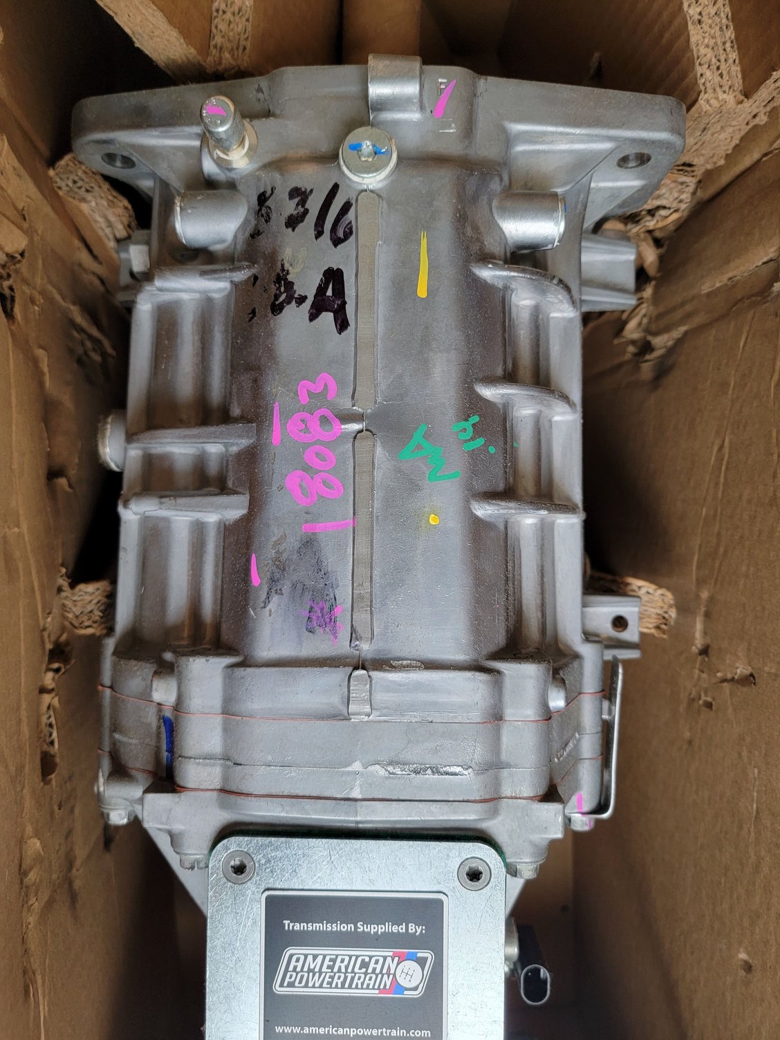

Say, that’s a good lookin transmission you have there? Close ratio?
Yes, I love knowing and seeing another similar build to mine as well!
what cam did you go with?

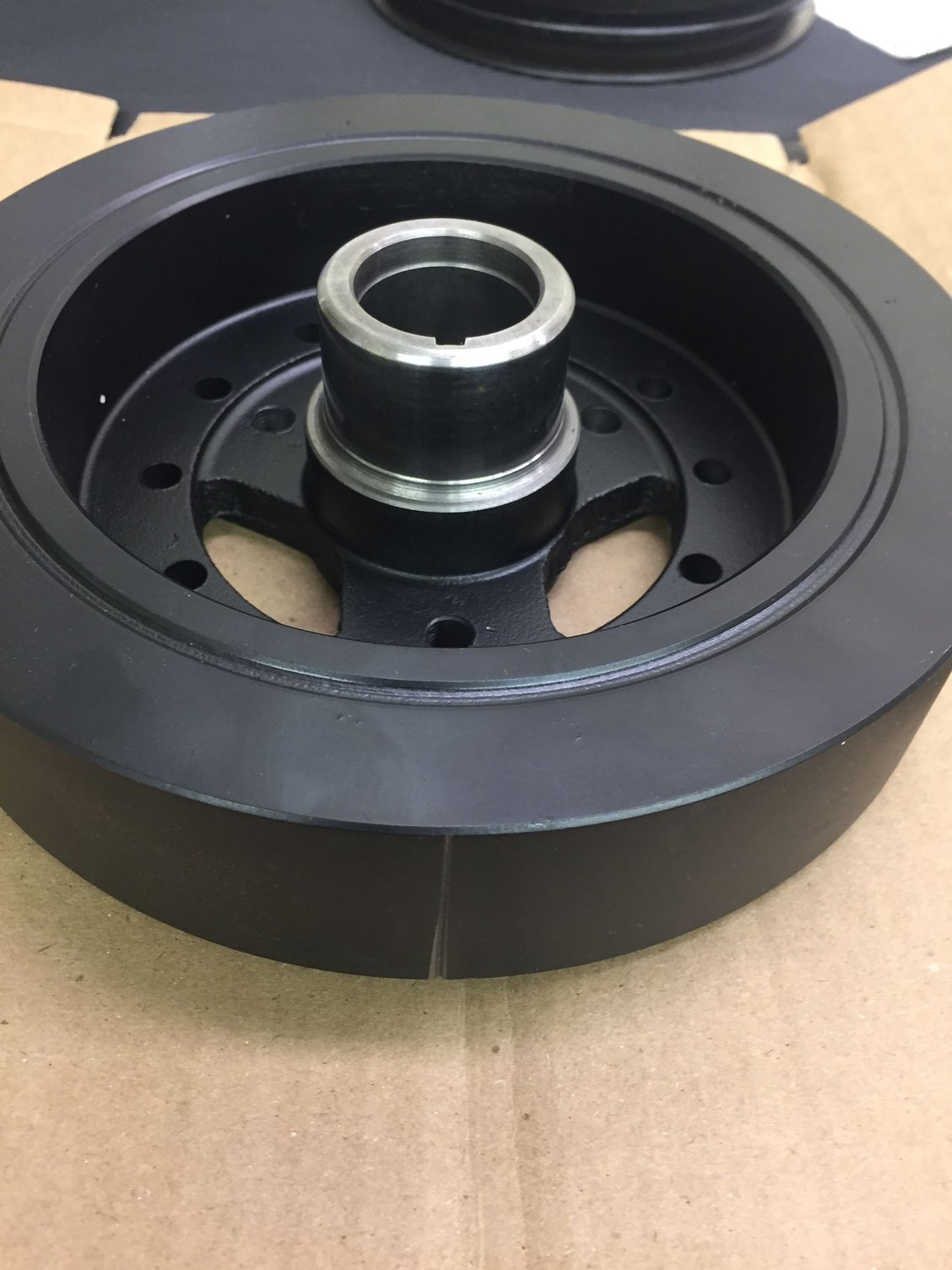

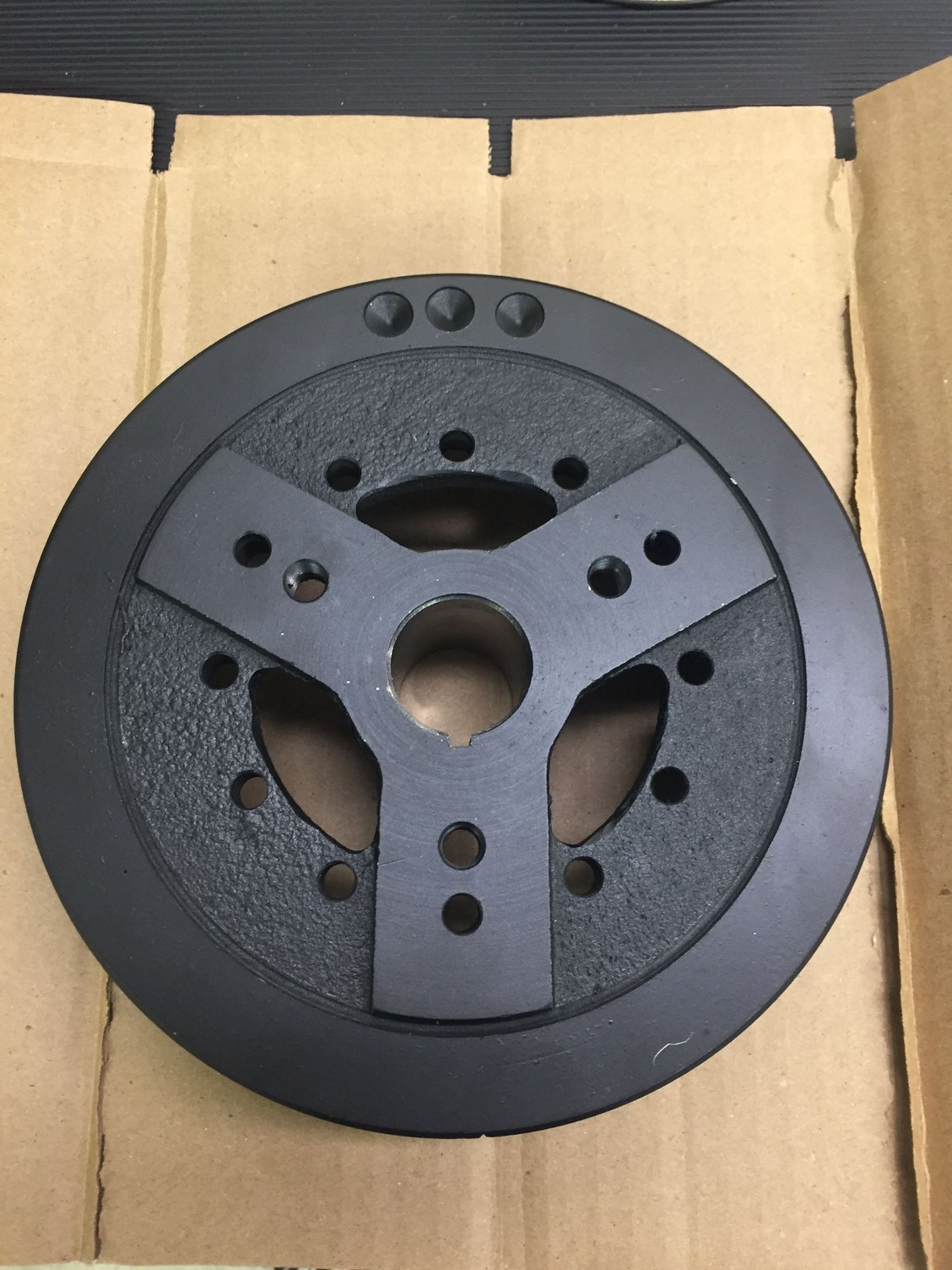

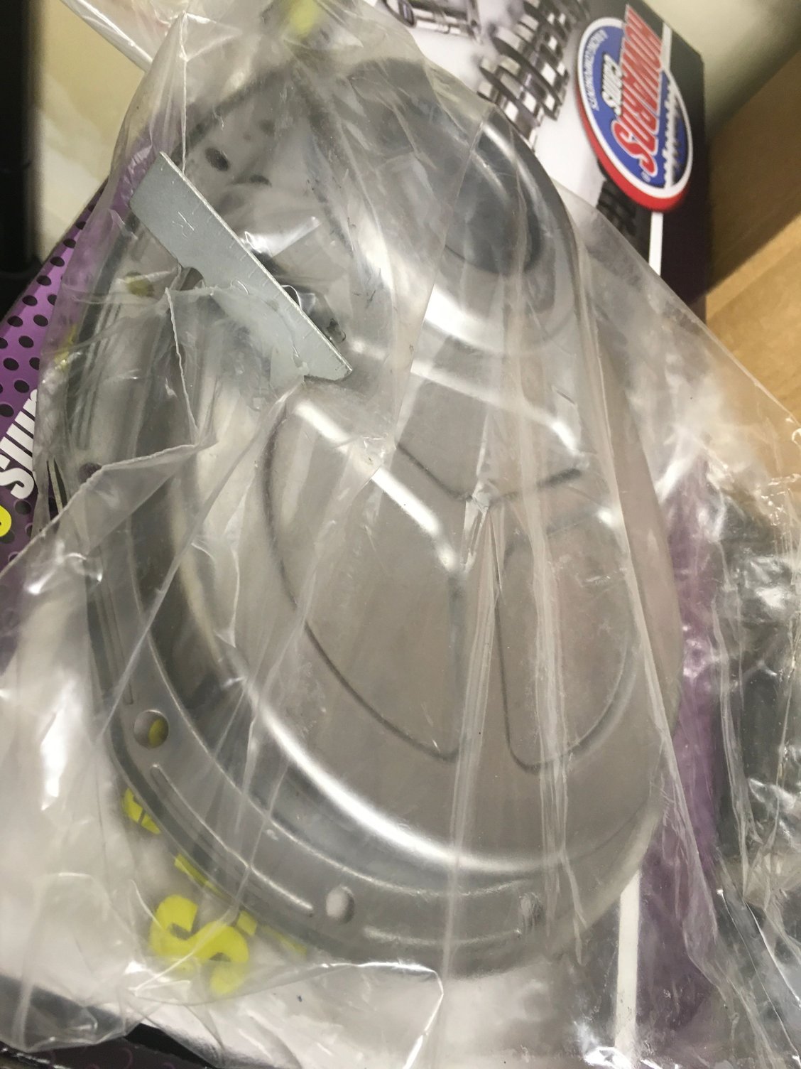

Here’s my timing cover, new repro from Zip. And my new 173 factory assembly line correct non finned balancer

Originally Posted by TRP_IV
@Ryans67vette - Impressive list of parts to make the tribute L79. I didn't see the SHP Timing cover on your list. I *think* you will need that if you're using the larger balancer.
I may be exposing my ignorance, but is there a benefit to the 'deep groove' pullies?
I believe the deep groove pulleys were for the HP engines so that the belts would hopefully not come off during high rpm

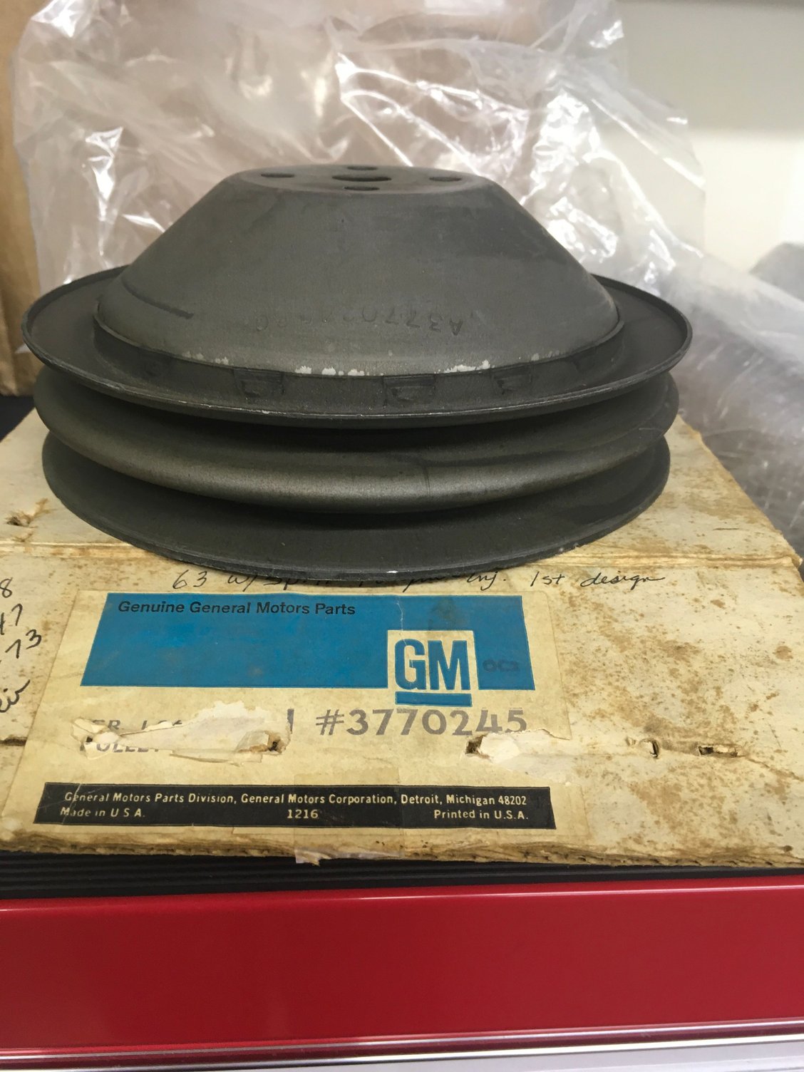

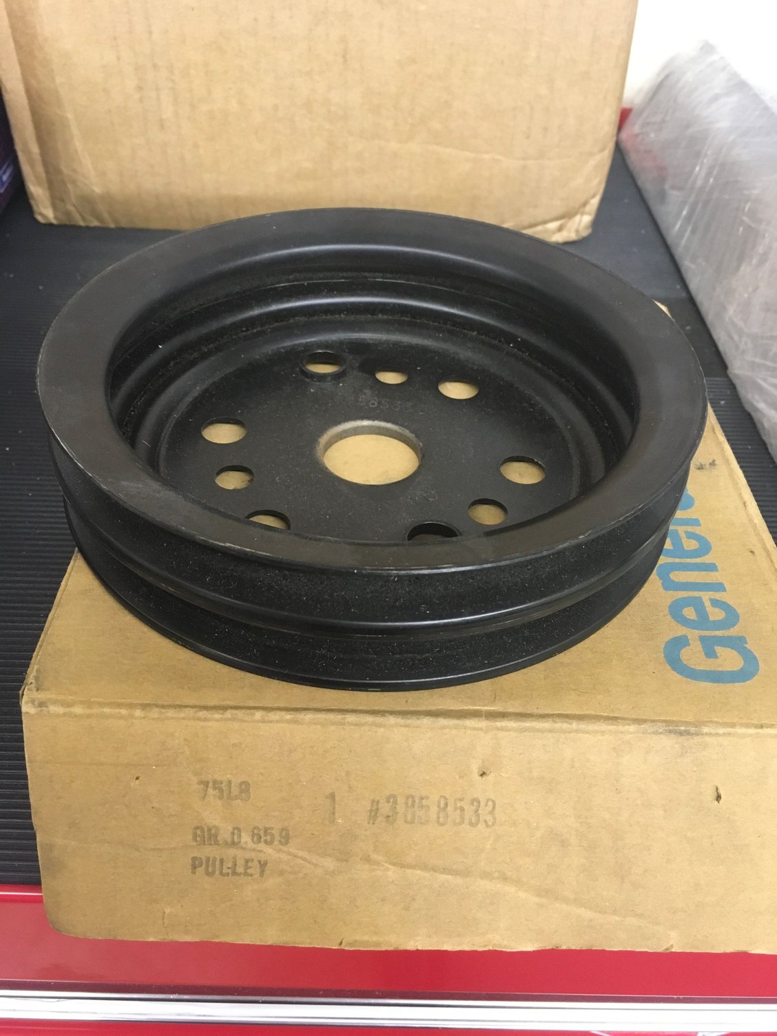

My NOS pulleys, correct numbers for a 67 L79 without power steering or AC.

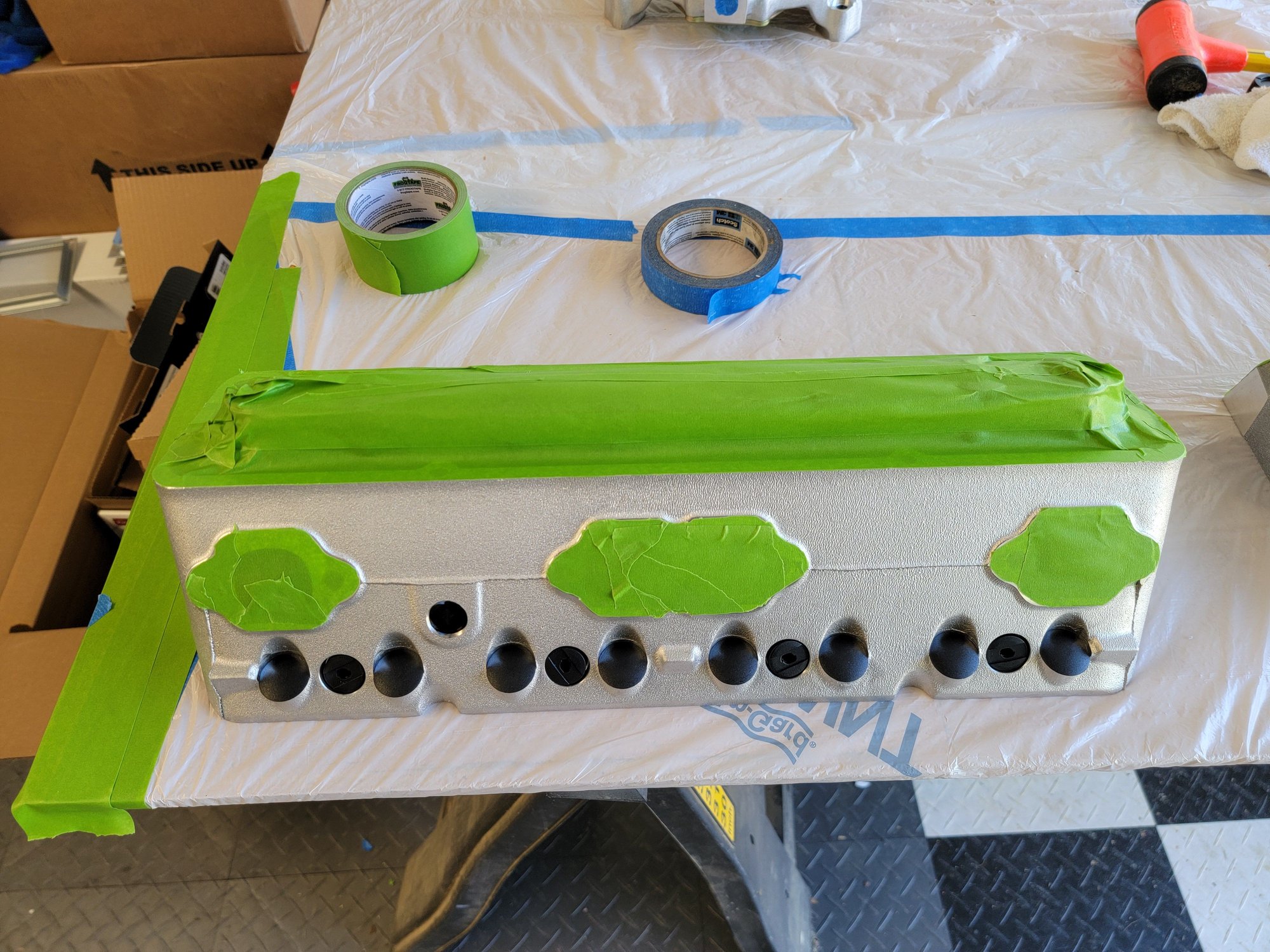

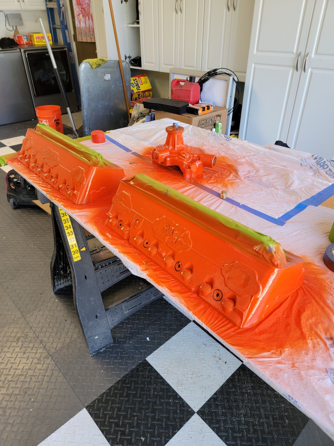

Default Seems like a shame...
So pretty
Tape 'em up!
ORANGE!
Tape off. Plugs out.
So pretty
Tape 'em up!
ORANGE!
Beautiful and Looking good! I can’t wait to get to that point.
