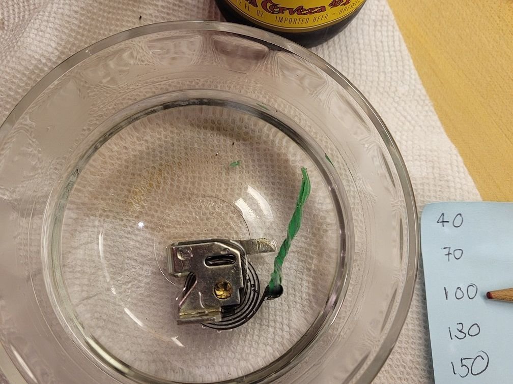

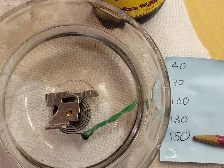

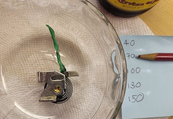

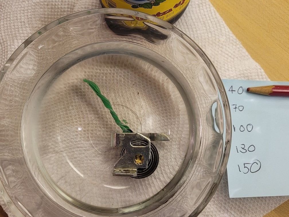

Took out the choke coil. It appears to be the standard aftermarket replacement, looks new and shiny, stamped with a 7129 on the coil, 25 on the base.
Put it in water at varying temperatures. As you can see from the pics, the loop in the coil is well above the stop at 40F and 70F, which is the way it appears in Zip and other catalog pics. At 100F it's part way down, at 150F it's close to the bottom of the well.
This would seem as expected in a system with a functioning heat riser apparatus.

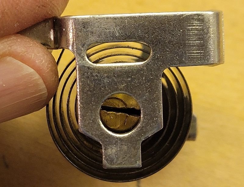

But for my application, I'd like it to reach full open at about 90F. When I saw the brass screw head holding the coil I had brief hope that it was adjustable. But it doesn't turn at all with moderate force. You can see I dinged it a bit.
Probably will try bending the rod so it's shorter and see if that'll do what I want, but if the coil could be shortened, it'd give a wider range of travel as the 40-70F range is hitting the open stop.
Has anybody worked with these coils to modify them? Can a new loop be easily formed with pliers? Is that done at a high temp? I'm sure it's possible to ruin a few trying.
