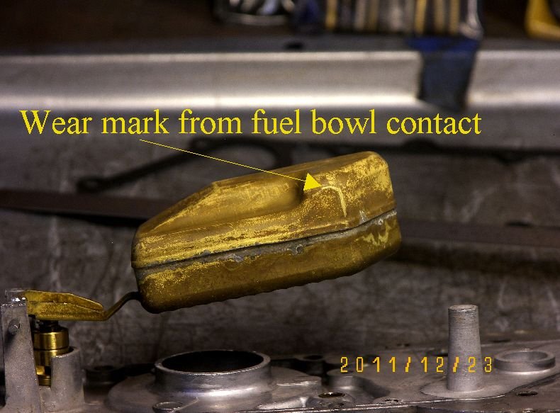

- Next time you have the fuel meter lid off, examine the float. Look at the front, lower, inboard corner. If there is a shiny spot there, the float has been rubbing on the inboard wall of the fuel meter. If that's the case, then that's likely the cause of the bowl overflow and it will happen again unless you fix the problem.
