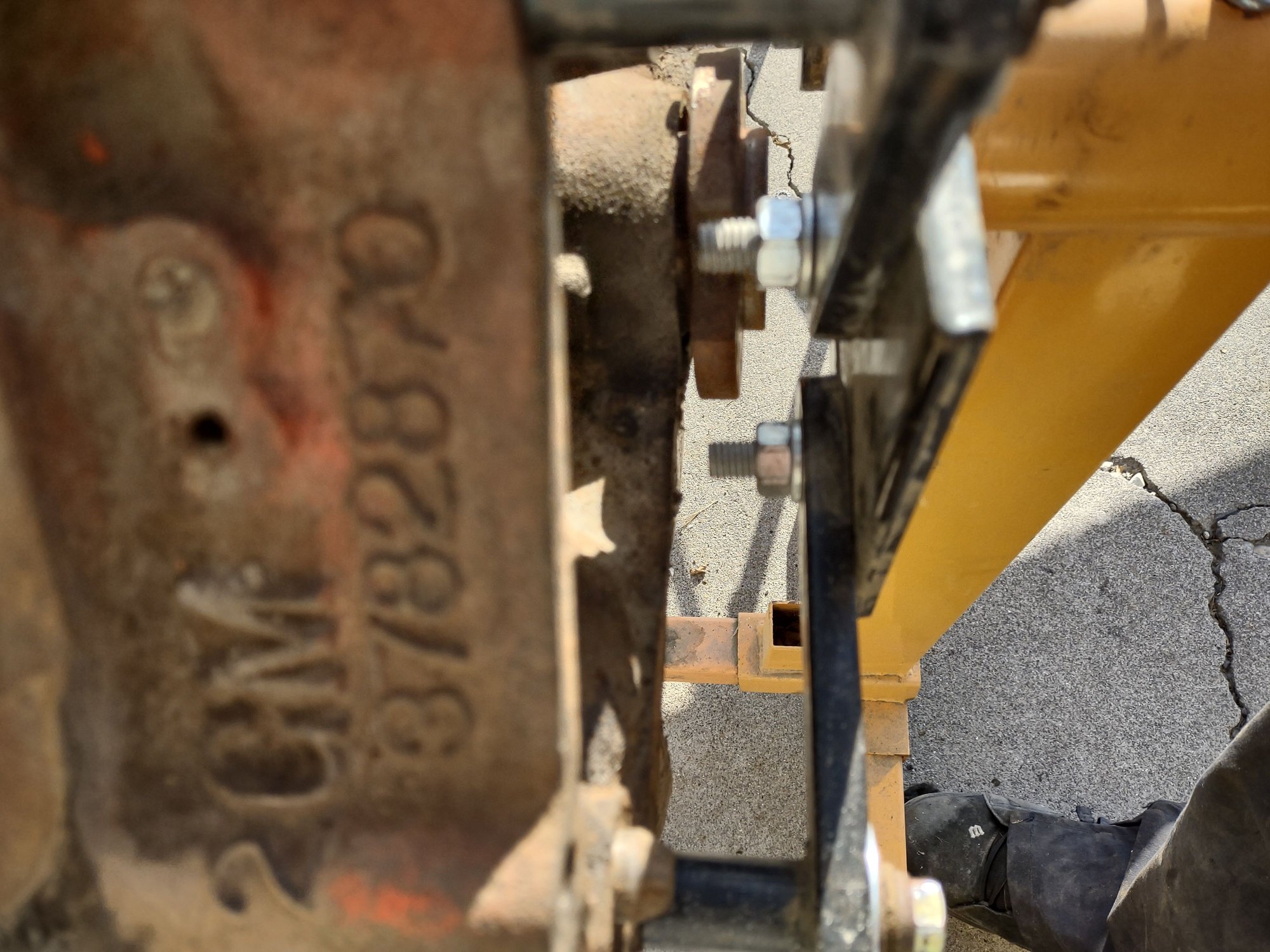

I need help identifying an engine the numbers are as follows...
3782870 on the bellhousing flange and J251
Inside the bellhousing is H-11 with a 935 on top of a 870
On the machine pad on the passenger side front is "FIIOIS"

‘62 327/250 Powerglide engine. Cast October 25, 1961 and assembled on November 1.

From a passenger car, not a corvette.
