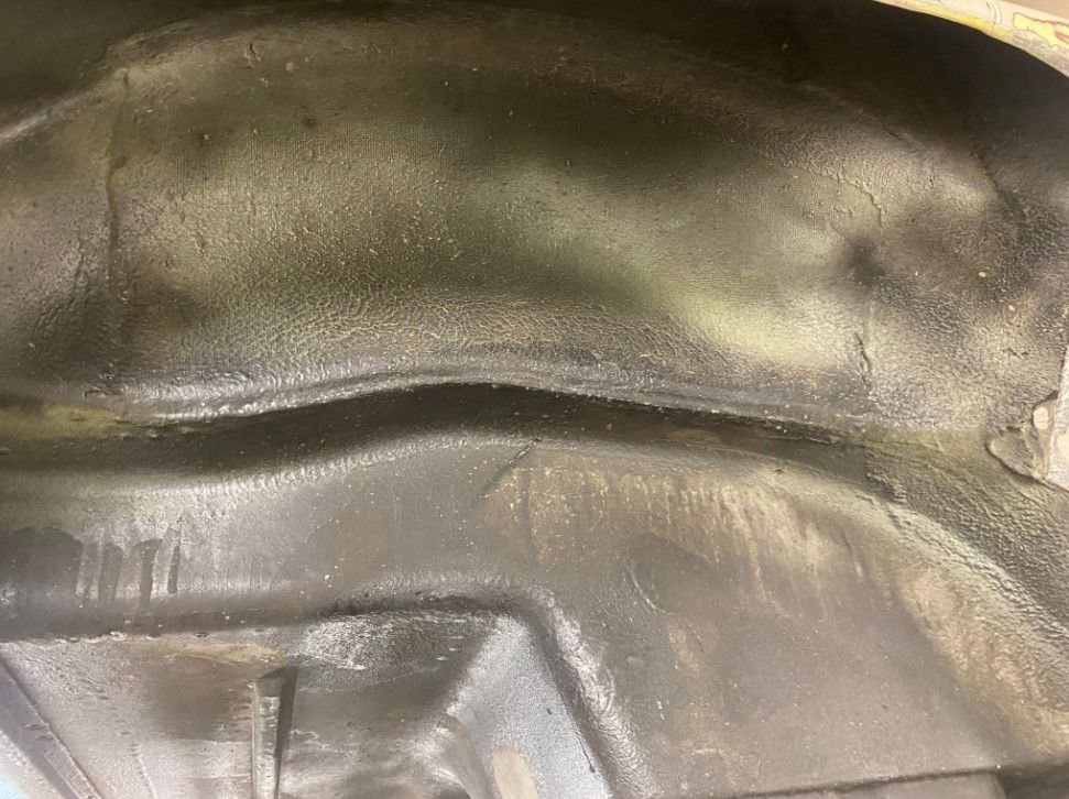

Here a picture of my actual project, my 65 tanker in sunfire yellow. Here you can see the inner fender:

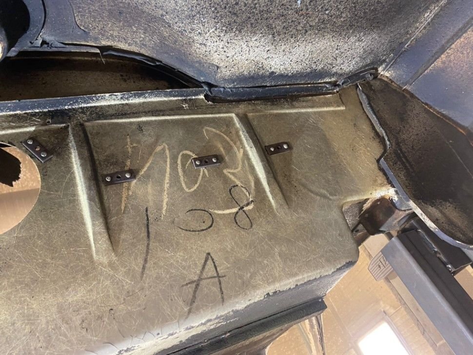

Also a nice documention for N03. We found 2 markings N03.
Old Apr 14, 2022 | 02:06 AM
TCracingCA's Avatar
TCracingCA
Joined: Sep 2002
Posts: 38,360
Likes: 2,085
From: California
Originally Posted by Ol Blue
Please forgive my density, I can readily understand how the inner fender panels described in the bulletin I posted would allow for larger tires including making more room for the negative camber caused by the heavier weight over rear axle due to the larger fuel tank filled weight.
What I can't get my arms around is in what way would the rear fenders, and I mean the outboard rear fender panels be wider than a stock 63 Corvette. Perhaps it's just nomenclature differences.
Thanks
Gary
The inner is kind of indented or cut out. White glass!
Old Apr 14, 2022 | 09:21 AM
mikelj's Avatar
mikelj
Joined: Jan 2009
Posts: 3,500
Likes: 1,712
From: High Mountains of New Mexico
2021 C2 of the Year Finalist - Unmodified
2015 C3 of the Year Finalist
One has to remember that an additional 20 workers were put on the lower body line in St. Louis to create a tanker, much modification and fabrications were needed. That is why many were batched. And why several areas on the lower body were marked with "N03", to alert workers as it came down the line.
