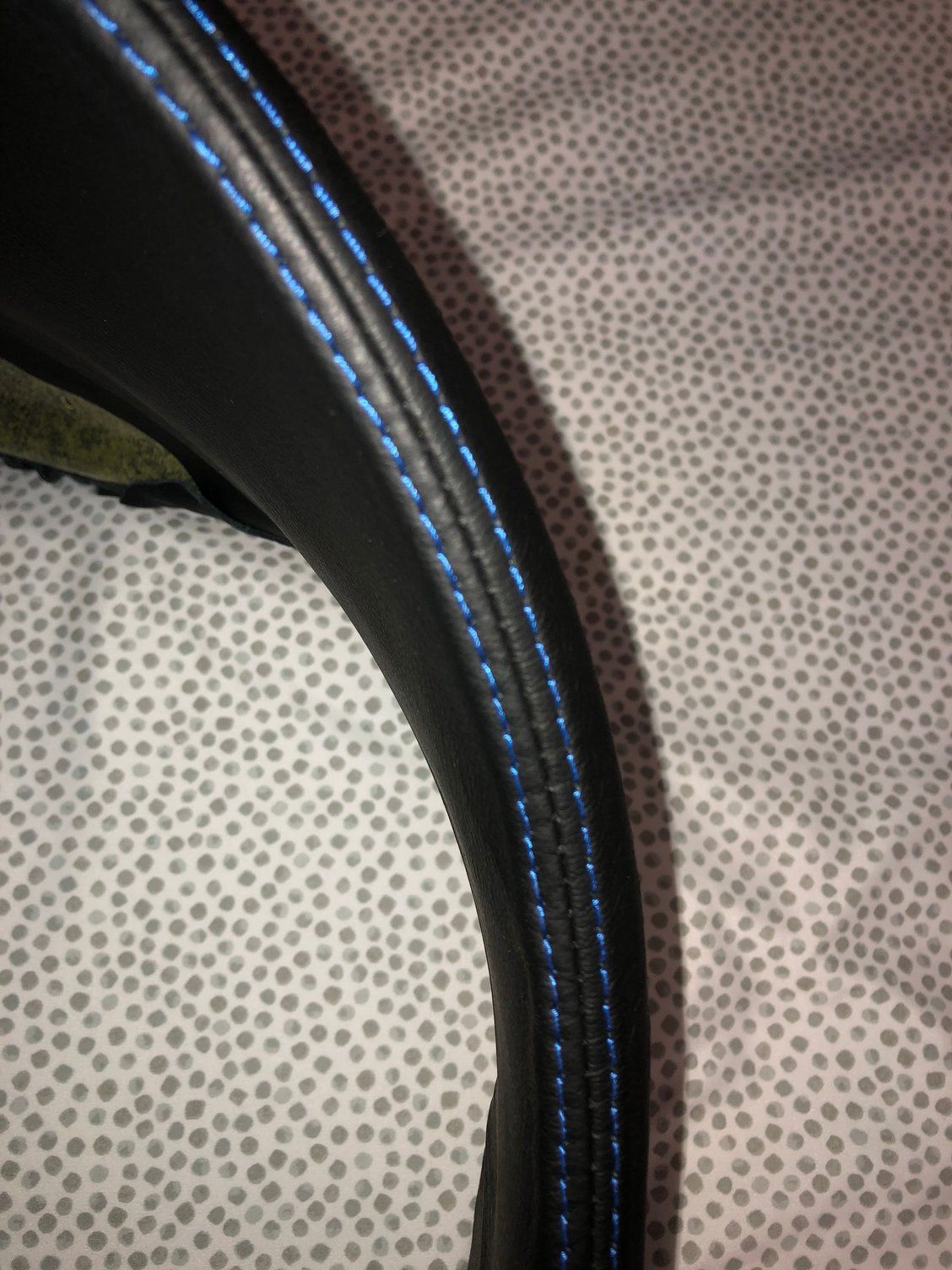

Old Jan 23, 2023 | 07:04 PM
PWPOOP's Avatar
PWPOOP
Joined: Mar 2011
Posts: 799
Likes: 473
From: Council Bluffs Iowa
I know this a little bit of an old post, but I also have to decide what to do with a dash pad on my 67. My dash is not cracked, but had some big indentations from improper storage in a barn for 20 odd years on the passenger side. I used a heat gun & Ice to get most of the indentations out, but nowhere even good enough. I tried heating it up and peeling the skin back to fix it, but I cracked the vinyl and discovered that it was glued to the padding too so i see no way to get the original skin off without damaging the heck out of the padding. Top Flight will recover for 283.99 labor & $169.99 for the skin IF "Your Dashpad Original Dash Pad. Original Dash Pad Must Be In Restorable Shape And Must Not Have The Original Skin Removed". Does a guy spend $699.99 for a new dash, spend $453.98 to get it recovered or give it a shot at 169.99 on my own? I saw a post where a Wilcox guy said to fill in the indentations & flaws with caulk & smooth with an ice cube & then recover it. I am pretty handy & can do about anything I put my mind too, but all the forums on this subject are giving me pause. Has anyone recovered the dash pad successfully. What did you end up doing JR?

I ended up having upholsterer do them with black leather with black stitching across the front edge. It does look pretty damn classy, but he meant $453.98 per side. Did not know that until I picked them up . Still worth it though.... I think.

Old Apr 17, 2023 | 01:36 PM
PWPOOP's Avatar
PWPOOP
Joined: Mar 2011
Posts: 799
Likes: 473
This is how mine turned out.
