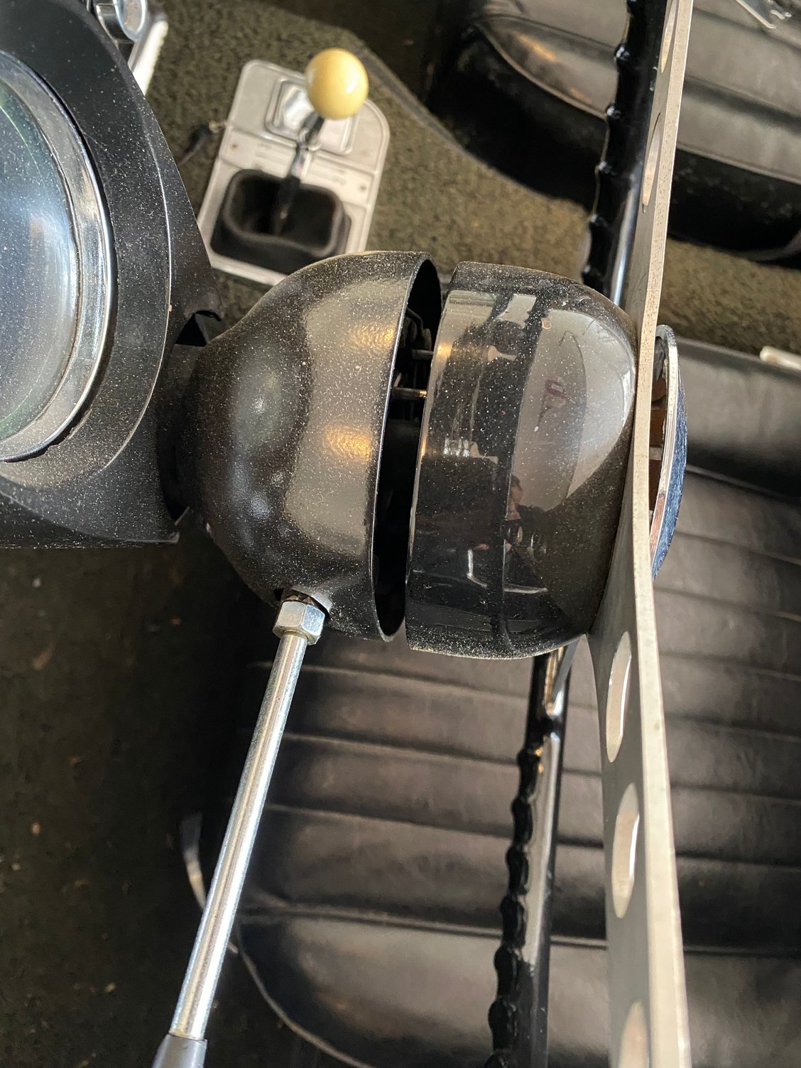

In a ‘60 that I might acquire. So having this running post as I come up with specific questions.
Appreciate the help from the experts.
On the steering wheel, this gap looks wrong.
also there is no “cancelling” click that I can tell.
you need to manually move the blinker arm to center to stop the blink.
That doesn’t seem correct.
any ideas?
thanks.

The turn signal bell is easily moved. The gap on mine is about .020".
That is also why it won't cancel, it looks like the wheel pins are too far from the bell.
That may be by design from the seller., due to some issue with the turn signals.
It is an easily fixed problem, nothing serious, it may take you a few hours to properly dial in the cancel mechanism.

Got it ... Thanks a lot.
Joe
