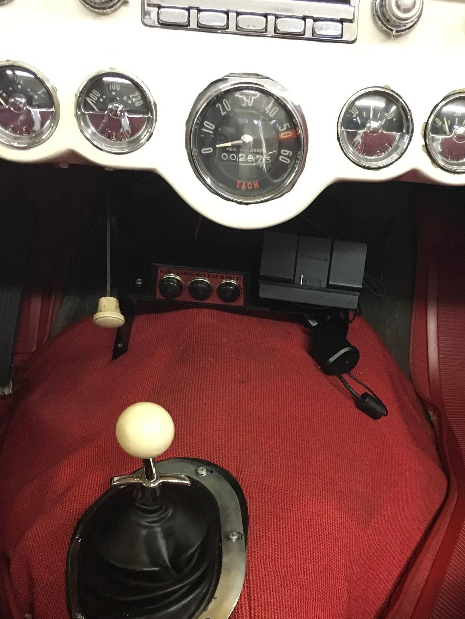

The cigarette lighters in these cars can’t handle cell phone use. I bought an adapter at NAPA, they have different varieties/sizes.
The one I have is hooked into my converted radio to power external music sources.
