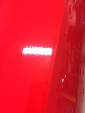

My 65 was painted 2 years ago. I was cleaning the engine compartment this week and put a Fender Gripper over the left front fender to protect the paint. When I removed the fender gripper there was a waffle-like pattern in the paint (pattern from the fender gripper). I thought no problem I'll just buff it out. So far it will not come out! I have used polish and swirl remover with my random orbital polisher without luck. There is no ceramic coating on the paint - just wax. What can (should) I try next without damaging the paint??
The pattern in the paint is visible around the light reflection - best I can do.

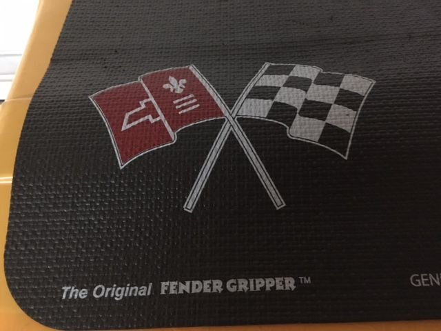

This is the fender protector. Same pattern on back side.

Try a bit of wax as that pattern is probably in the wax. If not, a clay bar with detail spray should do the trick. If neither works, I’ll be following along to learn what the pros suggest.

How long did you leave the fender 'protector' on? I can't really get a sense of the extent of the problem. Do you have another picture.
You might have experienced some off-gassing of the rubber material and my fear is it could have absorbed into the paint.

3-4 days. I was cleaning the engine compartment and installing new Wilwood master cylinder and proportioning valve. The waffle pattern usually is easily removed with detailing spray, but I think leaning on the cover may have caused the problem. I'm very reluctant to use fine rubbing compound. This was a very expensive paint job and I'm afraid I might permanently damage it.

Your clear coat should have cured harder. The pad should not have affect your clearcoat. I am afraid you are going to have to resort to sanding the clear coat with 3000 grit sandpaper then buffing it back out.
Hopefully you have a good coat of clearcoat.

Don is probably right. You might need to wet-sand and re-polish with a machine buffer starting with a medium compound and working up to a foam pad. IDK about 3k paper, 2k would be the finest I'd use ...but if you have 3k you can try that. Different guy use their own method. You should be ok. It removes so little clear...

Can you ask the painter for suggestions. I wouldn’t sand it - I would try a mild polish first. Always start with the least aggressive plan of attack first.

If I had your problem. The first thing I would do
is strip all of the wax,detail spray and polish off the
area. You can use over the counter products like
3M, or Rust O leum Wax and Tar remover or Ardex
brand. You could even use Dawn dish soap. Just make sure
the area is totally clean. You may find that you have solved
the problem.. If not then I would carefully compound the
area to remove the swirl. You may find that like a lot of us we
put too much wax/polish on our cars. And end up with too
much build up.
Good luck

After you exhaust 'cleaning' suggestions and it doesn't come out, if you don't know how to buff, yeah, I agree ask the local shop. If buffing is what's needed, it's probably a 1hr job depending on the size of repair. I've painted cars for years (in a shop and at home). LOL. Should be easy to resolve. Might want to use a different fender mat for the future.
