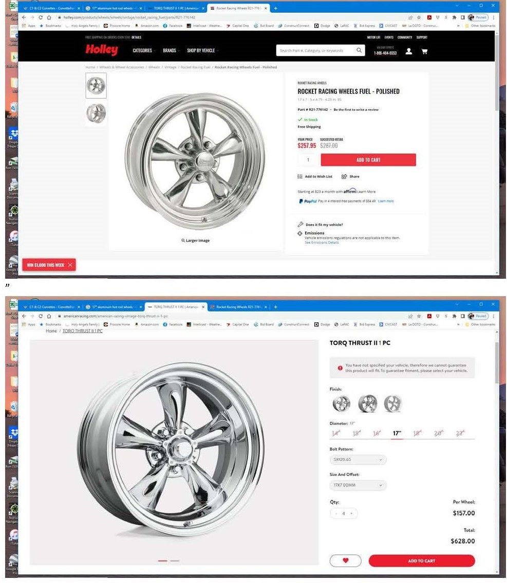

Torq thrusts are 4" back spacing and the Rockets are 4.25" back spacing (which i like better)

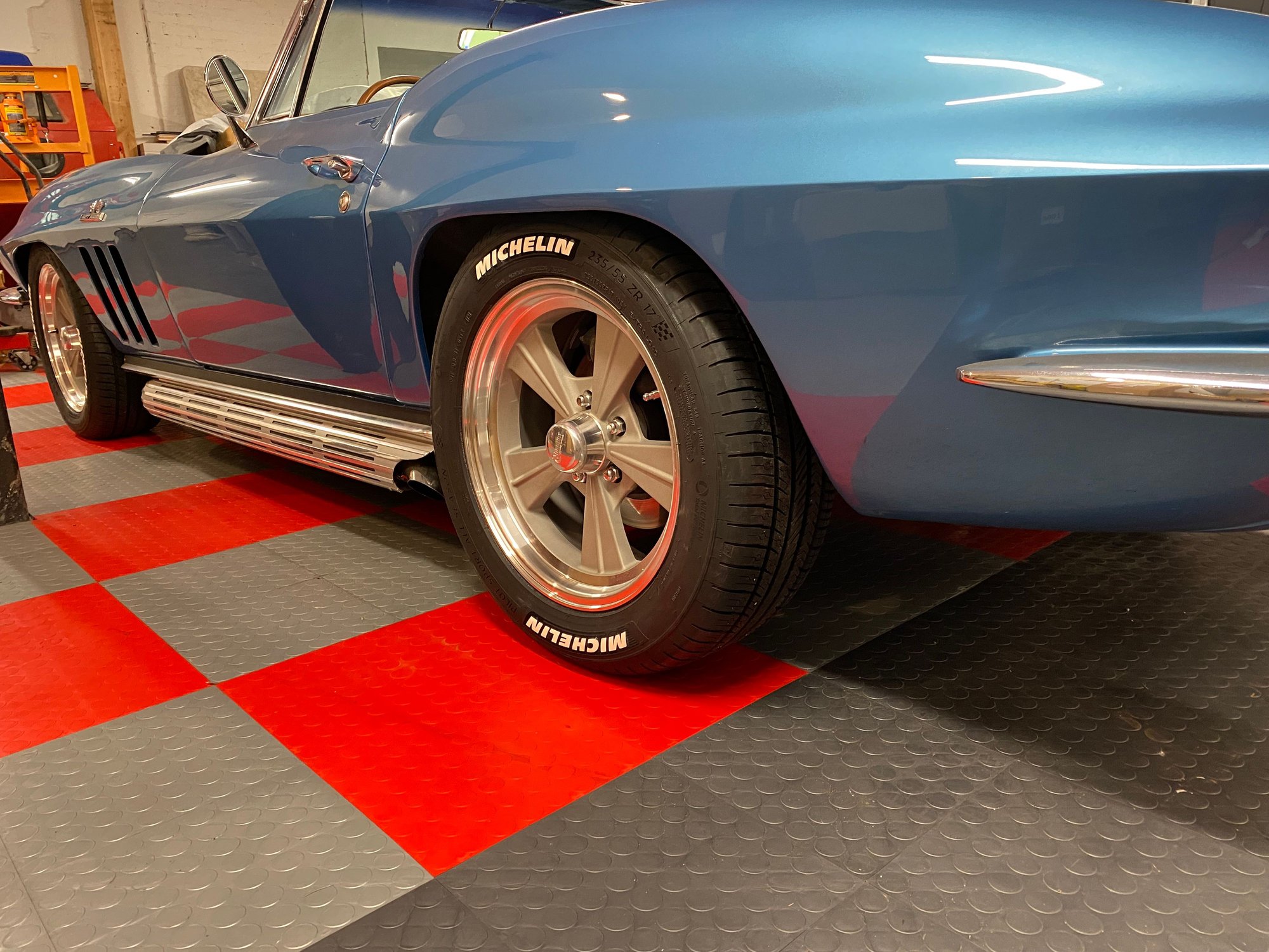

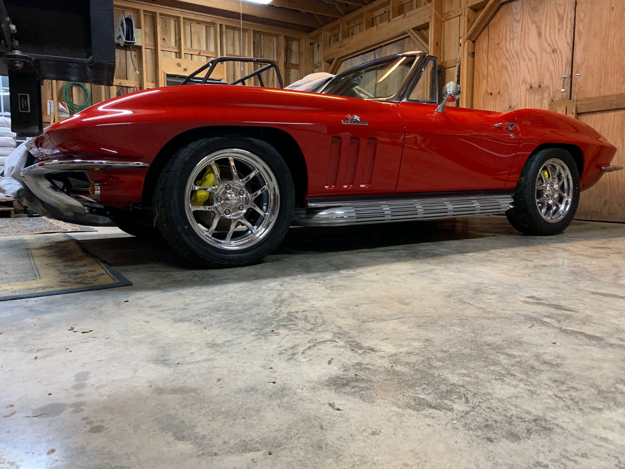

235/55-17 Michelins on 17x7 4.25 bs wheels..

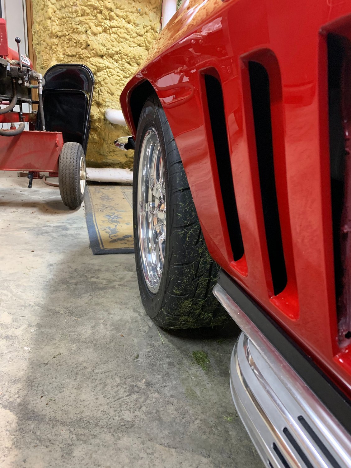

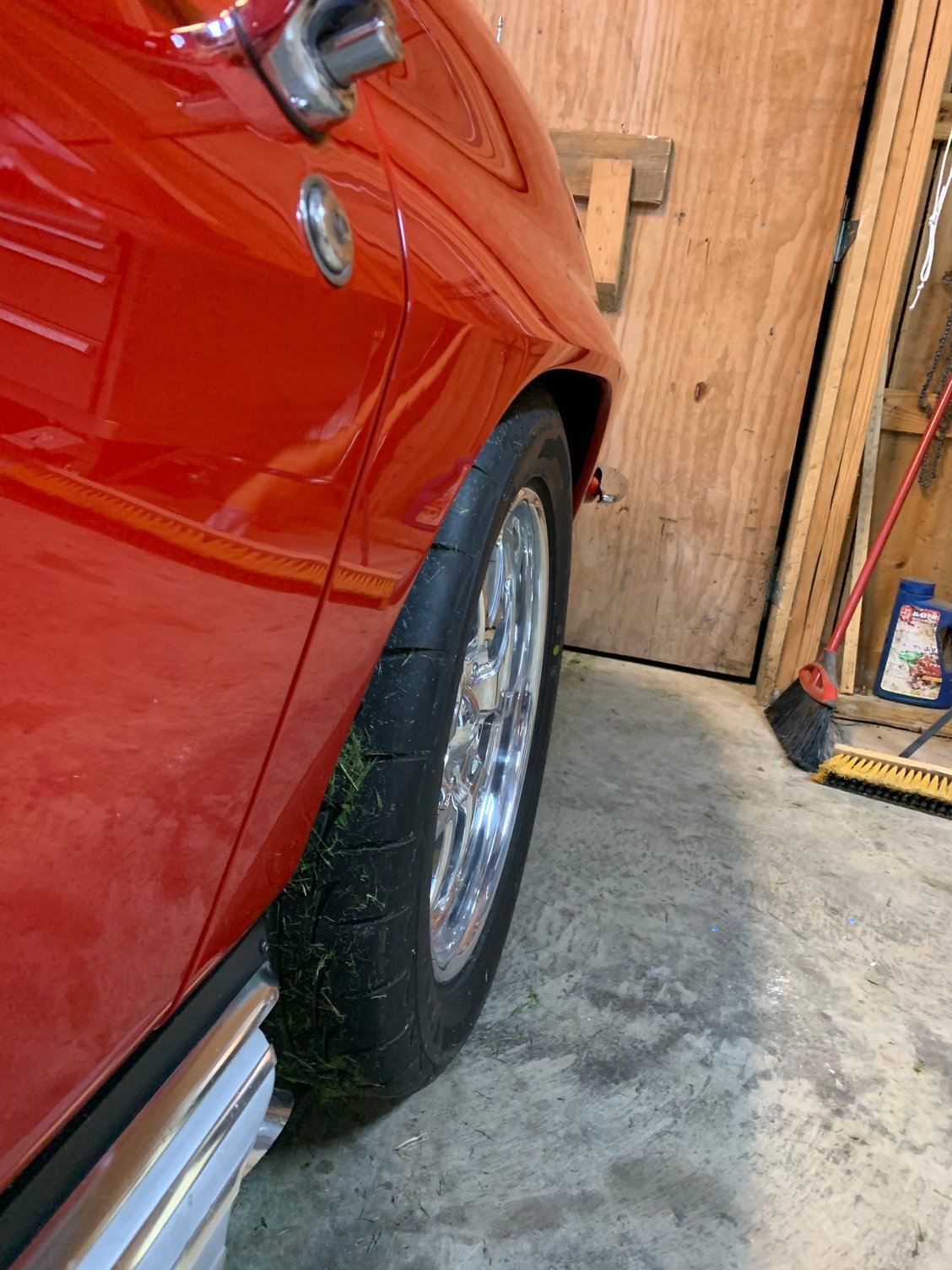

I like the stance of your car. The fronts look like they might rub the outer fender lip.
My 225s should fit just nicely.

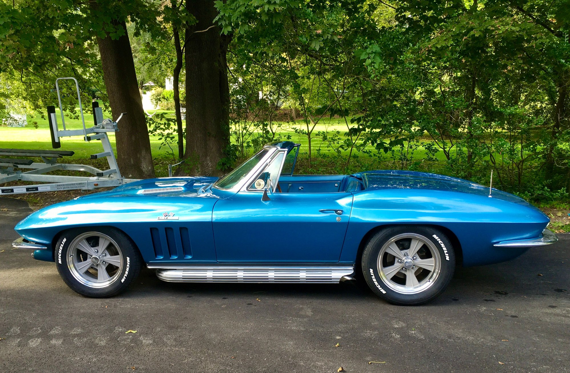

Tom Austin's Avatar
Tom Austin
Joined: Apr 2002
Posts: 3,100
Likes: 2,355
From: Allison Park, PA
I wonder if a 55 series tire would fit?
YES, they will. Mine with 225/55/17 on 17" wheels with 4" of BS!
Do you think a 17"x8" with 4.5" backspace will fit with a 245/55r17?
No rubbing other than a slight rub on the frame in front at full lock. I barely have a 1/4” clearance in the rear, so I don’t see how a 245 on an 8” rim would work. The 4.5 bs in the rear will require the parking brake cable to be relocated to he top of the TA.
Oem ride height, L72 with F41 suspension.
Perfect, I need to break out the credit card and get to shopping.
Your car looks great.
