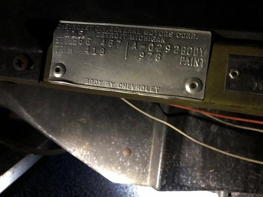

so maybe this is proof that my eyesight is going, but for a Vette that I'm viewing at, the Trim and Paint codes aren't matching the docs that I have available.
https://image.hmn.com/ixJRNsw3pSXBFH...e/88280000.jpg
Can't seem to find Trim code 418 nor Paint code 978
Could anyone help? It's advertised as a 66 convertible, black interior with what looks like dark green paint

http://www.stl-vettes.com/65Vette/tr...ag_display.htm
looks like 978 is dark blue
418 is dark blue vinyl

Ooo nice reference. Thanks for the heads up. That makes things easier.

These kits are available for all years and are free. A must have for any Corvette or other model Chevrolet owner:
See page 20 RE: Trim and Paint
https://www.gmheritagecenter.com/doc...t-Corvette.pdf
