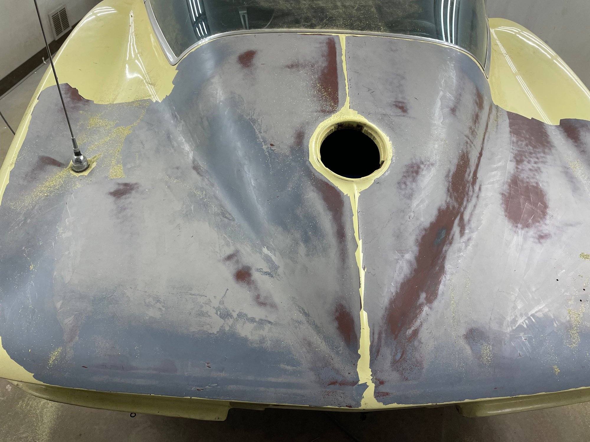

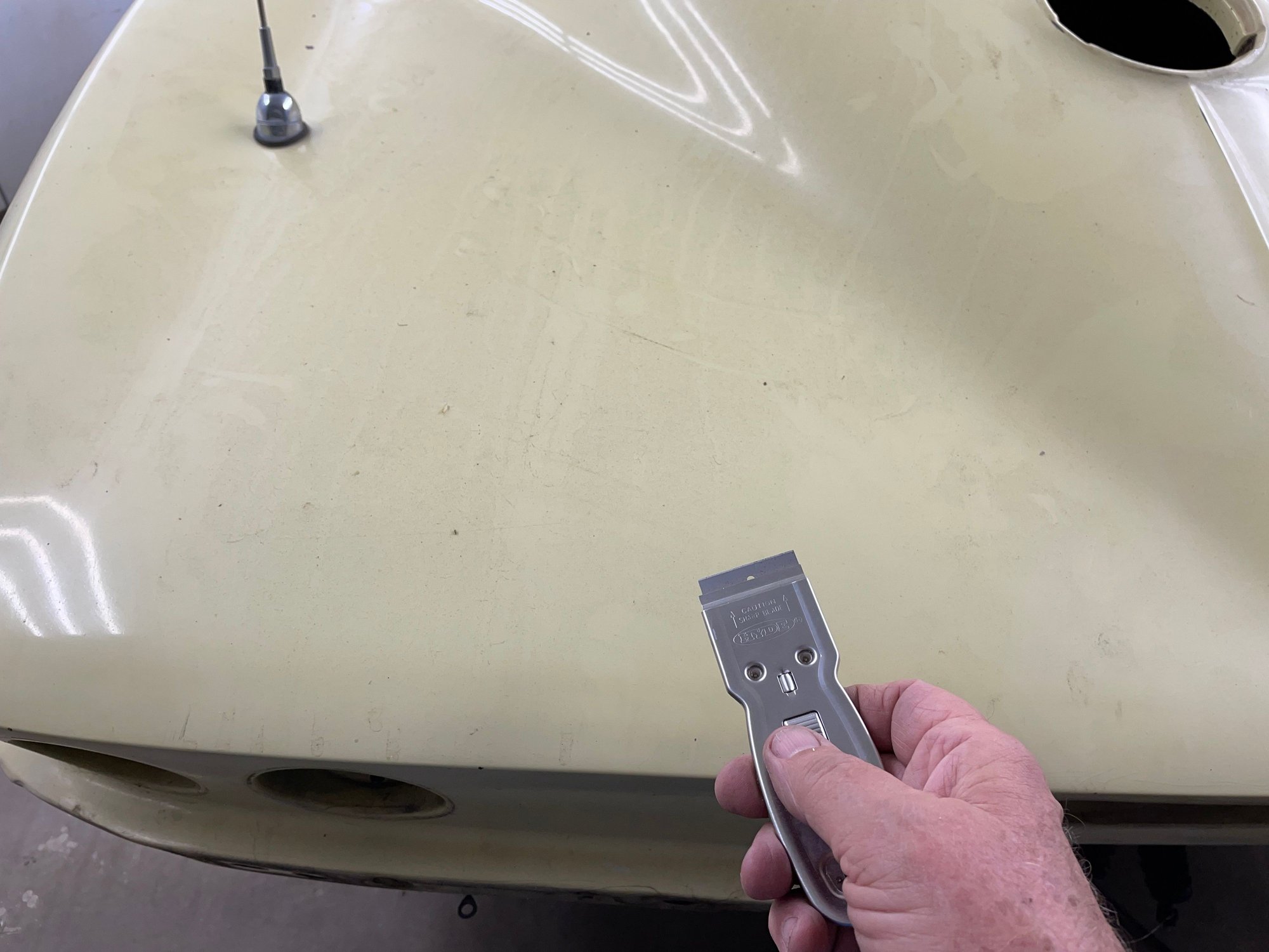

I'm using Clean Strip from Lowes. Works good on my original lacquer, don't know about repaints. I actually stripped about 80% of the car with a razor blade and used the stripper on the peaks and valleys. It took about a gallon. That is about 2 hours work with the blade.
