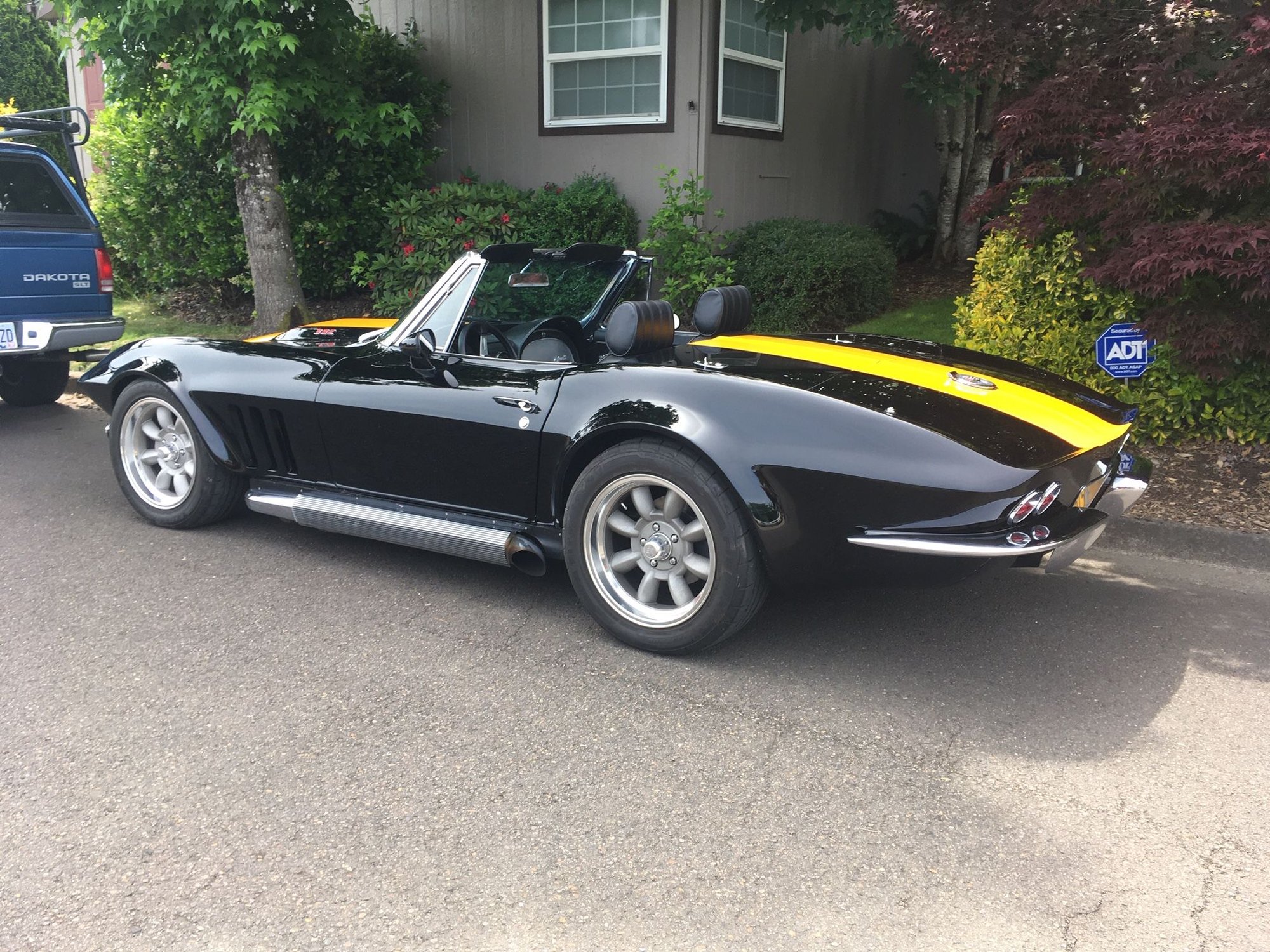

Well last week I added that clear protective sheeting to the front. A black car doesn't like bugs or rocks so this should help. Now tomorrow I'm having the rear updated to a 3.7:1 from the 3.2:1.

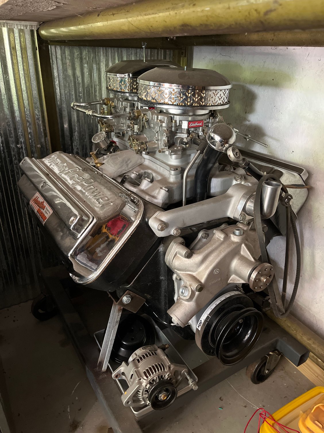

In the shop this morning. Should be done this afternoon. Ok here's the engine. Then a 5spd TEMEC and a Chrysler 8.74" rear (now getting the 3.7:1 ring and pinion) with 4 link suspension and coil over shocks.

Too Cool. I love it. But please consider at least one photo of the engine bay when posting please.

Every time i see your cool car i have go look at the motor in the corner of my shop.

Another beautiful sight sir. Thank you. I could look at that motor all day long.

Got her back from the shop yesterday. Now I have to figure out how to correct the speedometer. Looks like it's about 8 mph fast?????
Old May 26, 2022 | 02:16 PM
911Kolsen's Avatar
911Kolsen
Joined: Jun 2020
Posts: 319
Likes: 262
From: Western Oregon
Replacement gear for the speedo drive on the way from TREMEC. Ahhh do I love to drive this old girl with the top down and that old Hemi rumbling along.
While it's pretty, why is it confined to the corner of your shop - put that beauty in something...anything!

That HEMI is going in my 48 Plymouth business coupe. It’s impatiently waiting for other projects to be finished.

I am sure you have posted the specs on your Hemi before, but for those of us who missed it, could you repeat please? thank you.
Edit- in looking at the pictures of your car I can see a 392 badge like comes on the new Charger/Challengers. Cool... What mods have been done to it?

I put the 392 on the hood as a tribute to this installation. When I go to a car show I like to leave the hood down until I get questions like: "isn't that supposed to be 396? Is it a 383?". Then I pop the hood and the jaws drop, ha ha.
I haven't done much to the engine just rebuilt both Carter AFB's, replaced the twin point distributor with Pertronics. replaced the old Chrysler transmission with a TREMEC 5spd, replaced the leaf spring in the rear with 4 link suspension and coil over dual adjustable shocks. Since 65 was the first year of 4 wheel disc brakes I took the drums off the Chrysler solid axle and added aftermarket discs. Lastly I added a small rear spoiler in memory of my old 65 Vette I had 50 years ago.
