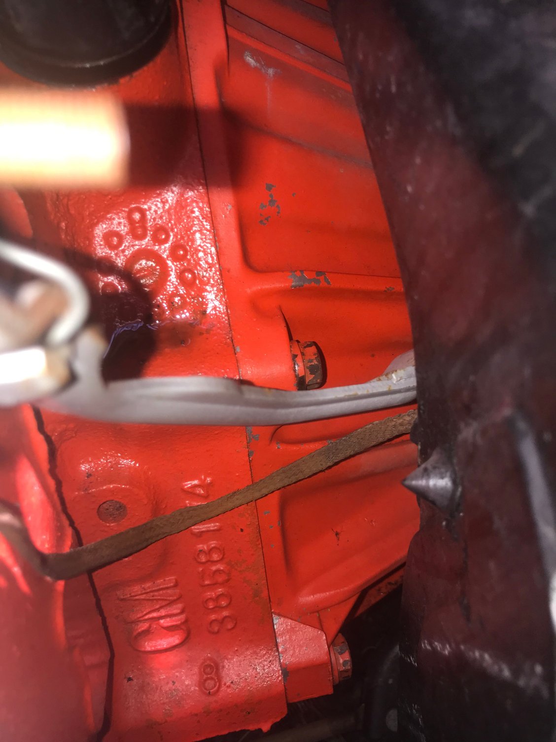

It’s in a 66 convertible, unknown heritage of motor
On block front passenger side:
DRE061790FF
(the last zero has a number 1 stamped on top of it)
DH714
<1187>
Engine casting:
3858174
would like to know if it’s 2 or 4 bolt main and anything else you can tell me
i apologize, but I tried to look up on the net and it’s confusing to me and over my pay grade
thanks to all as usual

Steve - It would really help if you could post up some pics of the stampings and castings you're talking about. The #174 casting block was only used for 66-vintage 327's, both 300 horse and 350 horse applications. There were 'no' 4-bolt 327's in production cars as far as I know. All those extra stampings sound like something a machine shop would do to identify the block to a customer.

Send pics! Especially of the pad (block front passenger side)...

Here’s what I have:

This is not a factory stamp on the pad. Most likely one from an engine rebuilder.

I agree and I suspect the "<1187>" was when the engine was rebuilt.

don't forget about the low horse passenger car and Chevelle engines

The pad finish indicates the block has been decked which would have obliterated any original stamping, so no telling what it originally was.
