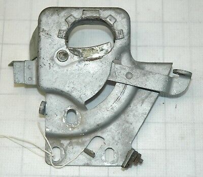

I wanted to see if anyone could help me out I have recently purchased a later vin # 1959 corvette and I do not know what the difference is with an early # vin 1960? I’m trying to purchase female hood latches for my car but I’m not sure what I should look for? 1959 or 1960?

What's on the car now?
1960 and later used this style of latch:
A lot of 1959s (all of them, for all I know), used this style:

Agree with Jim.
Very few differences between 59 and 60.. but that is one of the bigger ones!
when I purchased the car a lot of missing pieces including the hood latches, I was informed that 58 & 59 had issues with sticking when trying to open the hood and the 60-62 were a better design not sure if this is true or not though??
The early style of latches rely on friction between the latch and the male hood pin to keep the hood closed. Typically these lose their ability to grip and the hood slowly works its way open as you drive. So sticking isn't the issue. Rather, it's the loss of ability to "stick".
And yes, '60 and later latches are a better design because they don't have this problem.
