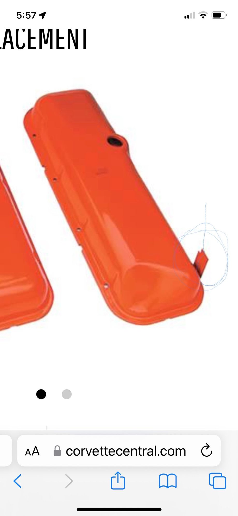

What is the protruding rear vertical bracket on these advertised 65/66 BB covers used for?

After looking online I see the passenger side 66 cover had the bracket but not the driver side. We need the experts to weigh in here.

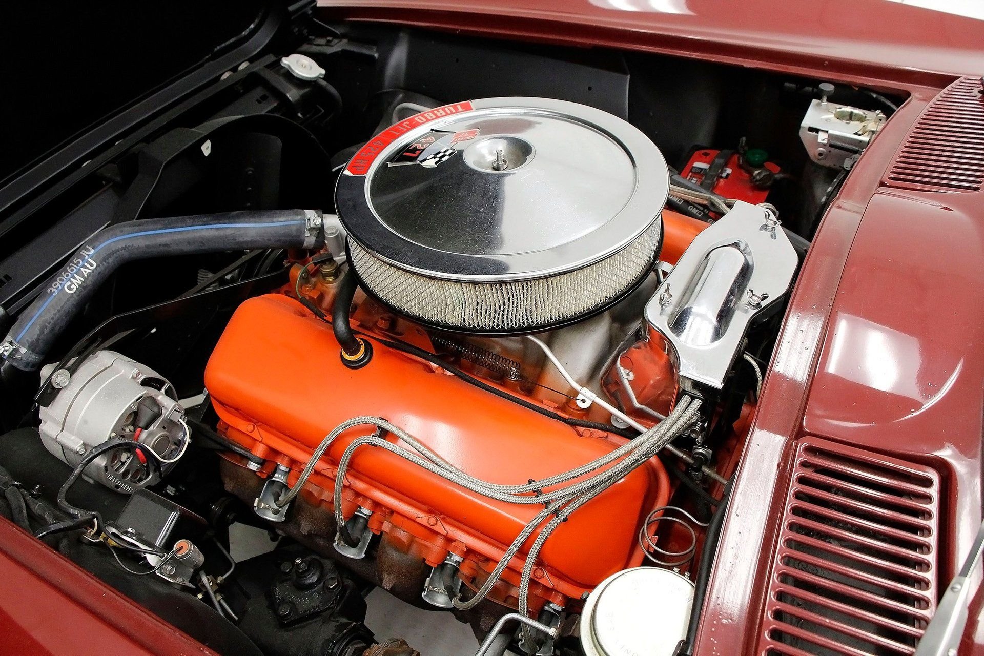

Our 66 has no tower at the rear on the drivers side. They are the original valve covers to the car.
Here are some stored photos, not my car and I’m not sure who’s car it is but it’s like what we have.

66 L72 had a wire loom bracket on the passenger side, rear end, other upper side of the cover. The plug wires fit ina 4-wire clip with the rear most qire (#8) spaced about twice the distance to #6 as between any of the other plug wires on the passenger side. No bracket on the driver side. There is a 4-wire "free floating" wire clip that is placed close to the back end of the driver side valve cover. Both covers have a tab about dead center for a two-wire clip. It was the same on my 66 Chevelle 396.
69L48Z27's car id exactly how mine is set up.

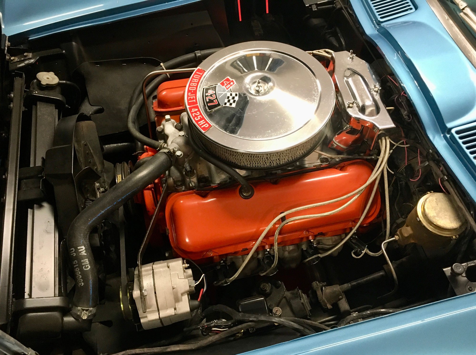

Here is my original L72.
To ‘66 BB Valve cover question

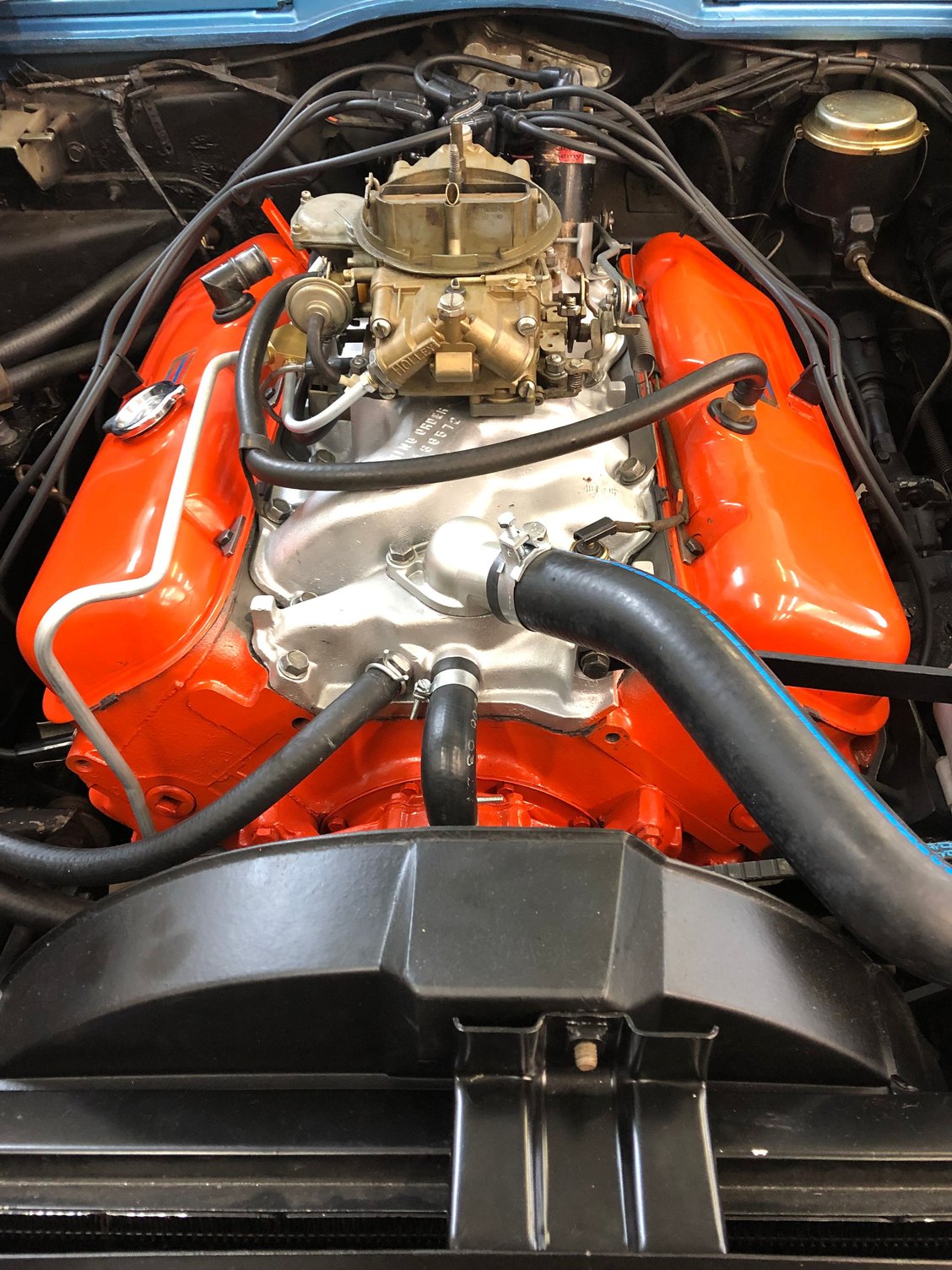

My OEM 66 Chevelle valve cover for the driver side
