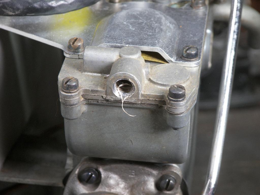

If you absolutely must use a sealant, use Teflon paste instead of tape. The tape can shred into fine threads which are capable of preventing the needle and seat from sealing. If they get into the jetting or other passages, other unpleasant results are possible.
That said, if your fittings are inverted flare or compression, do not use any sealant at all.
Following up on my recommendation to avoid using Teflon tape, particularly on fuel line fittings, here is what I found yesterday while disassembling an FI unit.
Do you really want stuff like this circulating in your fuel system?
