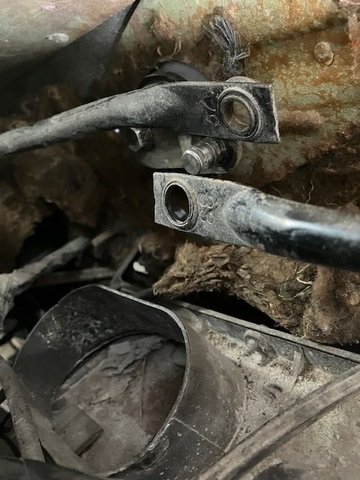

I had wiper motor rebuilt. I have it bolted to firewall and am about to hook up transmission arms. One has a bushing, one does not? I assume I need another one, but not listed in Zip or Paragon. Any ideas? Thanks!

Does one side of an arm look like it has put a ware mark on the face of the other arm? Also, does the special retainer clip have room to slide/snap on? Dennis

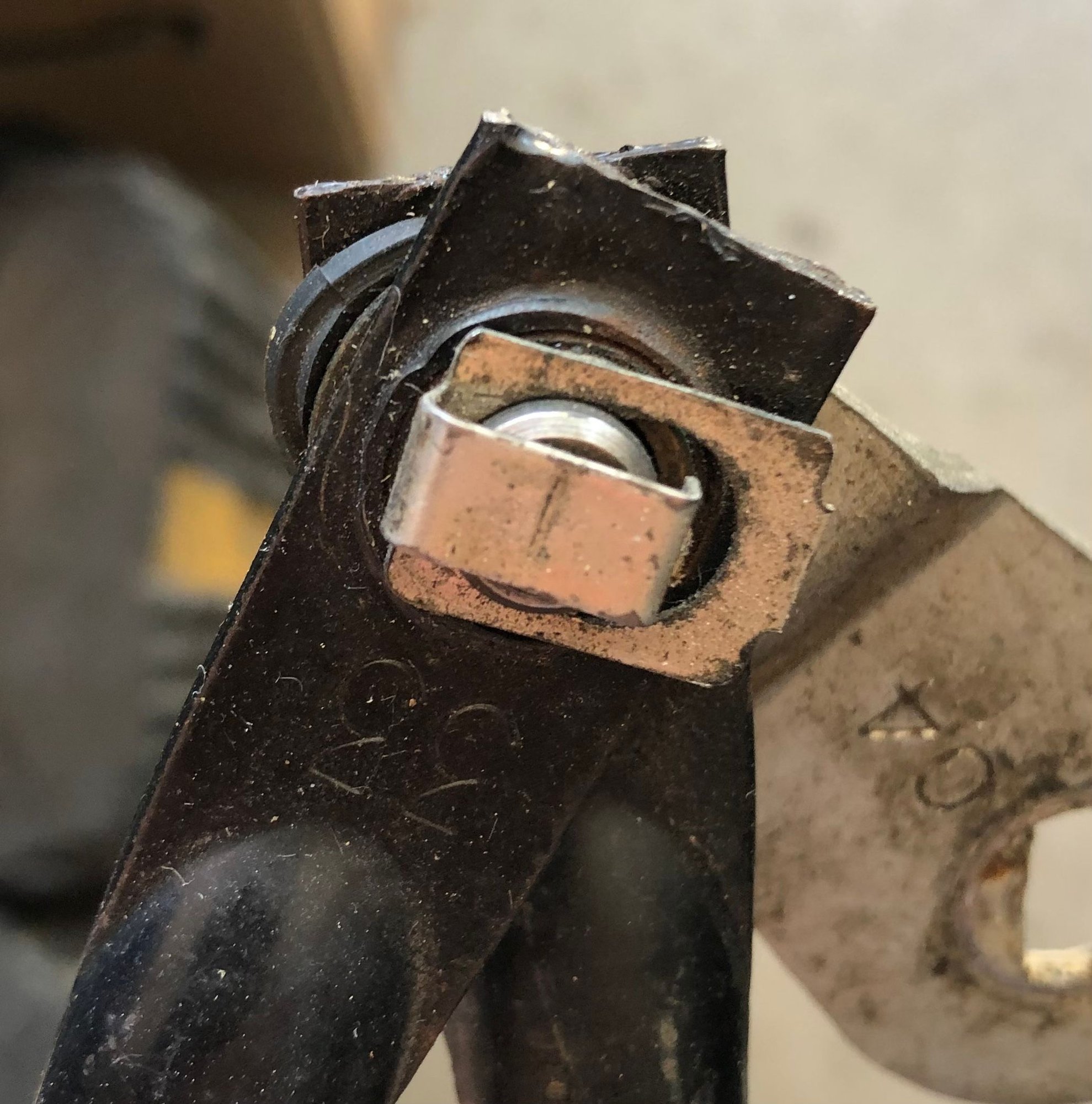

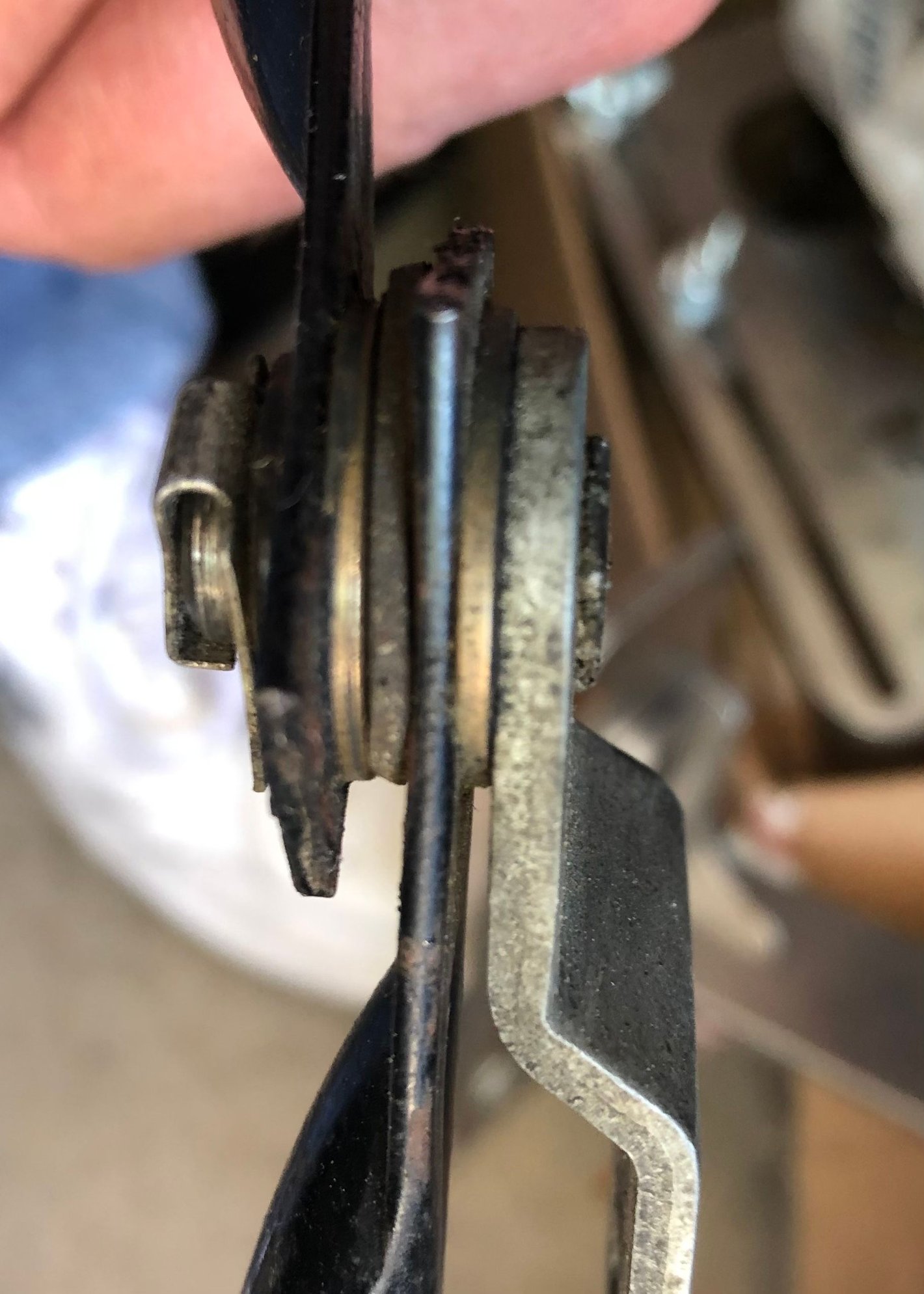

Here are some pics of my 67 wiper arms that I have not taken apart yet. Not sure where you can find another one though. I did lube the transmissions so they spin freely now.

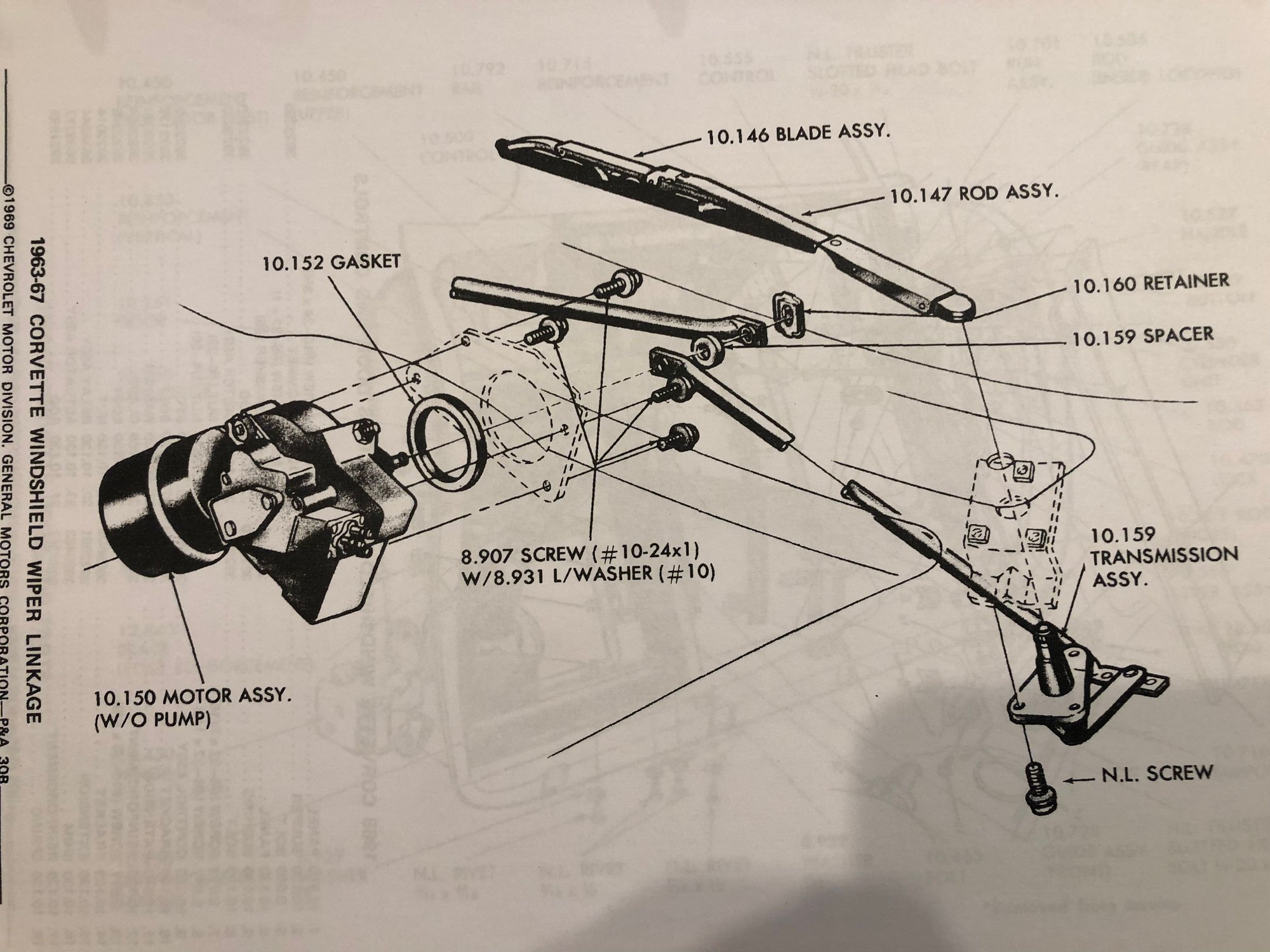

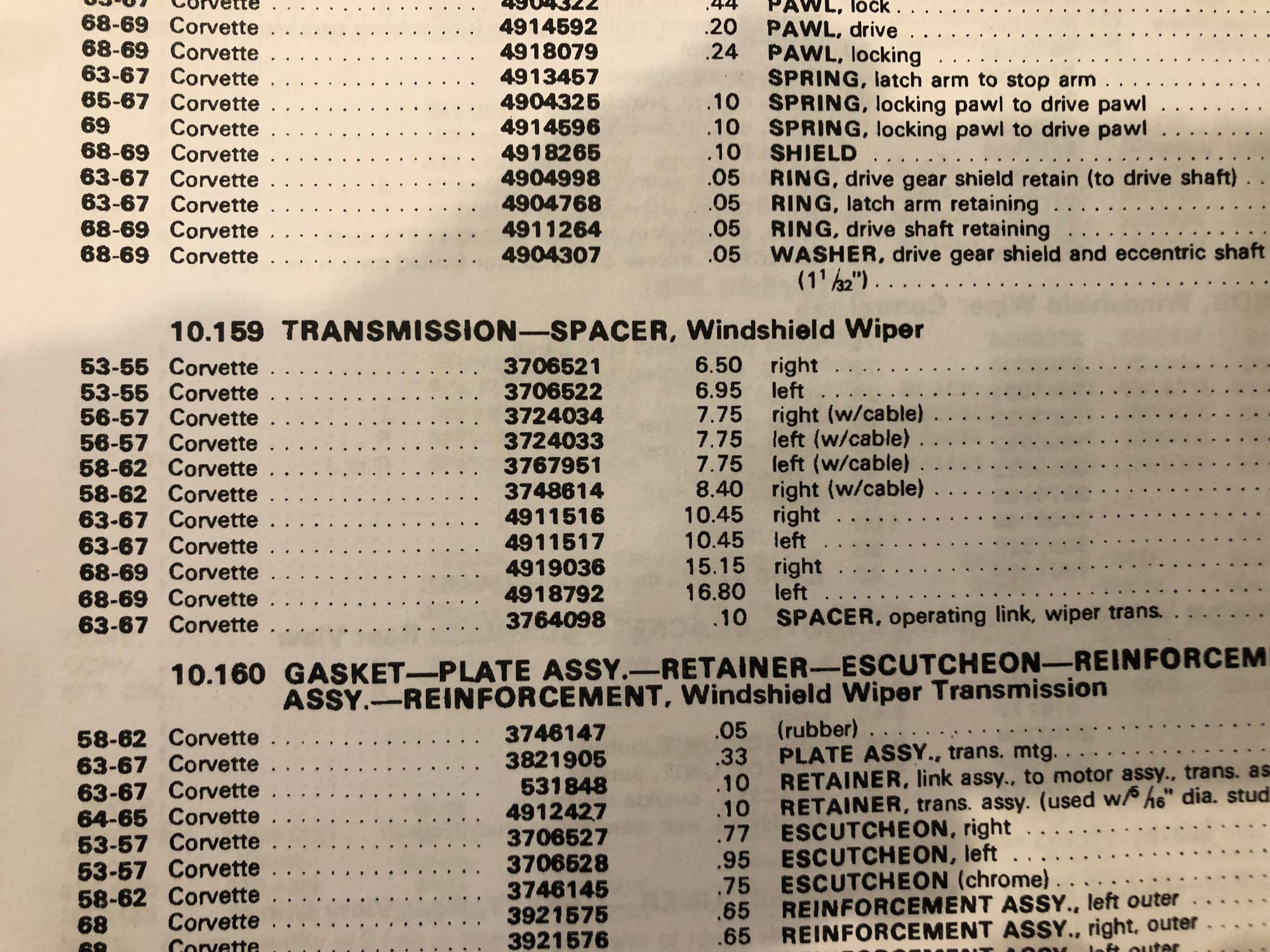

Here are the part numbers from my 53-69 catalog. They show a spacer but not the bushings. I believe paragon has the rubber spacer only. Also I will post a link to Joe’s transmission lubrication post he did if you are interested.
https://www.corvetteforum.com/forums...be-article.pdf

Thanks guys. The spacer is easy, but you can see brass on both arms in Elwood's pics. That has to be a bushing. I wonder if all chevys used it?
