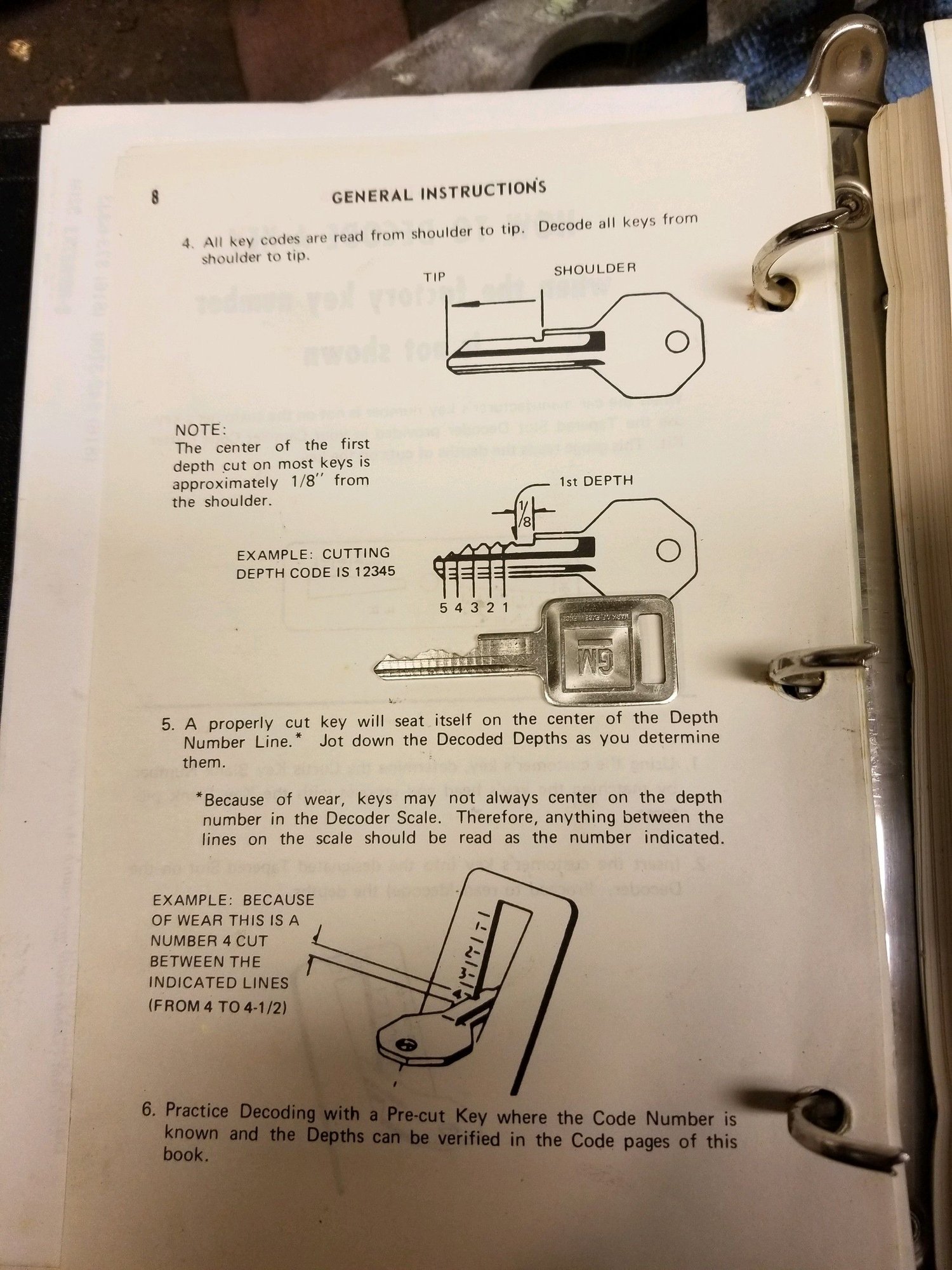

If you have a key that works, the locksmith can decode it- see below. The key I had for my 67 was "the son" of many previous keys and required a knack to turn in the ignition. Problem solved when I cut a new key to the code.
