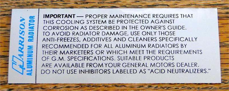

I'm not affiliated with them anymore but I always recommended the same one flyboh purchased. 32-1249063M The 2 in the code denotes the Black Ice finish, which really makes the radiator look better than the natural aluminum. The 4 in the code denotes the fatter (1.25") tubes and this model will cool just about as good as the original concourse radiator. You could even buy one of those foil Harrison stickers and everyone would be fooled.
