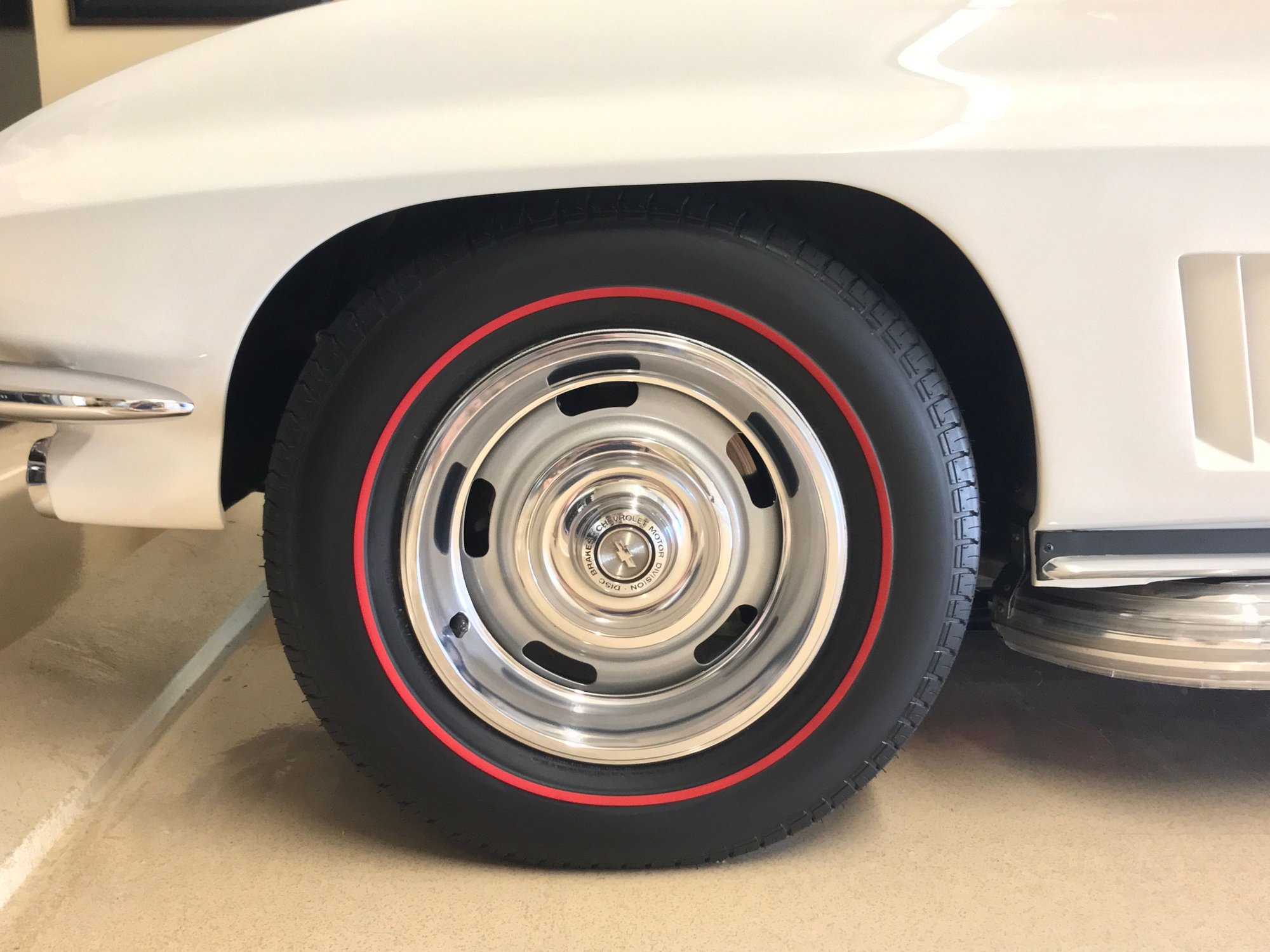

Can a few2 C2 friends measure the space they have from their front tire to lower front fender lip for me. I have 1.5" when wheels are straight, but I am getting very close to hitting the lower fender lip when either wheel is turned inward (passenger front tire on a left handed turn radius or vice versa for the other side). I have a 66 convertible riding on 205/75/15 radials, on stock offset, direct bolt on KOs. Everything should be ok with these tires yet I have this issue. The car is square. Same exact spacing on the left front as well. Car has been aligned but may need a caster adjustment to "buy me" a 1/8" or more if possible? Main question here is whether 1.5", or about 2 finger spacing, the norm? Thanks, Steve.

I just measured 1 13/16" on the driver side and 2 3/8" on the passenger side, wheels straight ahead, 215/70/15 tires. Never hit the fender lip, although the driver side does rub the frame rail on LH turns at full lock.

Thx Avispa.....helpful...I had 215/70s but took them off as they were causing some top of fender lip close tolerances on the rear. I need 1/4 of an inch to feel safe...interested in hearing how I can gain that distance upfront without changing tires to super skinny 205/70s.

2" driver's side. 2 1/4" passenger side. 215/70R15 Diamondback Redlines.

The 70s give you about 1/8th of an inch on each side over the taller 75s....still, 2 inches is great spacing.....not sure why I have only 1.5" on either side but 50 years, body work, factory differences, spring sag, alignment differences, etc etc can easily contribute to a 1/4 or 1/2 inch difference......thank you
