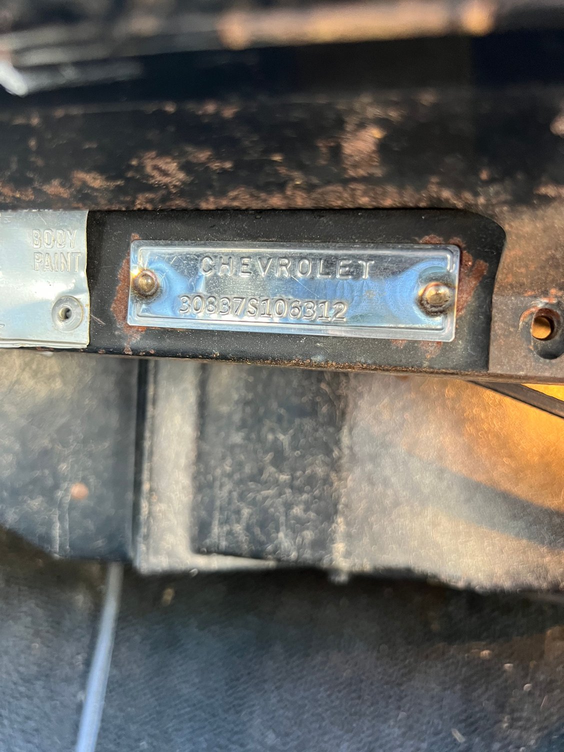

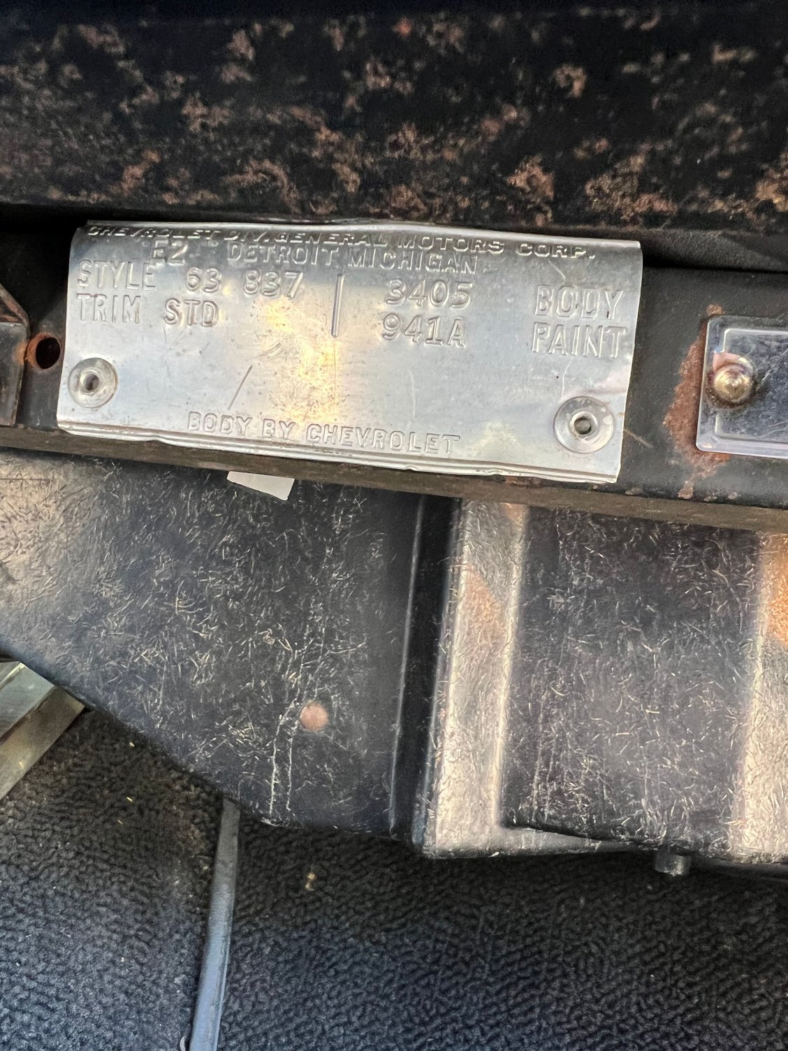

Do these tags look legit ? How can you tell what options (like power windows ext) does a 1963 have ?

The tags look OK to me. All you can tell from them is the build date (E2), black vinyl interior (STD), Sebring Silver paint (941) and which body number. The tags don't show which options it may have. Good luck!

A better quality (sharper) Trim Tag photo would help. Font issues with replacement trim tags are subtle and a much clearer photo is in order.

To add the above comments, if you have concerns about the VIN tag and how it is attached, the earlier years used spot welds instead of rosette rivets to attach the VIN tag to the Z bar.as this one is.

Those tags look perfectly legit to me

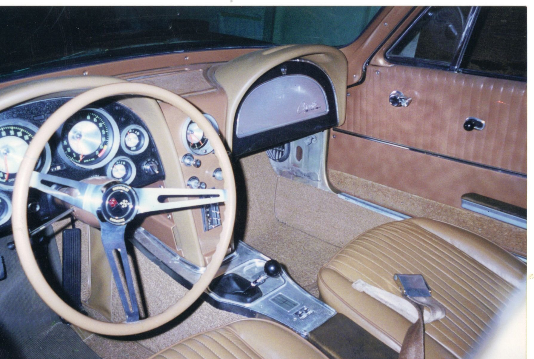

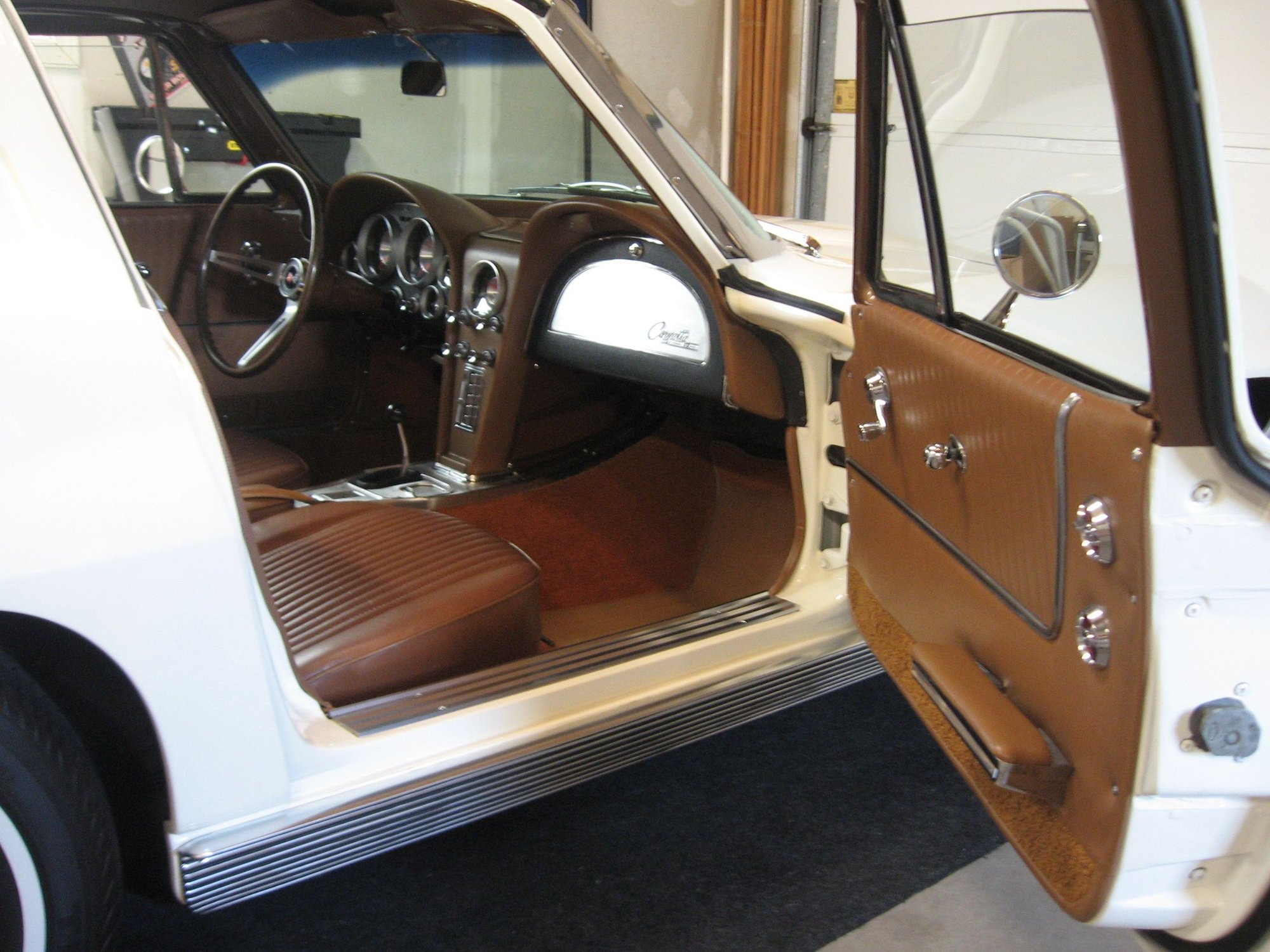

if original door panels, may
be a date that lines up with the rest of the parts and build date. My 63 coupe has P/W . the console, wiring, unique door panels, conduit to protect wires from door. check date on motors.
of course all variable may be added or parts replaced. No ecl code on my trim tag. other than saddle saddle leather code 932a. Think in terms of constellation, other options may suggest PW also added. All circumstantial.

On the original posters trim tag one thing for certain the car could not come with air conditioning. The car is too early they didn’t start producing air conditioning till late in the model year.
