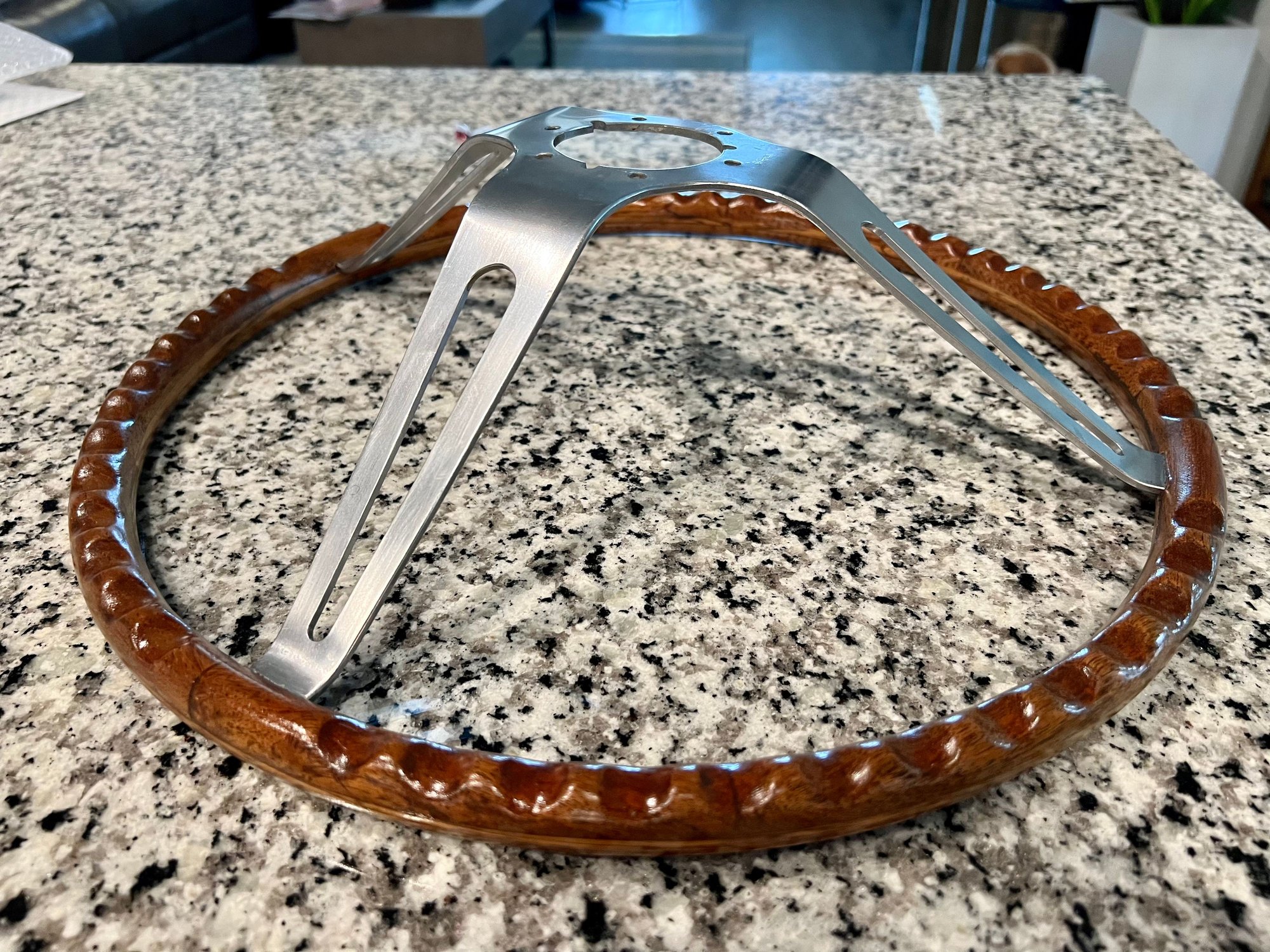

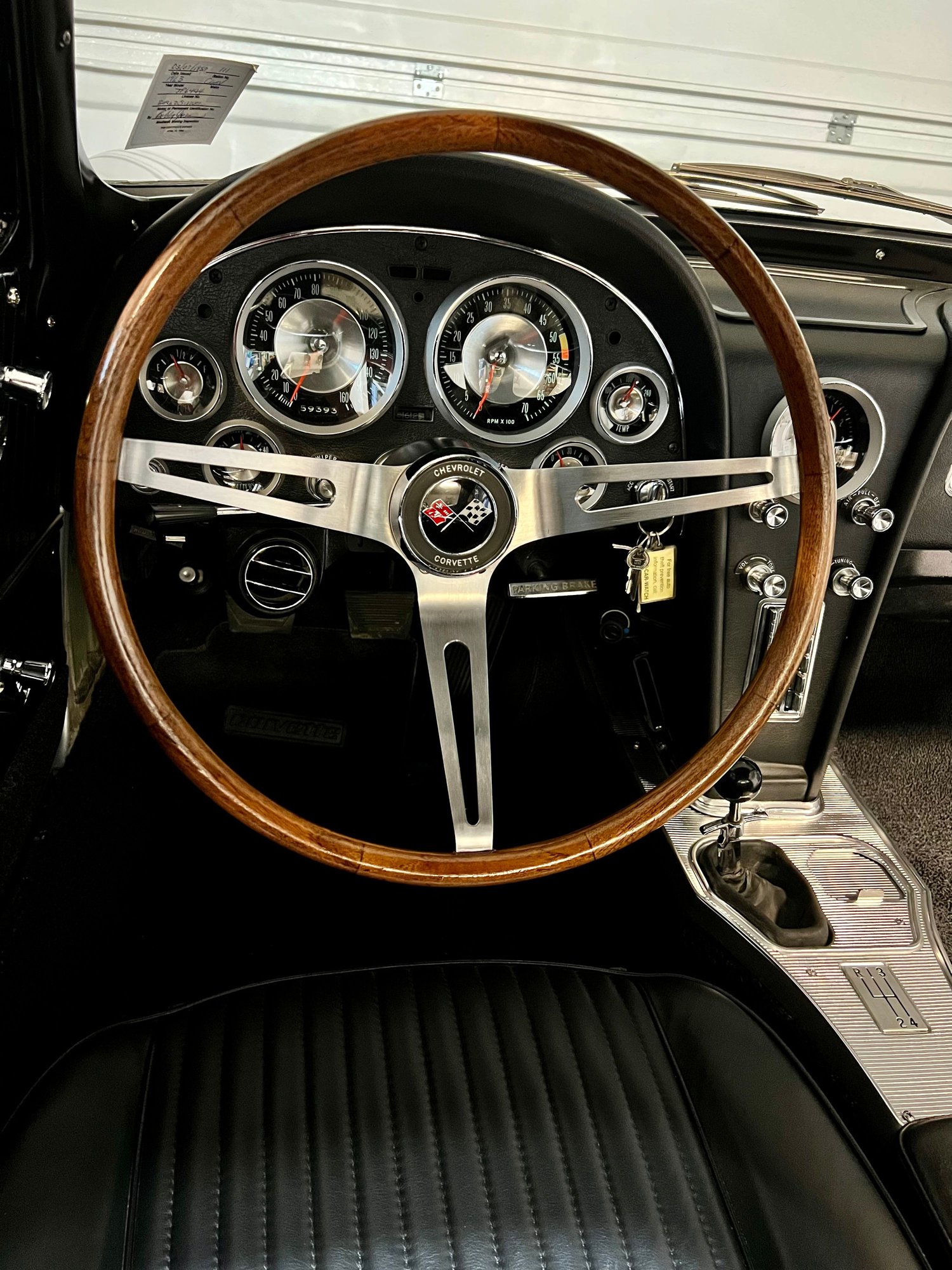

People have different ideas on what to use, or what the factory used to seal teak wheels. For me, I prefer a water-based clear acrylic; (never use oil based). It dries fairly fast and is available in a spray or 4oz. can for hand application. I blue tape the entire front and back of the spokes, and rattle can spray 2-3 light coats to get a uniform finish.. Others may have their preferred refinishing technique, and as long as it’s not an oil based product, it’s just a matter of personal choice. After owning and refinishing a few wheels on and off for forty years, this method seems to meet my needs. To me, vanish can add a little more warmth to the wheel, and to my taste, the teak in and of itself is already a fairly warm toned wood. It’s your wheel, so if you want, experiment a little and see what you like. I’ll attach a couple of photos. You will ready see that I prefer a glossy finish, similar to Mike Lampert wheels.. if thats not you thing, a couple passes of 0000 steel wool will knock it down a tad. As a side note, these photos were taken right after refinishing, and now after a couple of months, the seen as settled down a little and is not an intense of a gloss. To each, his own.
Good Luck,
Mike
