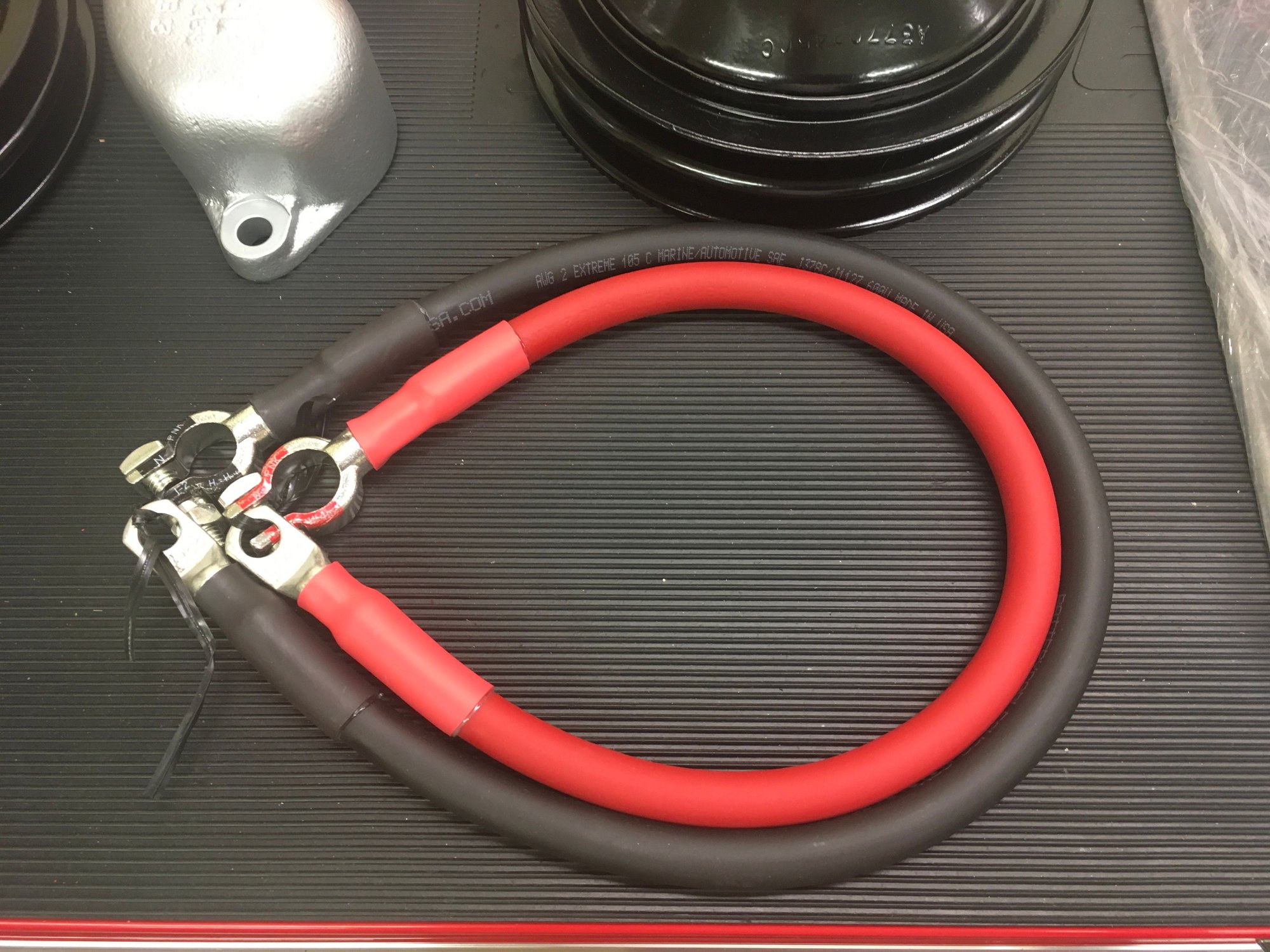

Thanks Mike, yes I did already order them. As I still have not discovered the origin of my mysterious 1.6 amp parasitic draw my work around was to use a FAA certified master power relay. That is now in the circuit between the battery and the starter. Ordering from those guys afforded me the opportunity to specify the exact lengths I needed at 2 AWG and the specific ends I needed to interface with the relay and starter posts. Couple of days later they were here. Should have them installed today and then maybe, god help me, I'll get some driving in before the snow fly's around here.
