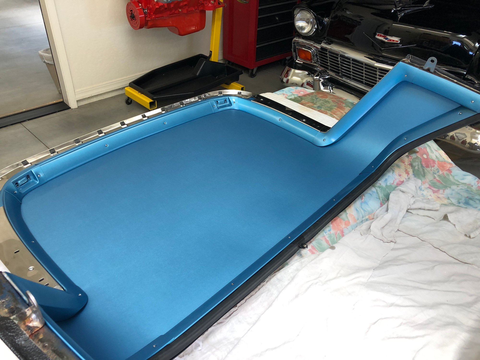

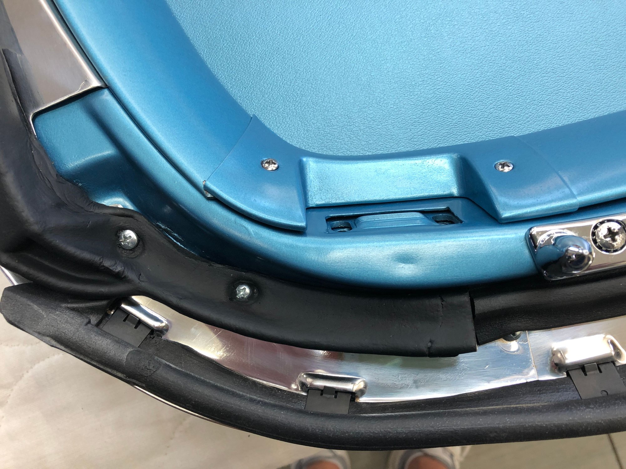

The 66 L72 I bought in June '21 had a body-off done to it by the previous owner way back in the early 90's. He still had the paint he used then and that came with the car.
When he moved from New Jersey to The Villages in central Florida, he figured he'd never need the aux hardtop so he sold it off.
I like having both tops and bought one in need of work from a fellow Forum Member out in Pasadena. It happened to be a 67 vintage top and had the Black Vinyl covering which I like.
The headliner/rear window/weatherstripping was all shot and the interior trim had been rattle can painted black but apparently been Bright Blue to begin with and Bright Blue is the color of my interior.

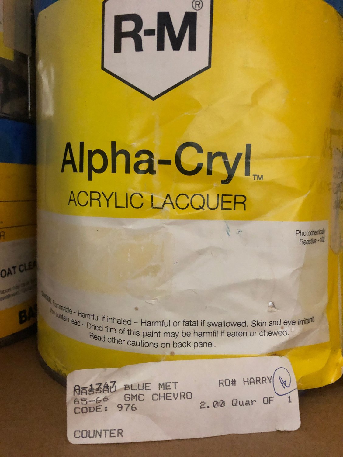

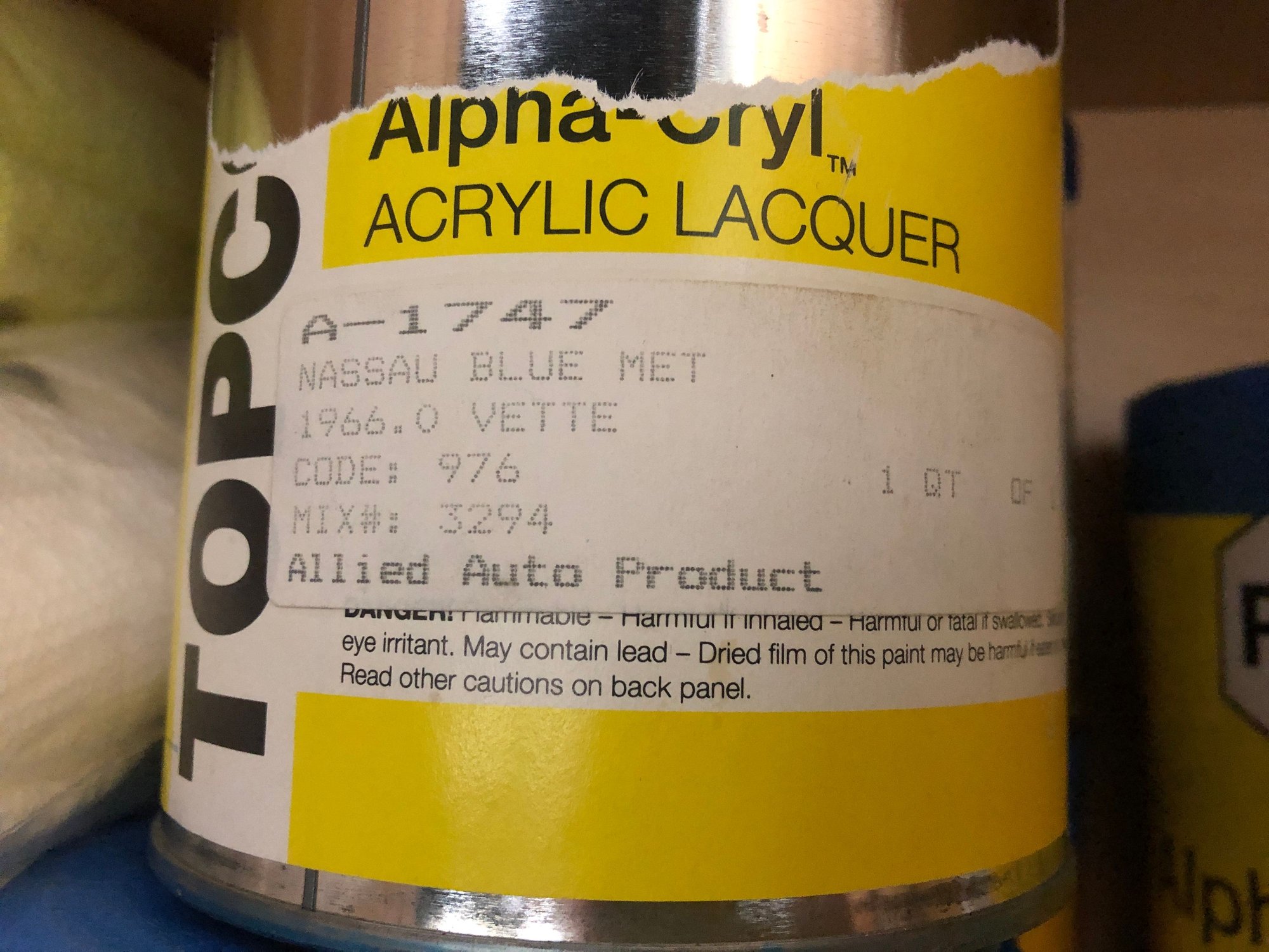

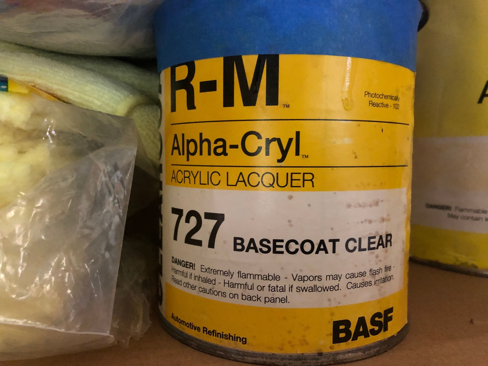

I used the paint he had leftover and it turned out decent. Unfortunately, the codes off this R-M Acrylic Lacquer Paint probably won't be of any help to you due to how old it is but thought I'd throw this out there anyway. I did not use the Clear.
