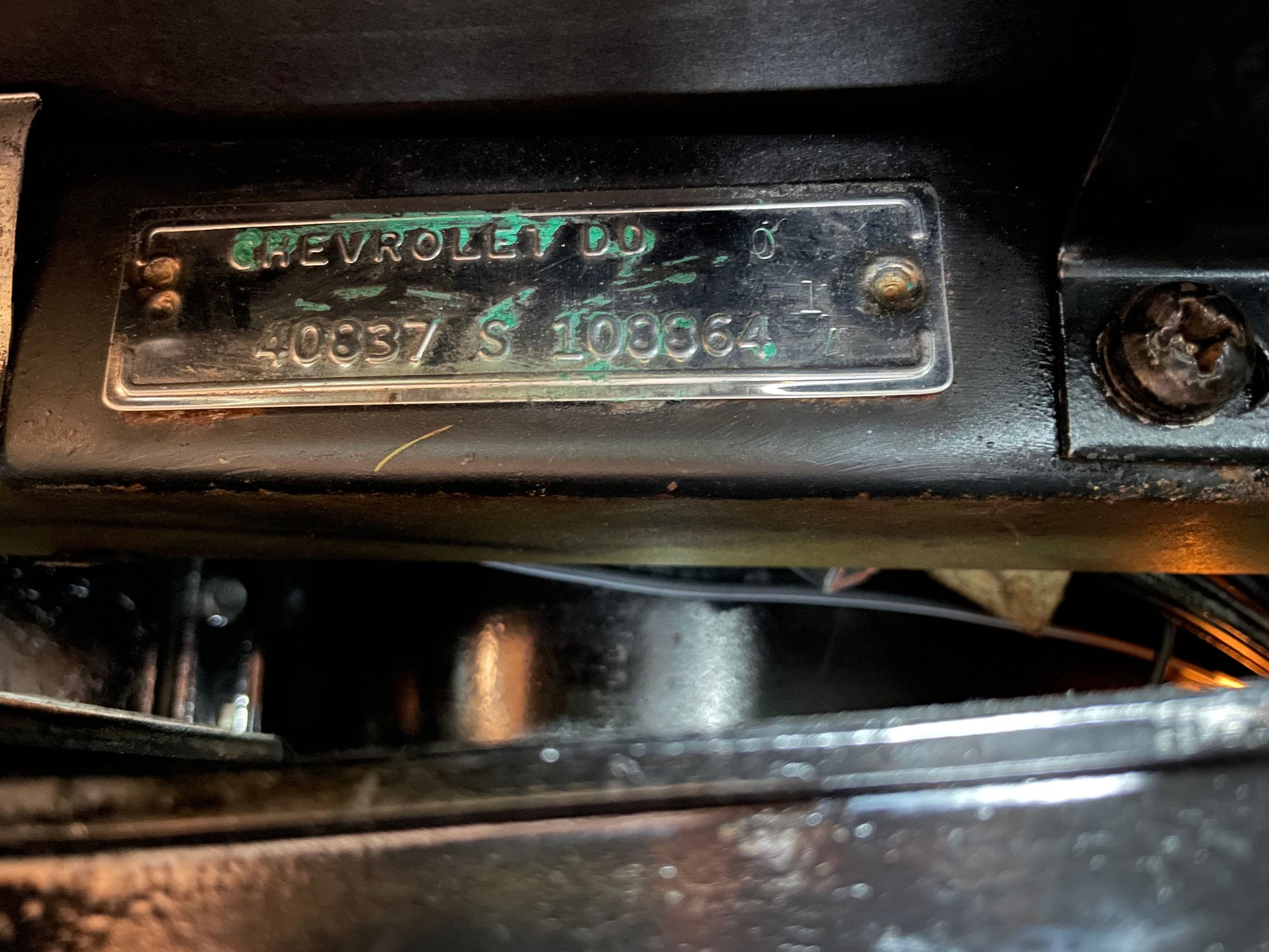

Hi Guys
I just got this 64 coupe with a 327
I've tried to figure out the engine code without any luck.
its F1227R and that’s it
The other number on the block is 3782870
any one who can explain this
Thanks Jesper
Denmark

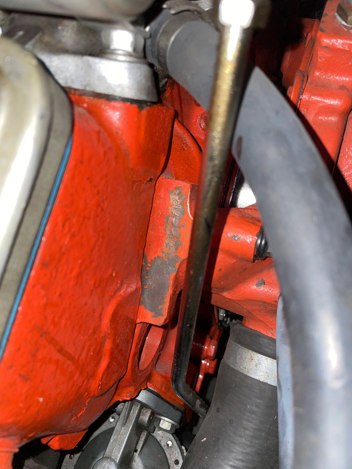

What is the VIN that’s stamped on the pad? Show us a picture.
typically low hp engines did not have the VIN (except Corvettes), until the late 60’s, 1968…

Old Sep 30, 2022 | 02:32 PM
ambolten's Avatar
ambolten
Navigator
Joined: Aug 2022
Posts: 9
Old Sep 30, 2022 | 02:33 PM
ambolten's Avatar
ambolten
Navigator
Joined: Aug 2022
Posts: 9
Not sure if you can see it
I’ll take a new one tomorrow
Old Sep 30, 2022 | 02:35 PM
ambolten's Avatar
ambolten
Navigator
Joined: Aug 2022
Posts: 9
Old Sep 30, 2022 | 03:16 PM
tuxnharley's Avatar
tuxnharley
Joined: Aug 2004
Posts: 15,306
Likes: 2,263
From: NorCal
No VIN on engine stamp pad, indicates that it is not an original Corvette engine.
