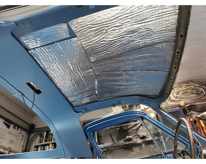

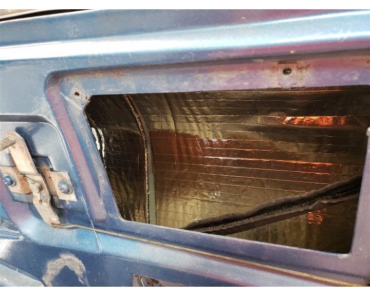

I'm insulating the interior and firewall of my 65 and looking for any photos you may have taken after insulating.

I can offer these from when I insulated my '65 coupe a couple years ago. I thought I had a better pic of the firewall area but I guess I don't, sorry. I used a foil topped thin foam rubber with a self adhesive back. Very nice to work with. Firewall area I just shaped and cut then stuck in place. Managed to get pretty much the whole thing covered without too much grief.
Vent doors remove easily. Check the pivot pins, look for the spring and push that pin towards the center of the vent door.
Floor and firewall area
Rear compartment
Roof
Doors
Cheers, Greg
