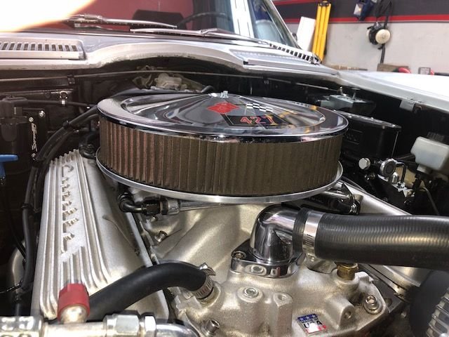

From: B.C., Canada
With my BP engine, one goal was also to retain the stock '63 hood. Like many projects, for me it was a "learn as you go." Some things work....some things don't. I was already running a Holley HP FI system which, when installed, luckily sat lower that the stock carb. Along with a different profile aluminum intake manifold (EPS), and drop-down air cleaner base, I was able to retain the stock '63 Corvette hood without modification. I was also
able to run a good sized air cleaner (3"). The only draw back was the lower intake manifold which I may or may not have had to do? I may have been able to go with the taller intake if I was willing to thin down the air cleaner height. But in the end, I happy how it turned out.
