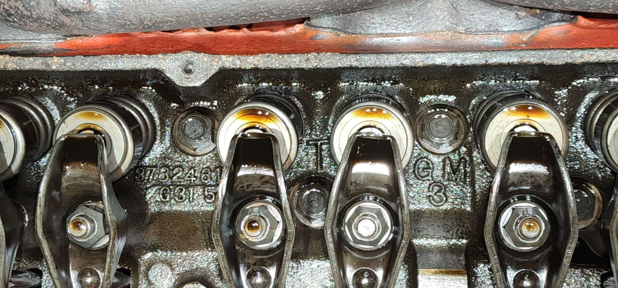

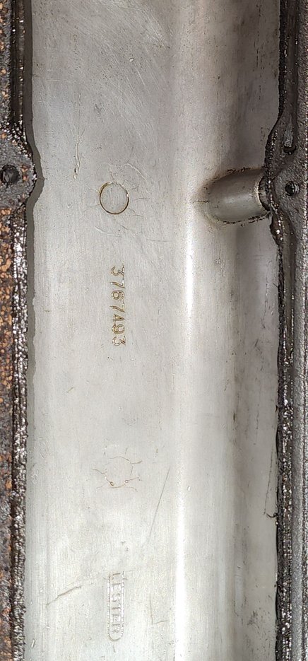

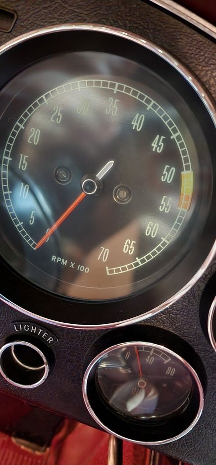

@GUSTO14 Man thanks for sticking with me on this. So I pulled the valve cover and snapped some shots. I got this car in May when my dad passed. Never been a car guy and now I'm hooked. So check these out and let me know what you see... and THANK YOU!
Tach
VIN and Something
Passenger Side
3782461 G31 5
3782461 GM 3
inside valve cover 3767493

Just a note on the aluminum valve covers. They are correct for the year but not a 300 HP engine. They are in nice shape and don't have the casting flaw.
Only the higher performance engines had them. Take care of them as they are valuable.

If it is the original engine the pad in front of the passenger side head will have the numbers that tell the information .
Since we know the engine is not original it is hard to know. Your heads seem to be correct for a 65 engine, This suggests that the heads could be original.

CAR was built in the first few days of September 1964.
The engine shown has heads (and I believe block) that were cast in July 1965.
Engine should be for a 1966 model car.............as suggested in Post #5.
Larry

Larry is correct, the HCH suffix indicates the block is a 275 hp, 327 used in a 1966 Chevrolet passenger car. The 275 hp engine was rated at 300hp when installed in the Corvette. I've heard this was attributed to the exhaust system in the Corvette and also that Chevrolet might have wanted it rated higher than the passenger car engine so the numbers were adjusted accordingly. Bottom line is they were essentially the same engine.
Your tachometer redline also indicates it goes with a 300hp 327, as do the cylinder heads. Based on all of that there is no reason yet identified to believe your car didn't come with a 300hp 327. Unless there is something wrong with the engine you have, or you just want to change it to something else, I'd say the engine you have is about as close to the original as you're going to get without a lot more information of the cars history and a whole lot of money.

The tach pic shows the oil pressure gauge might have been changed out at one point in time.
-Snuff

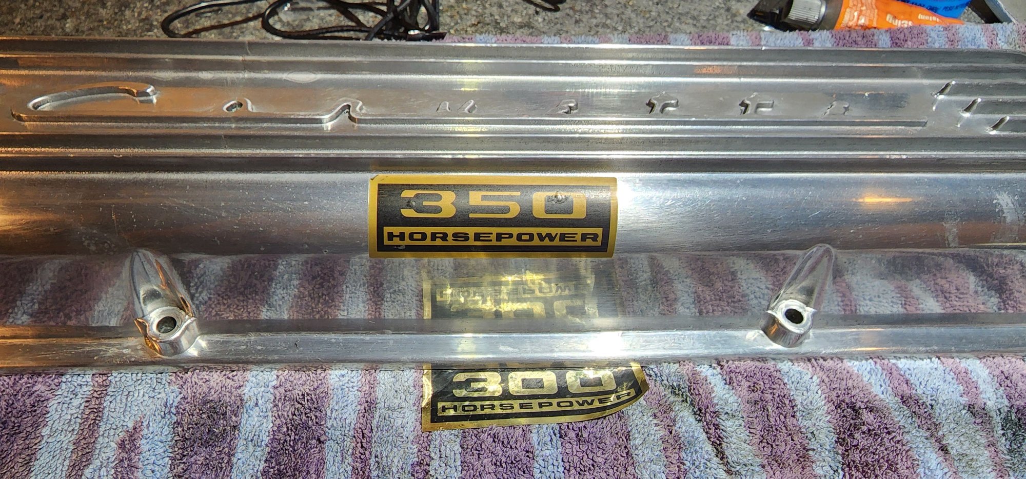

@GUSTO14 So I figured I'd cleanup and reseal the covers since I had one of them off... and I find this. Doubt it means much but funny nonetheless. - Randy.

Another point on original Valve covers. They were not polished in any way. They do look nice that way but will decrease the value to someone seeking originality.
